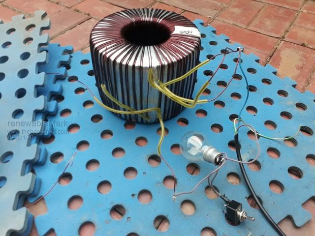

Here is the test rig I made up from Oz's instructions.
Madness had a great suggestion to leave an extra metre of copper on the end, just in case the counts were wrong and you would easily wind on another turn.
The test is to connect the start ends together and place a nuetral wire on that.
I cut up an old power lead from something, on the active line I soldered on an old style filament globe as a soft start, the switch is to short out the globe, effectively eliminating it from the circuit.
Basically as per reply 3 on here
After I did the test and it all worked out well, just to be sure I wound on another turn,(with that extra metre of wire) and as expected the voltage rose around 2v, so that double confirmed my turn count was correct.
I have three windings on now and one more to do.
I thought I only had to do three windings and got a bit sloppy with the spacing on the last wind, so there ended up having a gap of about 1.5cm between the start and finish ends, shouldn't matter too much.Edited by renewableMark 2018-01-31

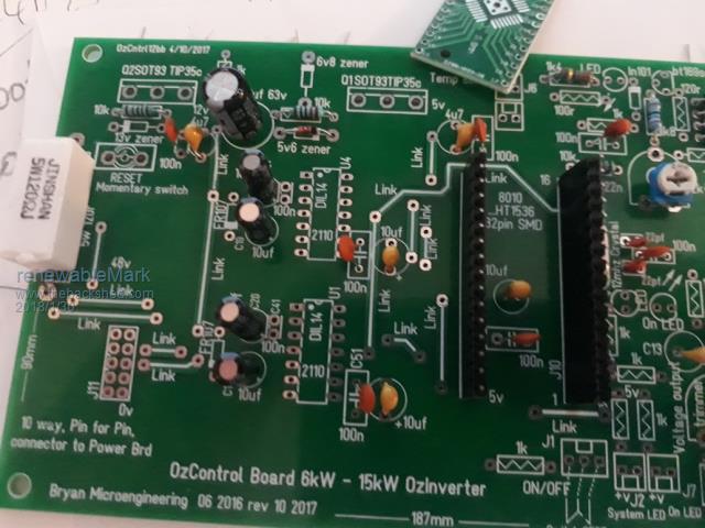

Started to put some bits on the board, haven't soldered anything yet.
Where it shows a link, what gauge wire should I use there?
Cheers Caveman Mark

Posted: 09:21am 30 Jan 2018

OK so just a small wire for the links yeah?
Cheers Caveman Mark
Off grid eastern Melb
Posted: 09:50am 30 Jan 2018
  renewableMark said   OK so just a small wire for the links yeah?
Yes, just a small piece of tinned copper wire looks pretty neat.

Don't worry about that gap, mine has a much bigger gap and it still works well. You certainly do *not* want the beginning and end turn touching unless you slide extra insulation over it if it can't be helped.
You won't regret doing 4 in hand, mine was wound 4 x 1.8mm wire and runs very cool despite having only 100 turns - I wish I had done more - back then the importance of that was not being discussed so well so you benefit now.
Don't be stingy with your primary wire either. You should use 9x4 of the same wires as the secondary, twisted together, if you use recycled wire.
In case you are wondering; turns ratio = 9:1, total wire cross section is also.

Klaus it quite right, your secondary will be four 2mm squared wires = 8mm squared total secondary copper area.
The ratio will end up somewhere around 9:1 so the primary ideally should be 72 mm squared total copper area, or close to it if that can be done.
Quite a few different ways to approach that, depending on how much of the hole you have remaining, and what you have available to use.
Its going to be pretty big, around 14 or 15 turns of 10mm diameter bare copper, if its going to be a single round wire. And any insulation around the wire will add to that diameter.

Mark I think you will find the links marked on that PCB are actually already connected if Clockman has had them made as double-sided. Put your meter on it and check for connectivity.
I have to agree with Tinker it is worth putting the extra wire on particularly if you plan to make the Inverter earn it's keep. What do you plan to use for the Primary? 70 mm square fitted for me with gaps but I have 11 turns, you will need 14 turns if I am correct. When you get the 4th wire on wrap 14 turns of any old insulated wire and check the voltage, you need to 26-27volts. Add or subtract turns till you get that result. You can then do some measuring and see how thick you can make the primary. Welding wire with the outer layer stripped off is very supple and will squeeze quite a bit. Although I would use recycled copper that you stripped off if possible, but you might like to spend another $100 plus on the welding wire.
When you start winding the primary you need to get the wire hugging the inside of the core, if it sits out a bit it fills up the circumference of the hole very quickly. I found tyre levers very useful to get things into shape at that stage.
