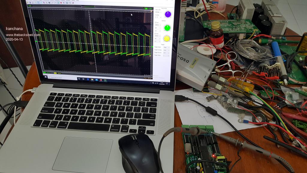

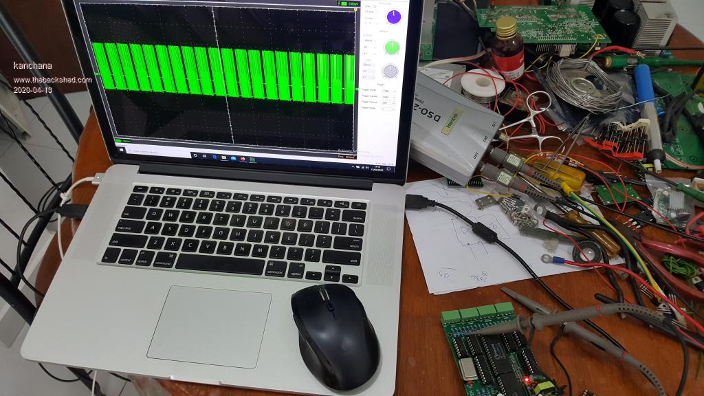

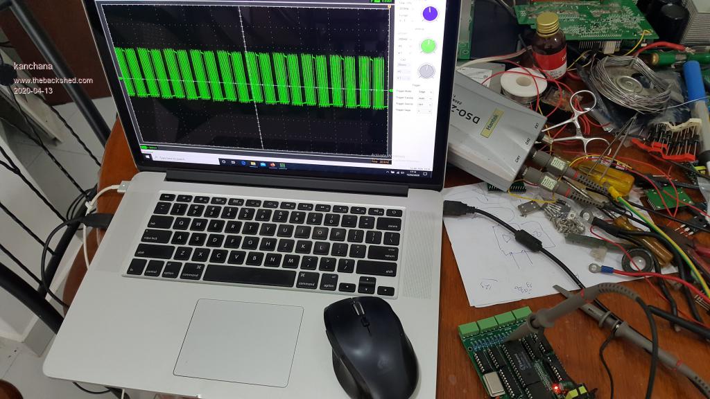

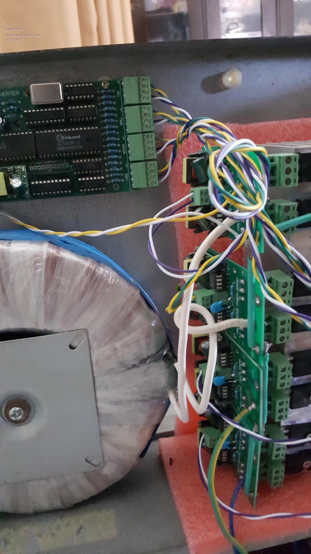

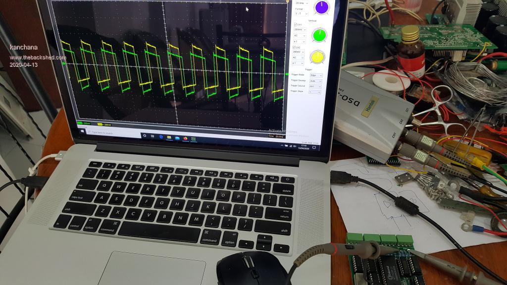

Initially I had a shot on controller board that little power module led was blinking , I had fitted osilator wrong way , fitted a new osilator and then only connected to a battery bank then this happeded  . Now fitted the osilator with out the socket . controller out put seem fine? what is the suitable next ? can i check one tranformer at a time?
large  1st and 4th output pins
large  1st and 3rd output pins
large 1st and 2nd pins
 medium 1st pin
small 1st pin
tiny 1st pin
Regards kanchana

Check the signals of pin 1 & 2 then 3 & 4.
So in your case green/yellow then test purple/white.
The wave forms for each torroid are different.
Half way down on this page shows the signals to expect
Cheers Caveman Mark

Its difficult to see much detail in your waveforms, but they are all there, and all appear to be switching cleanly, so there is no obvious problem that I can see there.
Make sure your oscillator is working and on the right frequency (3.2768 Mhz) and I think your problems may be gone.

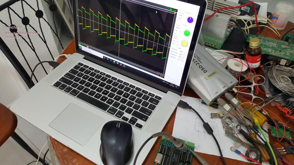

Thanks Guys , Something is not right it. I am out so will post waveforms when I get back. However last night I wanted make sure before any blow ups so I disconnected the large transformer primary and added 10k resister and measureed the waveform I got 50hz single square wave with out any step as I should. So there should me some error some where  ?
Regards kanchana
Posted: 04:47am 14 Apr 2020
All you should see across the largest transformer is a 50Hz square wave with three voltage levels, so that sounds fine.

Posted: 04:51am 14 Apr 2020
Tony I am only getting 2 levels middle level is not there .Will post later
Regards kanchana
Posted: 05:39am 14 Apr 2020
Your first two driver waveforms look o/k.
Must have either one faulty gate drive chip, or one open circuit mosfet.
As mosfets usually fail shorted not open circuit, my bet is you have either a faulty gate driver chip, or one of the isolated gate driver dc power supplies is not working.
Something is preventing the simultaneous conduction of the two lower mosfets which is what produces the zero volt step. Also check that the series gate resistors are o/k.
Sometimes a blowup can kill a gate driver and open circuit a gate resistor. You may have missed something when a previous blow up was repaired.

Posted: 06:52am 15 Apr 2020

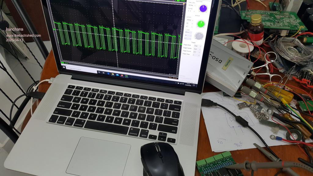

Thanks , I was a disconnected mosfet pin , I manage to fire up all the transformers with a PSU , but the final wave form is not good
Regards kanchana
Posted: 07:38am 15 Apr 2020
Is that just the waveform across the secondary of the largest inverter ?
That cannot possibly be the combined waveform of all four inverters ????
Edited 2020-04-15 17:42 by Warpspeed

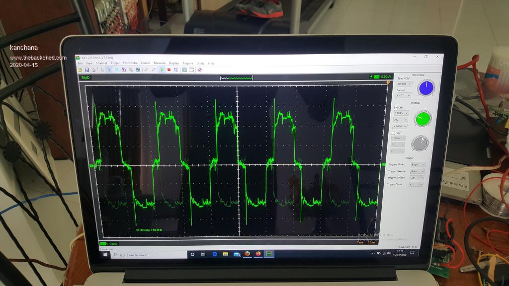

Posted: 07:57am 15 Apr 2020
This is the combined waveform of the all the inverters with out any filtering . Some thing not right it seems
Regards kanchana
Posted: 08:04am 15 Apr 2020

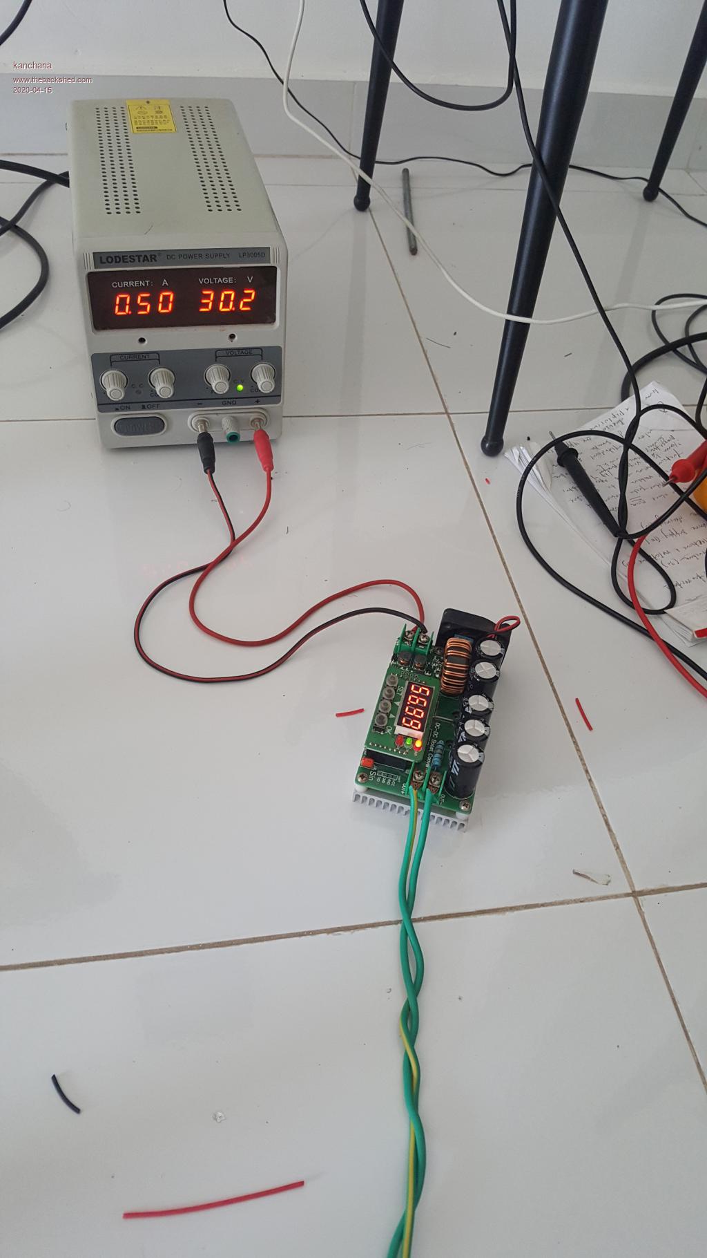

What does the dc supply look like ?
kanchana
Joined: 08/05/2018
Location: Sri Lanka
Posts: 56
Posted: 08:10am 15 Apr 2020
Regards kanchana
