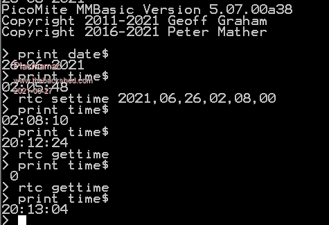

Plasmamac
Joined: 31/01/2019
Posts: 620
Posted: 08:27pm 26 Jun 2021
print time$ Error after not touching teraterm for > 10 h to test the rtc.
> option list
OPTION SYSTEM I2C GP20,GP21
OPTION RTC AUTO ENABLED
make some new tests.
Edited 2021-06-27 06:30 by Plasmamac

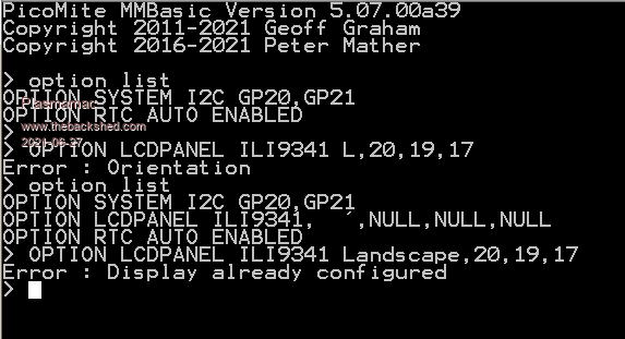

Joined: 31/01/2019
Posts: 620
Posted: 08:41pm 26 Jun 2021
cant setup the lcd after a mistyped (?) configuration without disconnect the usb / reset.
Plasma
Plasmamac
Joined: 31/01/2019
Posts: 620
Posted: 08:50pm 26 Jun 2021
Edited 2021-06-27 06:51 by Plasmamac
Plasma
Posts: 9265
Posted: 08:51pm 26 Jun 2021
@Plasmamac
You should be able to remove the previous lcd setup using
OPTION LCDPANEL DISABLE
then enter a new configuration. You have to do this whenever you make changes to an lcd.
Plasmamac
Joined: 31/01/2019
Posts: 620
Posted: 08:59pm 26 Jun 2021
ok i forget the","
OPTION LCDPANEL ILI9341,L,20,19,17
disable the lcd works also.
finally the lcd works fine , thx for the help
thx
Edited 2021-06-27 07:33 by Plasmamac
Plasma

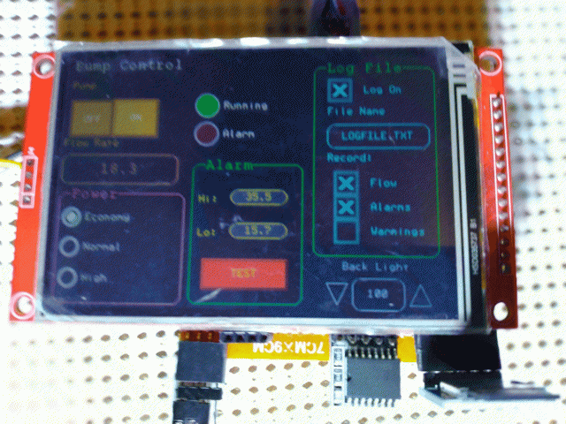

Posts: 3885
Posted: 01:05am 27 Jun 2021
Using the pico which on which I had not been able to complete GUI CALIBRATE for an ILI9341, I plugged in a new ILI9488 and set it up. It took about 10 attempts at GUI CALIBRATE before it succeeded.
Then I ran a guidemo.bas which had been modified for 480x320:
I tried SAVE IMAGE "gui480.bmp", but the file was all white--I guess because of the non-working status of MISO on the ILI9488 (I had snipped off the pin).

CtrlVal(r_norm) = 1 ' start with the "normal" button selected
' the alarm frame with two number boxes and a push button switch
Font f2 : GUI Frame frm_alarm, "Alarm", 172, 142, 137, 172,RGB(green)
Font f1
GUI Caption c_hi, "Hi:", 180, 180, LT, RGB(yellow)
GUI Numberbox nbr_hi, 220,MM.VPos-6,70,MM.FontHeight+6,RGB(yellow),RGB(64,64,64)
GUI Caption c_lo, "Lo:", 180, 222, LT, RGB(yellow),0
GUI Numberbox nbr_lo, 220,MM.VPos-6,70,MM.FontHeight+6,RGB(yellow),RGB(64,64,64)
GUI Button pb_test, "TEST", 187, 260, 105, 37,RGB(yellow), RGB(red)
CtrlVal(nbr_lo) = 15.7 : CtrlVal(nbr_hi) = 35.5
' draw the two LEDs
Const ledsX = 187, coff = 75 ' define their position
ledsY = 65 : GUI LED led_run, "Running", ledsX, ledsY, 15, RGB(green)
ledsY = ledsY+37 : GUI LED led_alarm, "Alarm", ledsX, ledsY, 15, RGB(red)
CtrlVal(led_run) = 1 ' the switch defaults to on so set the LED on
' the logging frame with check boxes and a text box
Colour RGB(cyan), 0
Font f2
'GUI Frame frm_log, "Log File", 210, 10, 110, 158, RGB(green),0
GUI Frame frm_log, "Log File", 323, 15, 150, 240, RGB(green)
Font f1
GUI Checkbox cb_enabled, "Log On", 340, 30, 30, RGB(cyan)
GUI Caption c_fname, "File Name", 340, 67
GUI Textbox tb_fname, 340, 90, 125, 30, RGB(cyan), RGB(64,64,64)
GUI Caption c_log, "Record:", 340, 127, , RGB(cyan), 0
GUI Checkbox cb_flow, "Flow", 348, 150, 30
GUI Checkbox cb_alarm, "Alarms", 348, 180, 30
GUI Checkbox cb_warn, "Warnings", 348, 210, 30
CtrlVal(cb_enabled) = 1
CtrlVal(tb_fname) = "LOGFILE.TXT"
' define and display the spinbox for controlling the backlight
GUI Caption c_bright, "Back Light", 358, 262,,RGB(200,200,255),0
' GUI Spinbox sb_bright, 210, 210, 110, 25,,,10, 10, 100
GUI Spinbox sb_bright, 333, 282, 135, 37,,,10, 10, 100
CtrlVal(sb_bright) = 100
' All the controls have been defined and displayed. At this point
' the program could do some real work but because this is just a
' demo there is nothing to do. So it just sits in a loop.
Do : Loop
' the interrupt routine for touch down
' using a select case command it has a different process for each
' control
Sub TouchDown
Select Case Touch(REF) ' find out the control touched
Case cb_enabled ' the enable check box
If CtrlVal(cb_enabled) Then
GUI Restore c_fname, tb_fname, c_log, cb_flow, cb_alarm, cb_warn
Else
GUI Disable c_fname, tb_fname, c_log, cb_flow, cb_alarm, cb_warn
EndIf
Case sb_bright ' the brightness spin box
' BackLight CtrlVal(sb_bright) ' not available on pico
Case sw_pmp ' the pump on/off switch
Print CtrlVal(sw_pmp)
CtrlVal(led_run) = CtrlVal(sw_pmp)
CtrlVal(tb_flow) = Str$(CtrlVal(sw_pmp) * 20.1)
CtrlVal(r_norm) = 1
Case pb_test ' the alarm test button
Open "Test.txt" For Append As #1
Print "File Opened"
Print #1, "Hello World", Time$
Print "Hello World", Time$
Close #1
Print "File Closed"
CtrlVal(led_alarm) = 1
' GUI beep 250 ' on picomite, "Error: CLick option not set
Case r_econ ' the economy radio button
CtrlVal(tb_flow) = Str$(CtrlVal(sw_pmp) * 18.3)
Case r_norm ' the normal radio button
Case r_hi ' the high radio button
CtrlVal(tb_flow) = Str$(CtrlVal(sw_pmp) * 23.7)
End Select
End Sub
' interrupt routine when the touch is removed
Sub TouchUp
Select Case Touch(LASTREF) ' use the last reference
Case pb_test ' was it the test button
CtrlVal(led_alarm) = 0 ' turn off the LED
End Select
End Sub
