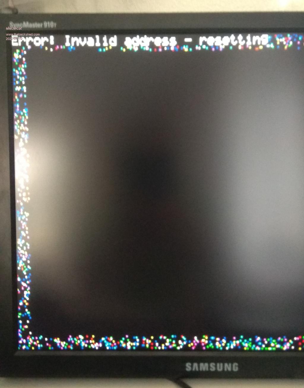

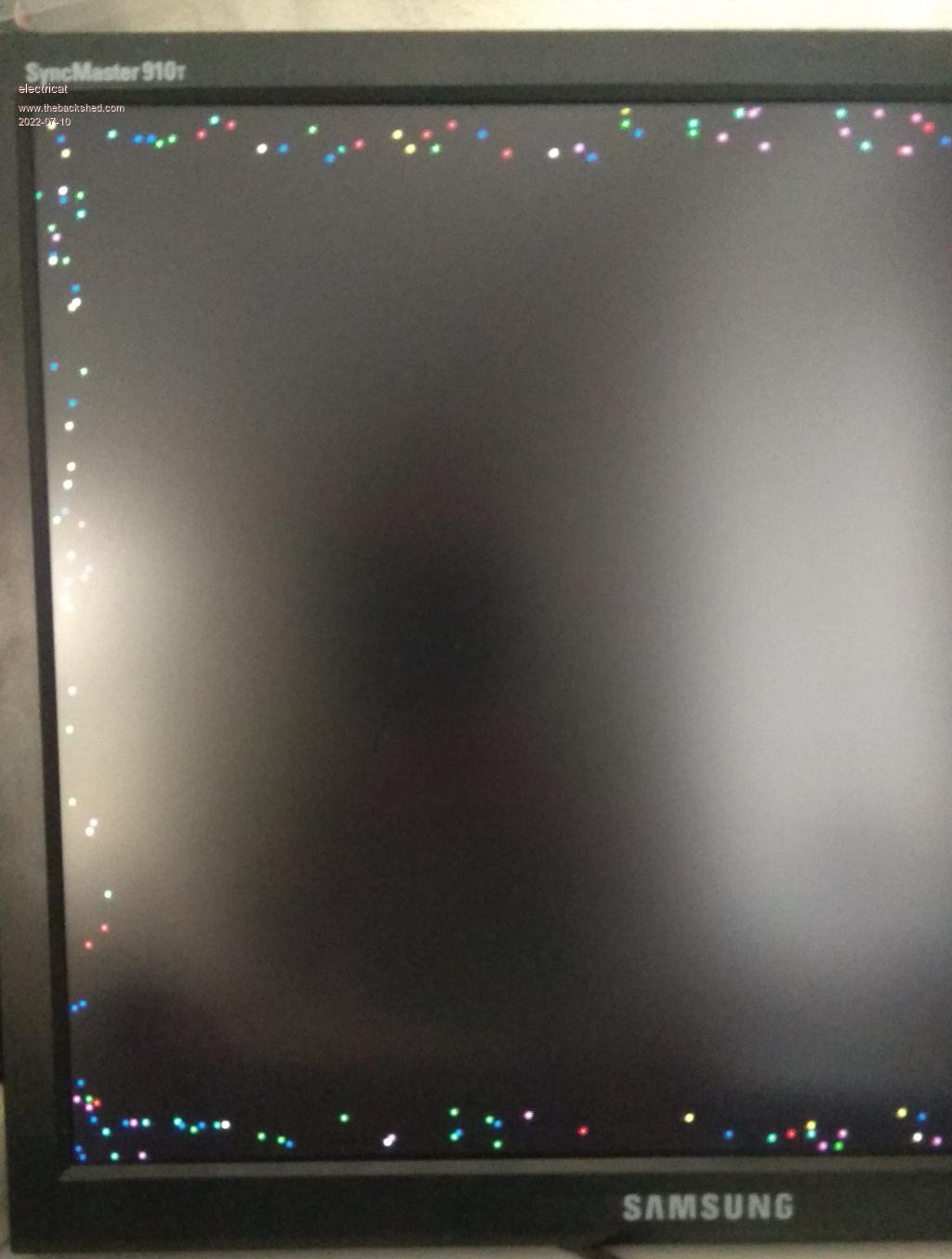

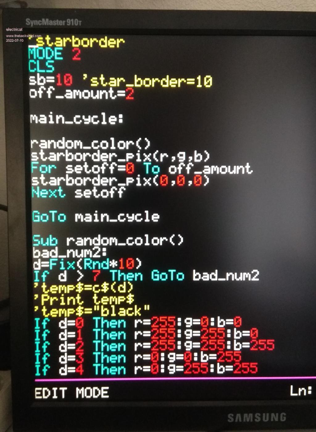

It`s not about PicomiteVGA beta, but about 5.07.04 from Geof`s official.

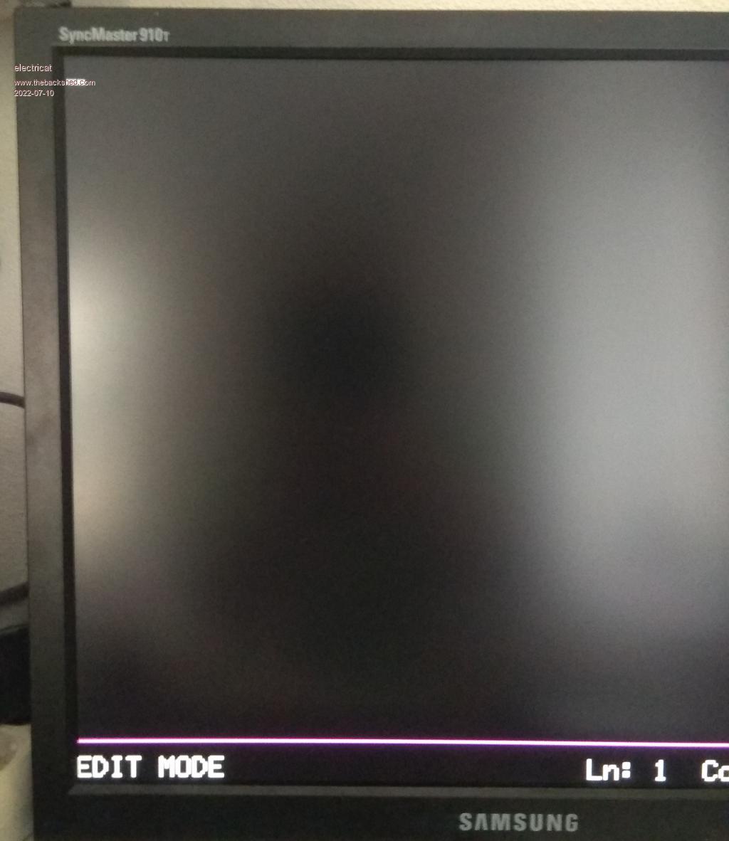

I was writing small program and saved it and powered off/on PicomiteVGA and everything went as expected. And while tinkering around I noticed once empty edit screen :) As it was no any program.
OK. I loaded some pre-save from flash slot n and continued on. And then it happened again.
OK. I started looking more carefully whats the heck is going on and this is what I found.
I was powering PicomiteVGA via monitors (NEC P242W) USB.
Monitor was set to sleep after 10 mins, so all goes OK until it is going to sleep and if it is in sleep mode, still everything goes well.
If I wake up monitor from sleep state, PicomiteVGA works some few seconds, then error rises "Error: Invalid adress - resetting". PicomiteVGA resets and boom! Nothing to edit. Still flash slots stores all pre-saved program versions.
I just switched to normal power supply, and no problem so far.
Still it seems to me this case might be interesting for you :)
Few pictures how it goes, and I have no idea, how it might erase main, coz if I would   kill off power from regular power supply - no problems :).
Editing program

Waked up, and thing is reseting
After reboot

Posts: 3413
Posted: 09:39pm 09 Jul 2022
You could also try a USB charging cable that only has the power wires and no data wires.
It might be that when the monitor wakes up it interrogates the USB port with commands that confuse the Pico.

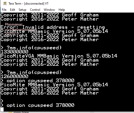

is cpuclock 378 working yor you ?
ive testet several picos including a new picow.
most time the pico will not come back and a reconnect will not help.
is there a difference with in vga and normal ?
is a step up to 378  possible or got you timimg problems with ?
thx

Posted: 07:48am 10 Jul 2022
Well , OK.
Comes out I had problems with drivers (WIN7).
Used zadig, and installed USB serial (CDC) and no more problems I described earlier.

i test several pico ( 8 and a pico w) with the
option cpuspeed 378000 .
only 1 come back but close the port after a few seconds.
i get internal error , invalid adress or nothing.
have anyone the same problems or is it me ?
Plasma
Posts: 12040
Posted: 06:23pm 10 Jul 2022
Works on every Pico I've tried including a pico_w. Check your power supply?
Of course it is way out of the chip's spec so no guarantees

Joined: 31/01/2019
Posts: 620
Posted: 09:12pm 10 Jul 2022
thx Matherp . My front usb port sux , ports direct from the motherboard is working.
all Picomite works with 378 . thx again
