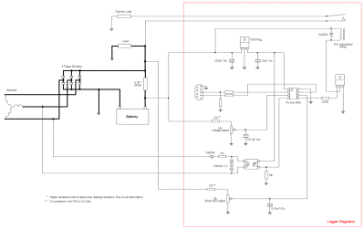

1. Logger - Regulator. Measures
Volts, Amps and Windmill RPM or Wind Speed. The
last PicAxe pin is used to switch the dump load.
2. Logger Only. Measures Volts,
Amps, Windmill RPM and Wind Speed.

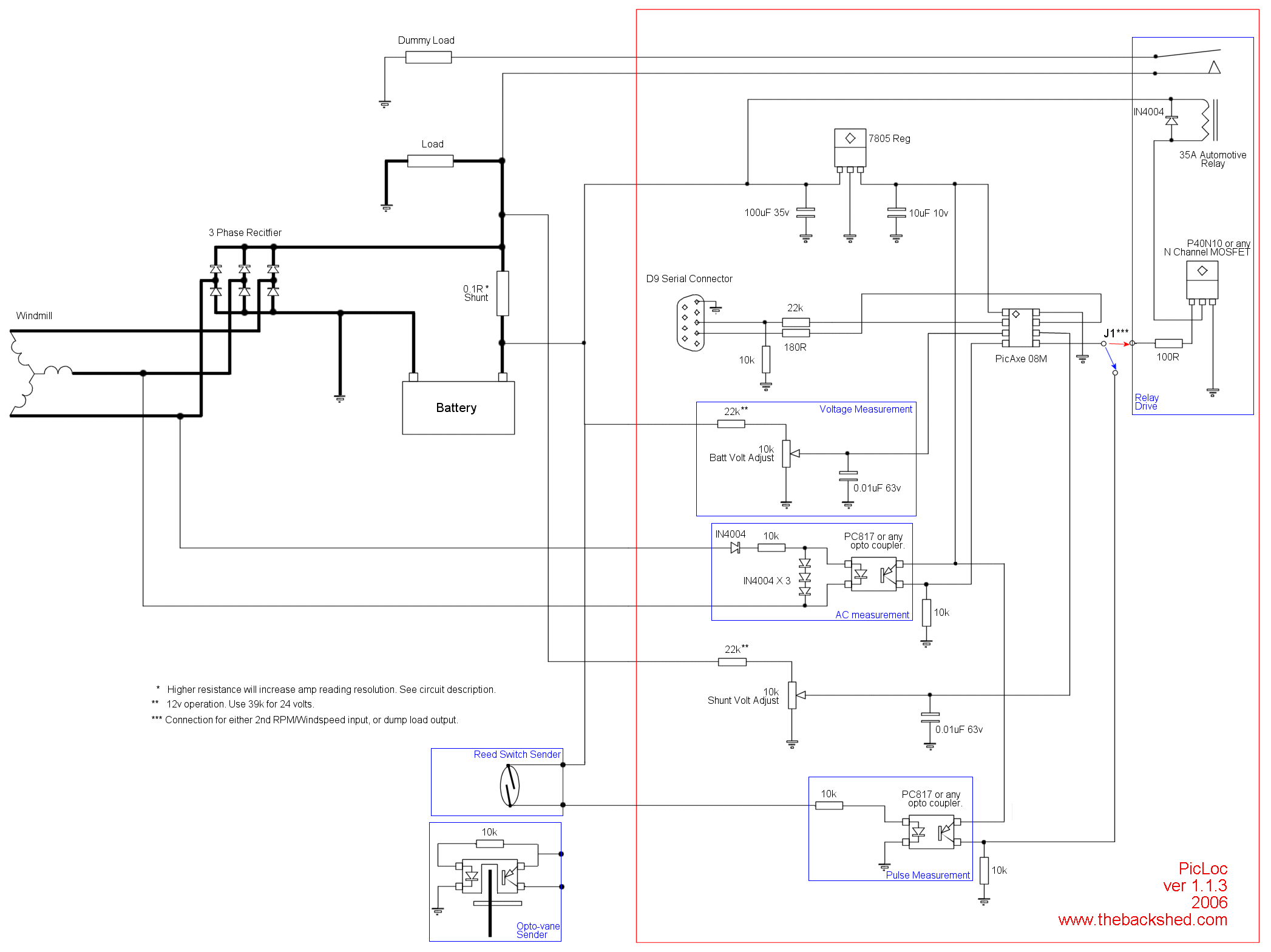

| I'm using two of the ADC inputs of the
08M chips to measure battery voltage (pin 3) and shunt
voltage (pin 6). The PC software calculates battery
current by comparing the difference in battery and shunt
voltage, ie if the battery is 12 volts, and the shunt
measures 12.2 volts with respect to the battery -ve,
and the shunt is 0.1 ohms, we can work out amps using
12.2v - 12v = 0.2v, so 0.2v / 0.1ohm = 2amps. The PC
software actually uses a different method to work out
amps, but you can get the idea. The 0.01uF caps filter out
any spikes. Originally the circuit also included a 4.7v zener to protect against excess voltage, but this was found to be affecting the accuracy of the readings, so was removed. |
| Windmill RPM is measured
by sniffing the AC directly from the windmill, before
it passes through the bridge rectifier. The PicAxe can
count pulses per second, so we use this to work out
RPM. There is a opto coupler there to isolate the AC
from the battery side of the bridge rectifier, and provide
some protection for the 08M input (pin 4). |

Dump Load. If the battery
voltage is too high, a mosfet ( from pin
5 ) drives a automotive relay to switch a dummy load
( couple of 12v spotlights would do ) across the battery
to drain off the excess power.
The circuit can run on either 12v or
24v, but there are a couple of resistors that need to
be changed. If you wanted to quickly change from 12
or 24 volt, a double pole switch could be used to change
the resistor values. To keep it simple, I'll use 12v
for the rest of the controller description.

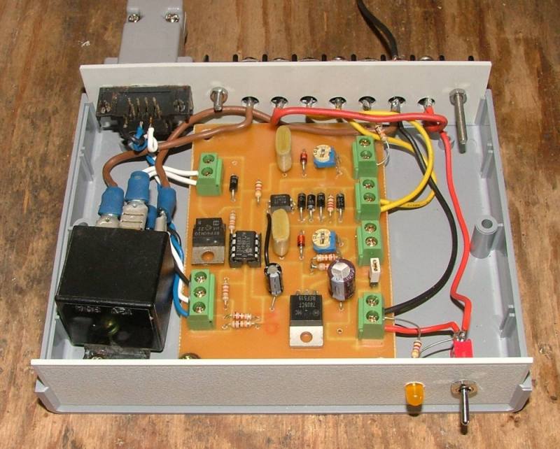

I machined my circuit board
on my cnc router, but its a fairly simple circuit and
you could use veroboard. If you have a cnc router drop
me a email and I'll send back the dxf file.

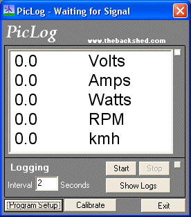

PC Software.
Just a note about the PicLogs software. As well as a useful data logger, the Piclog is here as a teaching tool in electronics and software. The software developed for the Piclog is open source, meaning everyone can see the code in its raw format, learn how it works and use parts of it for their own projects. You may use parts of the PicLog software for your own projects and distribute them as your own creations, providing you dont call it a PicLog or similar ( PicLog2 for example ). If you have a "improved" or "modified" version of the PicLog, you should include the source code with your new program. Remember the PicLog is here as a teaching tool, so any version of the PicLog must include full source code so others can continue to learn from the PicLog.
Written in vb6, the windows application
does all the number crunching and logging. There are
4 screens, Main display, Setup, Calibration, and Logs.
The main display shows the current Battery
voltage, Current, Watts, RPM and/or Wind Speed. This
is updated on every heart beat from the PicAxe, every
2 to 3 seconds. Typically the data from the PicAxe would
look like...
[<V>520</V><I>540</I><R>12</R><S>23</S><M>0<M>]
V is Battery Volts, A is Shunt Volts,
R is pulses per second, S is Wind Speed pulses per second,
M is mode ( dummy load on or off )
The program breaks this info up into
its individual values, then uses its calibration settings
to get our true battery voltage, Battery current, Watts,
RPM, WindSpeed and Mode. This info is displayed on the
screen.

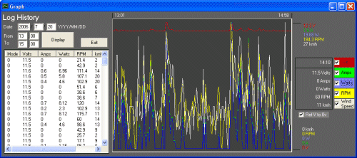

If you click the Start button in the
logging section, the program will start recording the
values into a text file. A new text file is started
for every day. The interval is set to 60 seconds be
default, but this can be changed from 10 seconds to
600 seconds ( 10 minutes ).
The Program Setup screen
is used to set some general program settings, and saves
the information to a text file called prog.cfg.
- Com Port: Set to the com port on
your PC that the PicAxe serial cable is plugged into.
- Save HTML Page: Updates a web page
every few seconds with the loggger data, more on this
later.
- Save Excel File: Creates an Excel
file, one for every day, with the log history.
- Default Logging Interval: Pretty
obvious.
- Start Logger Automatically: Logging
starts on program start.
- Display RPM: Turn on RPM display.
- Display Wind Speed: Turn on Wind
Speed display.
- Wind Speed Units: What measurement
base for wind speed ( ms, knots, etc )

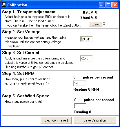

The Calibration screen is used to set
up the software. Just follow the steps. Its saves the
configuration as a text file called settings.cfg. Dont
be tempted to edit this file, if there is a problem
with it the program will crash.
The Show Logs screen displays logs,
and includes graphs. Just enter in a date and hit Display.
You can then narrow down the time spread using the From
and To time values. The graphs are scaled to the max
and min values. If you move your mouse over the graphs,
it will display the value and time, depending on where
your mouse pointer is. You can also turn off and on
individual traces.
