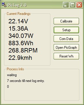

Main window

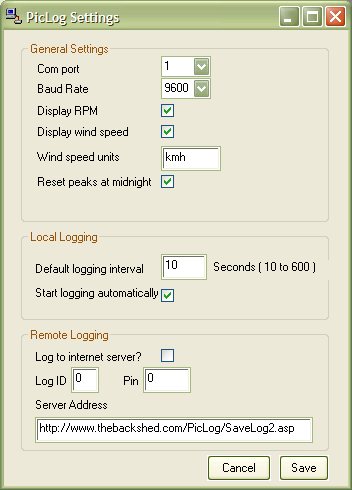

Setup window

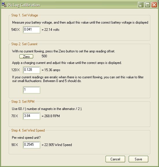

Calibrate window

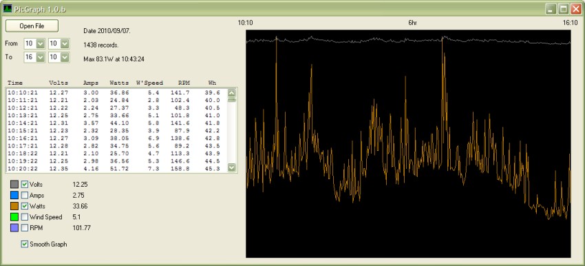

PicGraph 1.0.b screen.
PicGraph is in early development at time of writing, I wanted to get the new PicLog out as soon as possible and haven't had time to give PicGraph any more than the most basic of features.
I will continue to develop PicGraph over the next few weeks.
