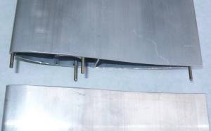

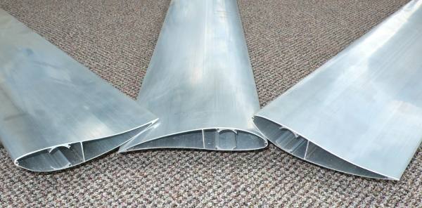

The GE-222 blade profile has been used by wind turbine builder Windcharger for many years. Its a proven performer with good all round performance. The GE-222 profile is now available for the aftermarket wind turbine industry. The blades are available in Wood, PVC and now Aluminium.
![](AlBlades/P1030607.jpg)

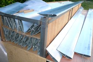

Aluminium blades have many advantages over other blade materials, including...
- Improved strength and rigidity.
- Better sheer strength at mounting points.
- Not UV affected, long life compared to PVC or wood.
- Easier and cheaper to paint , could be used unpainted with leading edge tape.
- More uniform airfoil.
- Can be joined by using aligning dowels in the C channels to position until secured with rivets, allowing longer blades to be put together with the 1 meter maximum postage limit, potage is cheap compared to other freight methods.
- End caps are held with 4 small screws.
- By using small rod in the C channel in the ends allows easy balancing.

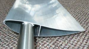

Like the PVC Blades, the Aluminium blades need a internal steel spar to mount and strengthen the blade. We recommend the 25-75 rule. This mean the steel tube needs to be at least 75% of the blade length, starting from the inner ( turbine center ) part of the blade, and the first 25% needs to be solid steel. See the Mounting Extruded Blades link below.
