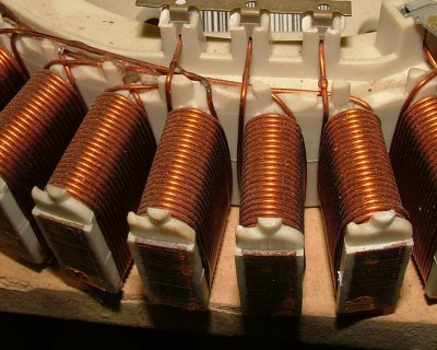

The 100 series, becoming rare,
used in the early model F&P Smartdrive washing machines.
Wire size approx 1mm diameter, 42 Poles.
![](images/100.jpg)

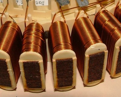

This is the very common 80 series.
Wire size approx 0.8mm diameter, 42 Poles.

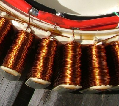

And this is the 60 series, note
the messy winding, but this has no effect on performance.
This stator has been de-cogged, note the rounded ends of the
poles. Wire size approx 0.6mm diameter, 42 Poles.

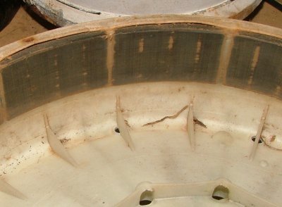

F&P later introduced the
wider magnets, actually four magnets in one magnet block.
I believe this was done to reduce the whining noise when the
washing machine was in spin cycle. There are 14 magnet blocks,
giving us a total of 56 magnets. You can see the area where
the N and S poles meet by traces of rusty iron filings.

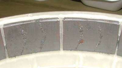

Below is
th latest hub, and suits the 36 pole stator shown above. It
has shorter magnet blocks, each with 3 magnets. All up there
are 16 magnet blocks, giving us 48 magnets. The magnets are
also arrow shaped to reduce cogging. We have used this new
hub on on the older 42 pole stators with very good results,
more info here.
Below you can see the arrow shaped
magnets with some iron filings on the magnet faces.
![](images/ArrowMagnets.jpg)
