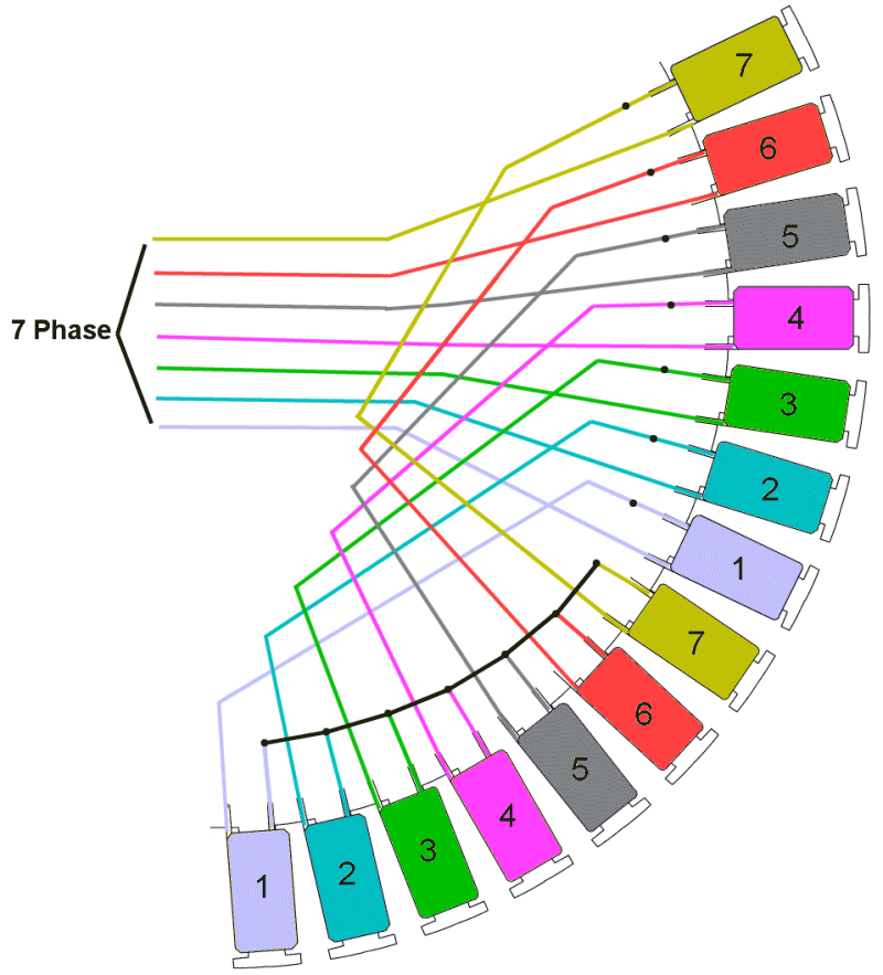

We can use out standard re-wire naming scheme as explained on the F&P Stator Rewiring page, and just add "7Phase" to make it clear its a 7 phase conversion.
So...

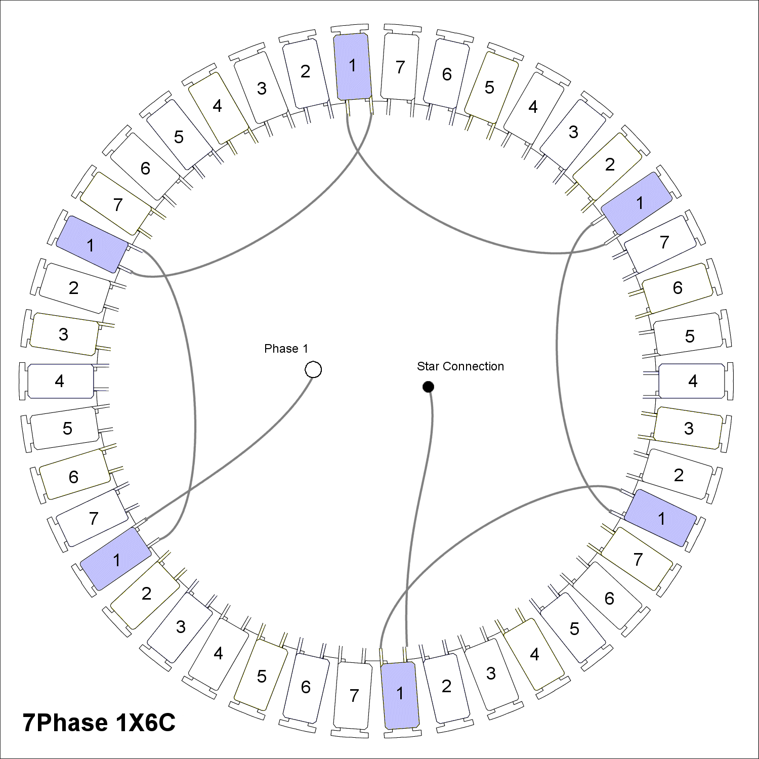

7Phase 1X6C = 6 coils wired in series. Max volts, good for
48 volts systems or 12 / 24 volts on a slow running turbine.

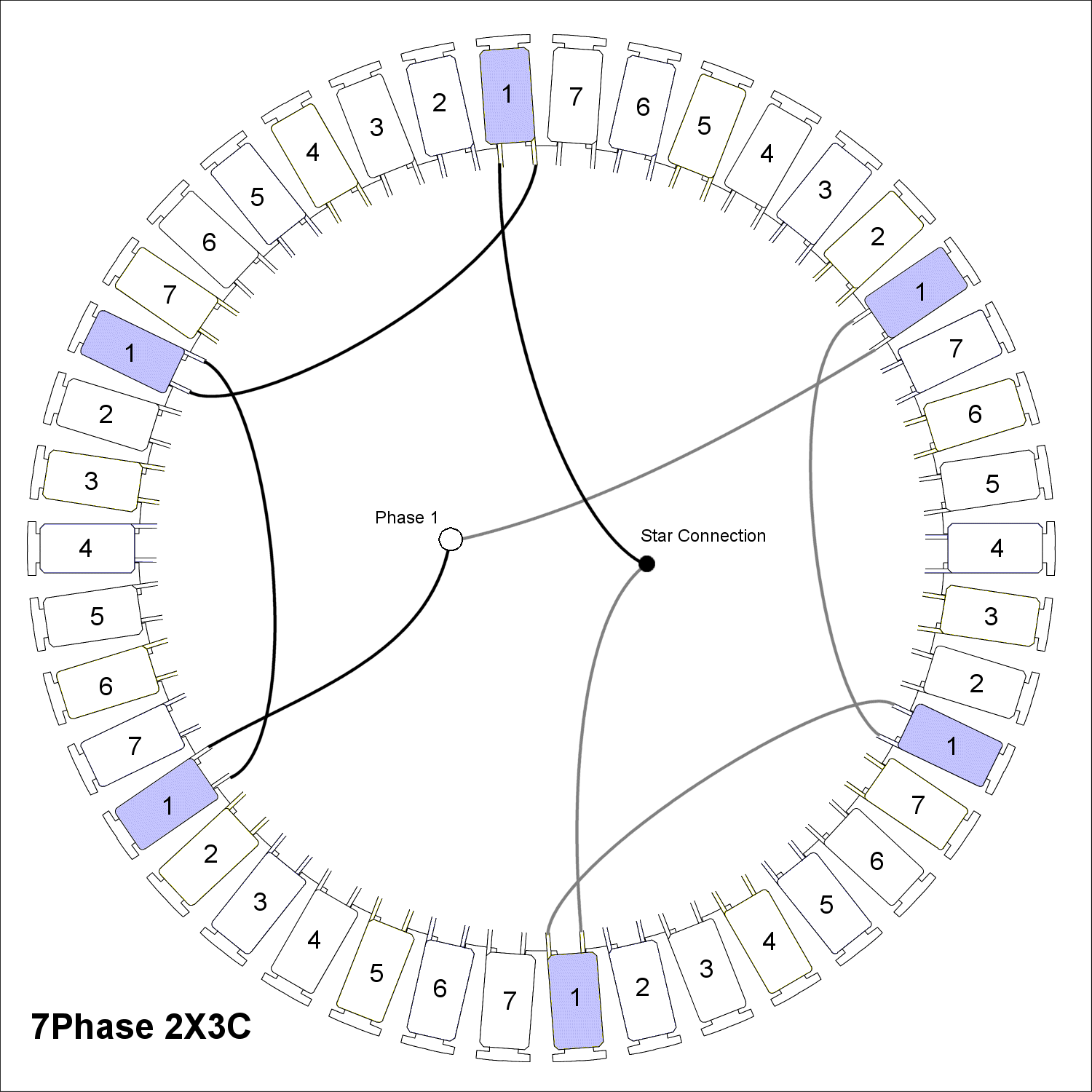

7Phase 2X3C = 2 lots of 3 coils. Less volts more current
than above. 24v systems

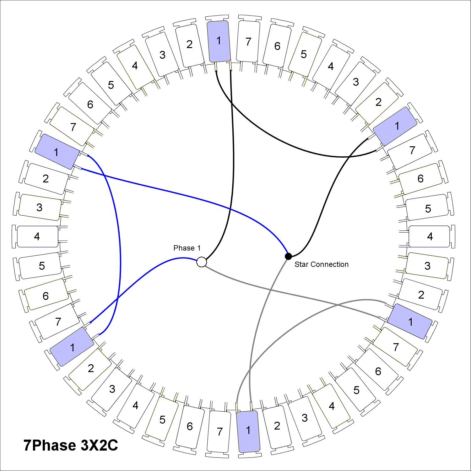

7Phase 3X2C = 3 lots of 2 coils. 12v systems.

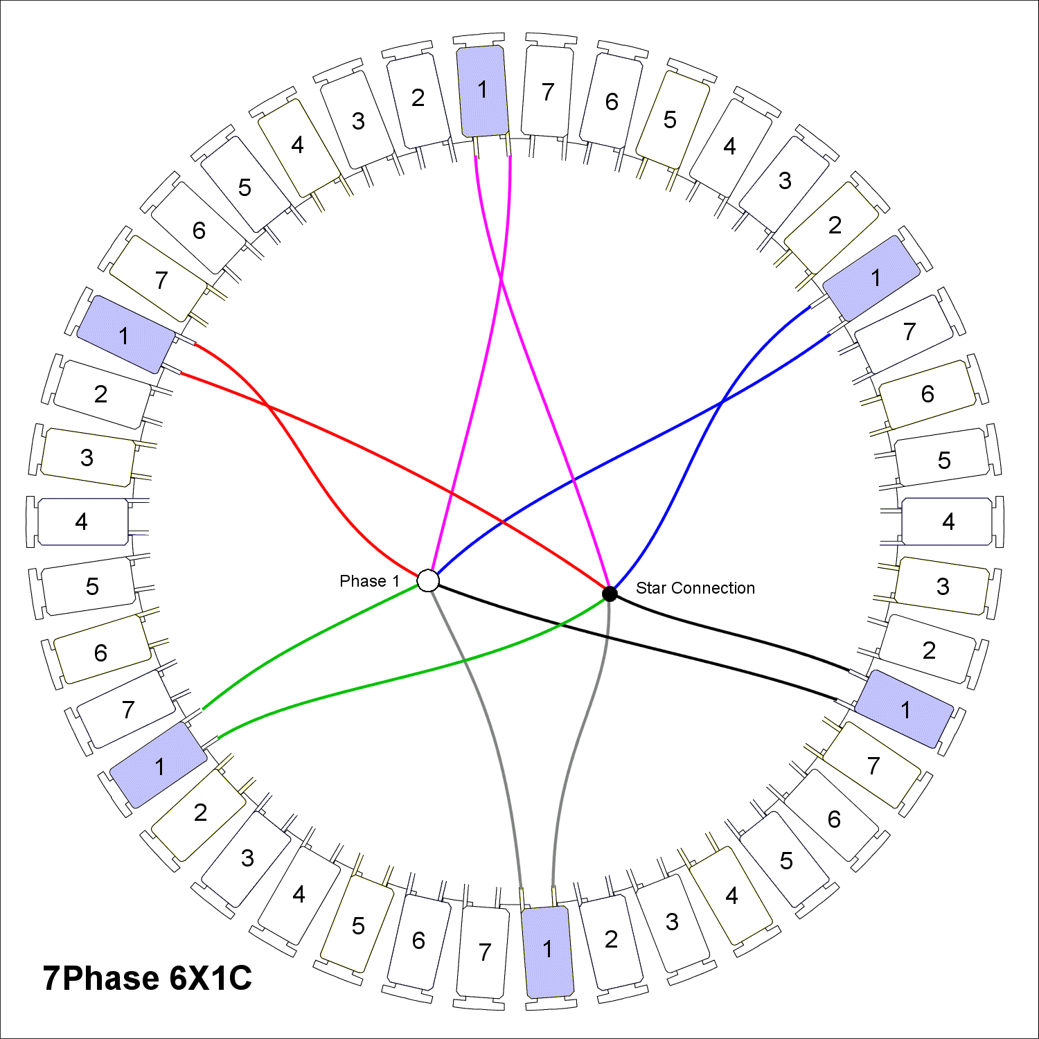

7Phase 6X1C = 6 lots of 1 coil, all wired in parallel. Max
current, suits a fast windmill. 12v systems
Click on the drawings below to see full
size. For simplicity each drawing only shows one phase,
so you just need to do the same connection for the other
6 phases. The Star connection is a common connection
to all phases.
![](../images/FPCogless/7Phase1X6C-thumb.gif)
7Phase 1X6C |
![](../images/FPCogless/7Phase2X3C-thumb.gif)
7Phase 2X3C |
![](../images/FPCogless/7Phase3X2C-thumb.gif)
7Phase 3X2C |
![](../images/FPCogless/7Phase6X1C-thumb.gif)
7Phase 6X1C |

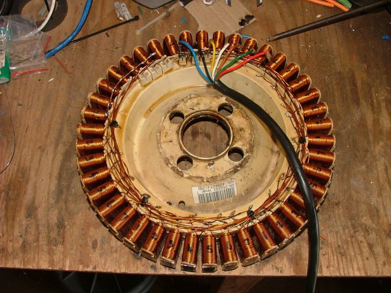

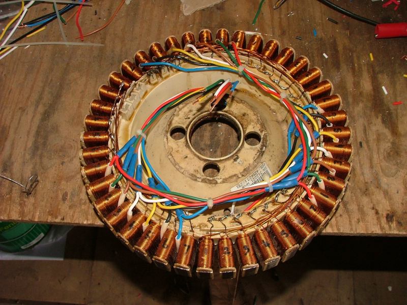

![](../images/FPCogless/Dscf1078s.jpg)
This hub is wired as 7Phase 1X6C |
![](../images/FPCogless/Dscf1080s.jpg)
And this is a 7Phase 3X2C |
![](../images/FPCogless/7p2p-fulls.gif) |
The
drawing to the left may make it clearer. Its how
I wired my 7Phase 3X2C above, which I used on my faster
spinning HAWT. To convert your stator, you need
to cut the wires for each coil/pole. I found if
I unwind the outer coil one turn, it was then long
enough to reach the next coil, 7 poles further around
the stator. |

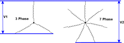

You may wonder what the difference in
7 phase power is compared to 3 phase. 7 phase has a
slightly higher output voltage peak, and less ripple
after rectification. The drawings below may help. V1
is less than V2

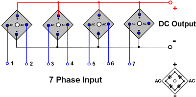

Rectification. I threw
together a 7 phase bridge rectifier using 4 cheap 35amp
bridge rectifiers from Dick Smith, like this...
![](../images/FPCogless/7phaserects.gif)
Special thanks to Bruce. |
