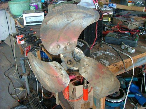

I removed a fan from one of the floor fans, and was happy to discover it matched the shaft diameter of the 300watt motor perfectly. One less job for the lathe. The motor and fan were mounted on the corner of my bench with a couple of clamps and a 12v battery connected up. Whoosh! Heaps of air flow, I think maybe more than it moved when it had the 240v motor. It was drawing 4.2 amps at 12 volts, which is only 50 watts. That's good, it means the motor isn't working too hard, and wont overheat or wear out too quickly.
