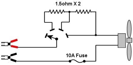

The fan has a 4 position switch, for Off, and speeds 1, 2, and 3. I wanted the same 3 speeds for the 12v conversion. There are several ways to control a DC motors speed, and I decided to use one of the simplest, series resistors.
I used a couple of car ballast resistors. Each resistor has a resistance of 1.5 ohms and can handle 50 watts. The circuit below shows how I connected them up. The result was spot on, the slowest speed was a gentle breeze, next up was about half full speed, and full speed was pretty strong!
![](12vFloorFan/FloorFanCircuit.gif)

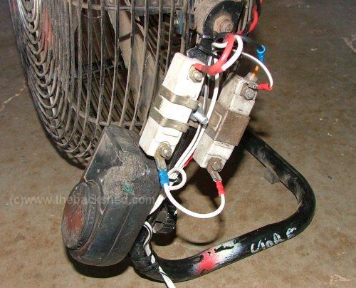

Here you can see where I mounted the resistors. 12v is a safe voltage so I don't need to cover the connecters, but I will add a cover in the future to protect the resistors againsts bumps and knocks.
![](12vFloorFan/Dscf2279.jpg)

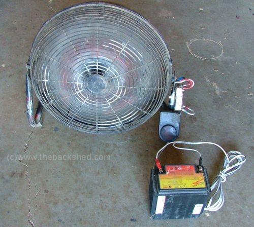

The finished fan up and running. I'm very happy with this project, it was a easy build with good results. I can also use the fan as a dump load.
![](12vFloorFan/Dscf2282.jpg)
