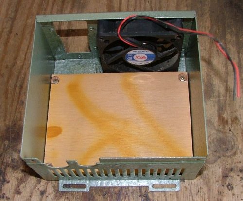

For the housing I used an old dead PC power supply. The circuit board, fan and power connectors were removed, and I spray painted the rusty old case.
Looking inside. I made a wood floor from some scrap 5mm plywood. I also serviced the fan and re-fitted it, but facing the opposite direction so it blows air into the case instead of sucking the air out. Why? Two reasons. Turbulent air is better at dissipating heat, and as I expect it to get very hot in there, I wanted the fan itself to get the first cool air. If the plastic fan was sucking the hot air out of the case, it would get soft from the heat and possibly distort or seize. |

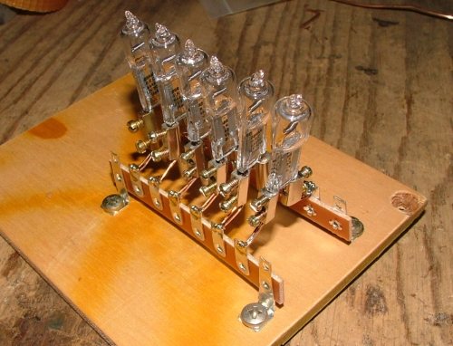

To make a connector for the bulbs, I used terminal strips with the plastic removed. The bulbs get very hot, and will melt plastic.
Each bulb was fitted with short lengths of copper wire, and then all bulbs were soldered onto two tag strips. At about this time I read the instructions on the back of the light bulb packet. It said you need to handle the bulbs with tissue paper and keep them perfectly clean, as any finger marks or dirt will form a hot spot on the glass, causing it to crack and fail.
Uh Oh.
Fact is, with these 6 light bulbs side by side, there is over 300 watts in a tiny space, a lot of heat. The fan will be blowing dusty air over them, and I cant guarantee I wont get cockroach poo on them. They will fail. |
