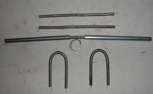

To make the resistors more compact to fit the resistors were bent around a piece of 30mm tube to form a horse shoe. To aid in the bending two short bits of ½” tube were slide over the resistors and then hand bent around the 30mm tube held in the vice.
A mount is made by punching holes through a piece of sheet metal and inserting the resistors into the holes. The resistors was then silver soldered into place.
I think the outer casing of the elements is a form of stainless steel and silver solders very easy if clean. There is no risk of damaging the resistor with heat, if heat is only applied to the outside casing. (they do glow red in your oven)

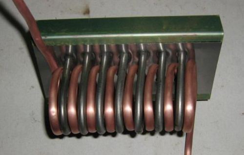

After having worked out the basic procedure for fabricating resistors and seeing the amount of energy emitted as heat, I pondered how it could be best put to use. ( as everyone else undoubtedly has done). The biggest problem was where the load resistors are located on average, is not normally where there is a lot of use for heating. As this is a project in working, the thought of incorporating a heat exchanger for water was adapted. I realize that efficiency is low and most likely no better than 20%, but was done just to show the concept.
