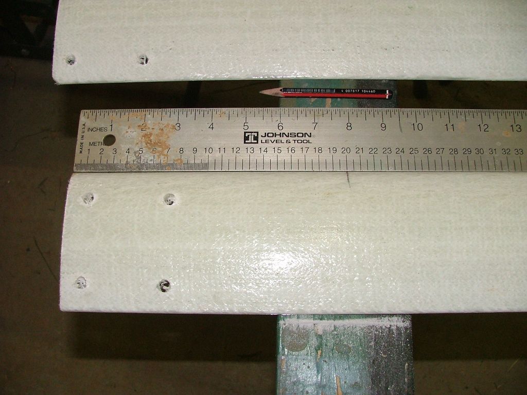

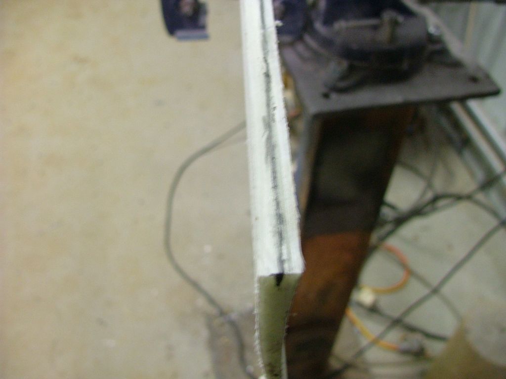

                            | First up, flip the blade over so
                              the back of the blade (lump) is facing up. On the
                              leading edge, measure and mark a line 200mm from
                              the blade root (center most part, where the bolt
                              holes are). |  |
                            | Then at the blade tip, measure
                              and mark 70mm from the trailing edge of the blade.
                              Remember you can click on these photos for a bigger
                              image. |  |
                            | Then using a long rule, draw a
                              line between these two points. This will be our
                              cut line. The wedge shape we have drawn along the
                              leading edge will be cut off. |  |

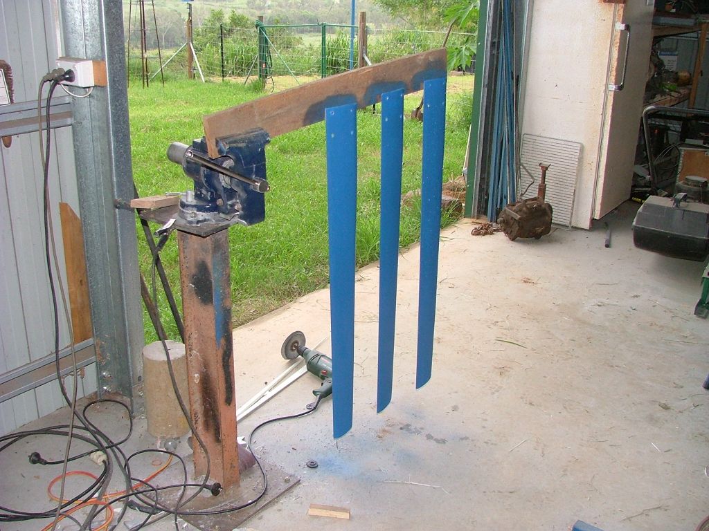

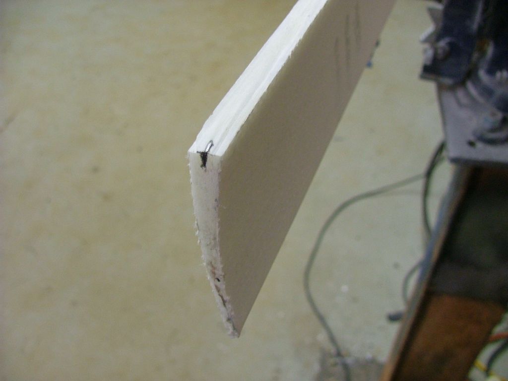

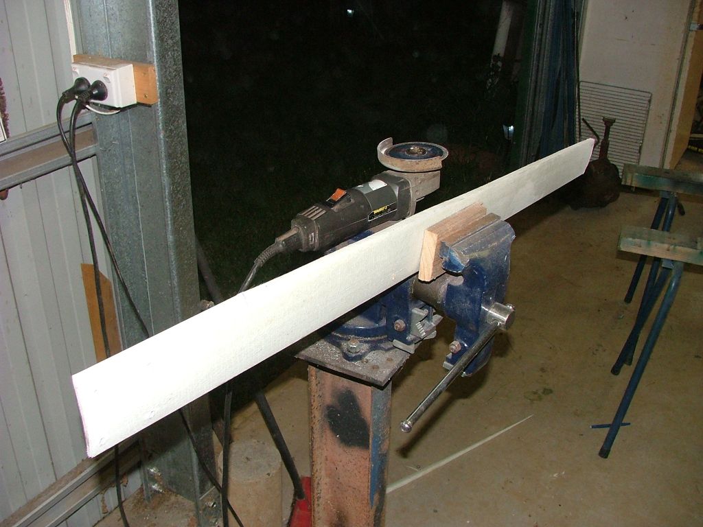

                            | Next grab the blade in a vice
                              with the leading edge facing up. Use blocks of
                              soft wood in the vice so you dont crush and damage
                              the fibreglass. I tried a few different tools
                                  to cut the fibreglass, including hand saw, bench
                                  saw and hack saw, all didn't work very well. In
                                  desperation I grabbed the angle grinder with cut
                                  off wheel and it worked a treat! There is a lot
                                  of smoke given off, so make sure you have lots
                                  of ventilation. I used a pedestal fan to blow
                                  the smoke away from the work piece. |  |

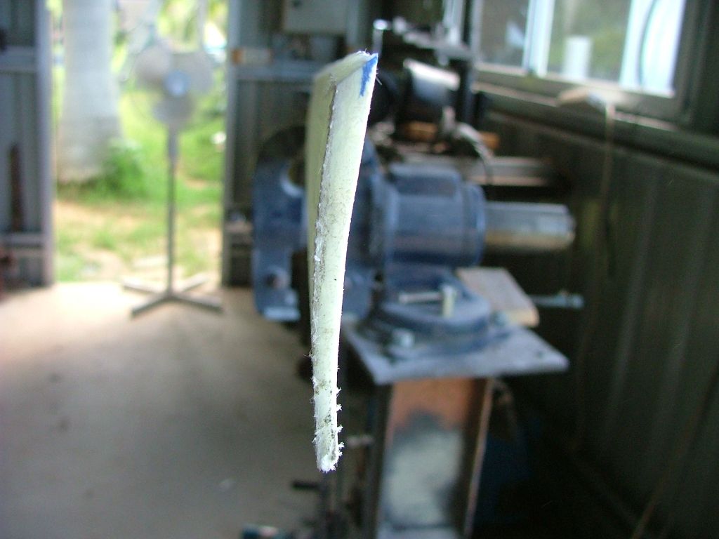

                            | The Angle grinder cut was clean,
                              and it only took about 30 seconds per blade. |  |

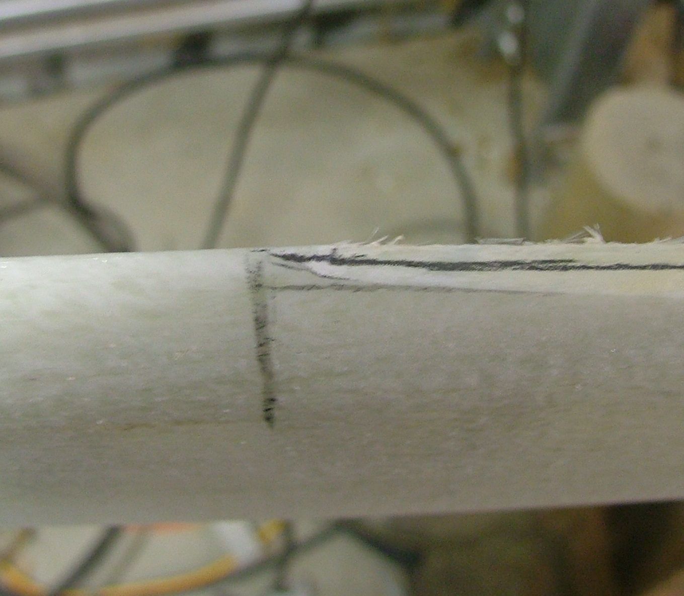

                            | Now we need to mark out the blade
                              for reshaping of the leading edge.  At the blade tip, mark a line
                                  at the middle of the new leading edge. |  |
                            | Then using your rule, draw a line
                              from this mark to the other end of the cut line,
                              where it stops about 200mm from the blade root. |  |
                            | Looking back at the tip, the line
                              wont necessarily travel along the middle of the
                              whole length of the cut, but this is ok. On my blades,
                              the line was about 3mm from the concave side of
                              the blade. |  |

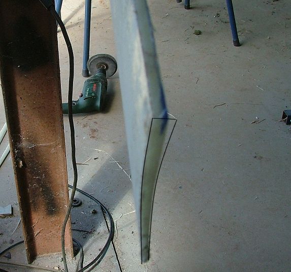

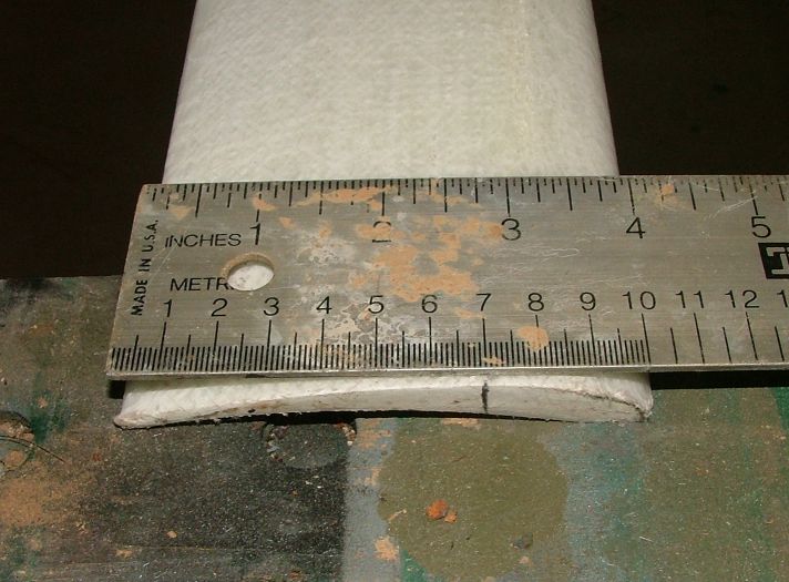

                            | Next you need to grab the drill
                              and sanding disc, and sand the concave side of
                              the blade back to our mark line. We are trying
                              to keep the concave shape, and the round sanding
                              disc makes this easy. Just take it easy at first
                              until you get the hang of it. This also makes
                              a lot of fibreglass dust, so make sure you have
                              you mask on.  I've drawn a black line on this
                                  image so you can see where the blade concave shape
                                  was before I sanded it back to the line. |  |

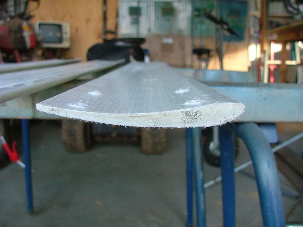

                            | Next we grab our power file or
                              belt sander and cut back at a 450 angle
                              from the leading edge, as shown. It will help if
                              you click on these photos to see full size. We cut
                              this 450 all the way back to the start
                              of our cut, 200mm from the blade root. |  |
                            | Then we do the same but this time
                              at about 200. Dont go all the way to
                              the blade leading edge, about 5mm back. As you
                              can see, we have something that looks like a airfoil
                              again. |  |

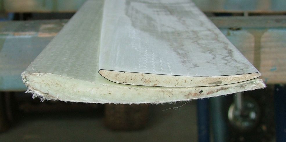

                            | Now we need to grab a sanding
                              block ( or try the power file if you have the
                              confidence ) and sand down the edges. We want
                              a nice clean curve from leading edge to trailing
                              edge.  On the leading edge, used a bit
                                  of sandpaper and your fingers to round off the
                                  nose. I've drawn a black line on the image above
                                  to show the best shape, and also shown is a unmodified
                                  blade for comparison.  |  |

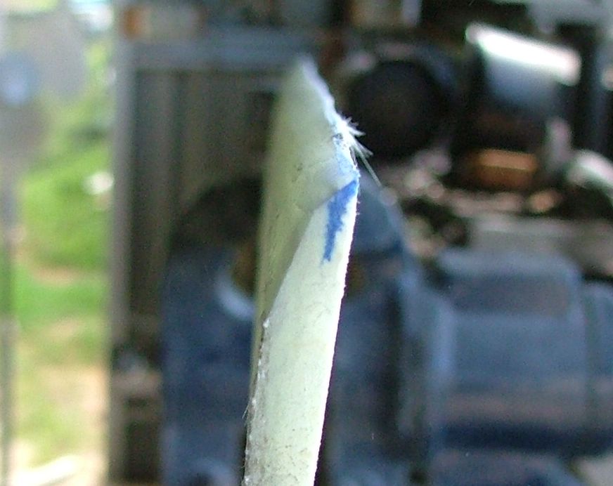

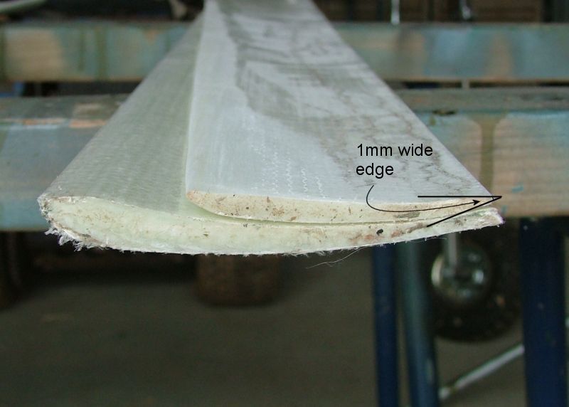

                            |   We also need to clean up the trailing
                                  edge of our blade. From factory the blades have
                                  a rounded trailing edge. Use you sanding block
                                  to give the trailing edge more of a point by sanding
                                  the top and bottom surfaces, but dont go too far,
                                  leave the trailing edge about 1mm wide for strength. |  |

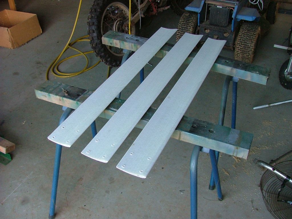

                            | I've also reshaped the blade tips.
                              No real science in this, but I've seen this sort
                              of profile on the large windfarm windmills, and
                              I know those guys are very concerned about windmill
                              noise, so I assume this shape works. |  |
                            | The finished blades are very fury
                              with fibreglass, so I painted my blades and then
                              sanded with 800 wet and dry paper to remove the
                              fibreglass hairs, then another coat of paint. |  |

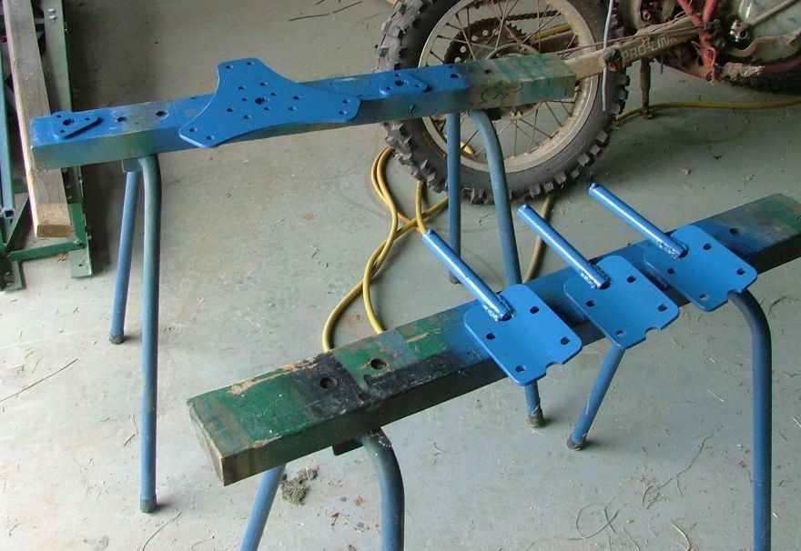

                            | This is the hub I made to match
                              up the fibreglass blades with the F&P drive
                              shaft on my windmill. I wont go into the details
                              of this as its only a prototype design. |  |
