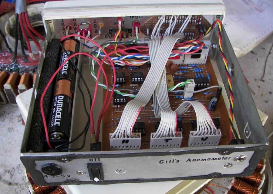

I have an anemometer that can log wind speeds direct to a computer. There is no problem when close to existing dwellings as the logging laptop can be safe and powered from inside the house. However on more remote sites, I’m not inclined to leave my laptop unattended whilst it records data over many days. There is the power supply to be sorted if it were and besides, I need to use my laptop. To overcome these problems I felt a stand alone anemometer datalogger was needed. I decided to build one for myself. |

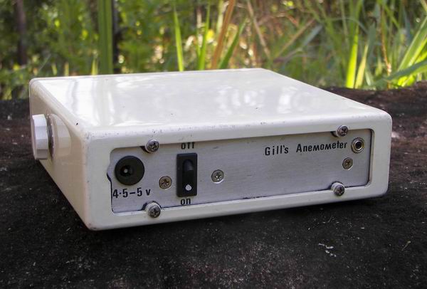

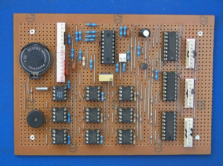

The completed unit is based on the PicAXE 18x. It stores data in 8x serial eeprom, so holds 2Mb of data. 3x 7 segment LED display gives a local display of wind speed. Data and display shows wind speed in either kph or m/s as user set. Sample time of the wind speed can be user set from 1 second up to the international standard sample time for small wind generators of 60 seconds. This sample time influences the number of days data can be collected over. To aid power conservation and extend logging duration, a very low power Sleep Mode is entered if wind speeds drop very low. Regular brief checks are made to assess if the wind has picked up during the sleep mode. During sleep mode the display is also disabled though typically this would be switched off when not attended by the user. |

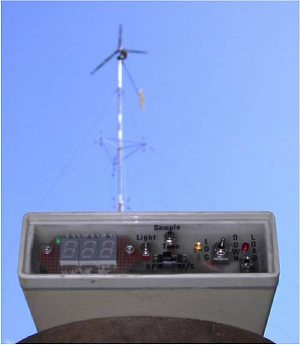

In operation there are 3 states of use as controlled by the main Logging switch.
- ‘Display Only’; gives a wind speed reading that is updated at the end of each sample time. A green ‘Power On’ LED flashes each second and is most accurate as coming from the clock IC. It starts flashing at power ON and stops at power OFF.
- ‘Log’; sends clock time and wind speed data to be saved on eeprom. Each time this data is logged an orange LED flashes. Logging continues until either all the eeprom are full or logging is turned OFF by the user. Cessation of logging by either cause results in the orange LED no longer flashing.
- ‘Download’; firstly, it is necessary to have the download cable connected, and the appropriate software running before downloading to the computer and saving to file. Fortunately data is only erased by overwriting so multiple downloads of the same data is possible. During the download process the red LED is ON, and the display is disabled. Display returns to the Display Only state when the download completes.

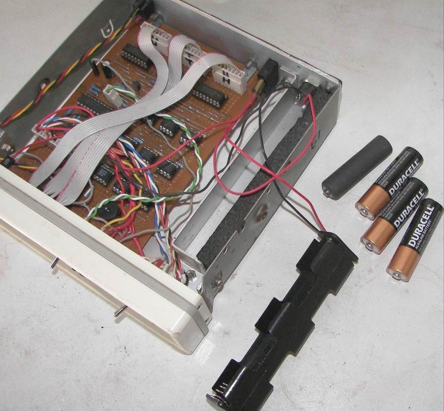

Suitable power input comes from either one of 3 sources.
- Firstly, internal 3 x AA batteries. At 1.5 volts, this gives a nominal 4.5v. Here a dummy battery is fitted into the battery holder to complete the circuit.
- Secondly, internal 4 x NiCad at 1.2volts gives a nominal 4.8volts.
- Lastly an external power source in the range of 4.5 to 5volts DC can be used. The external source disconnects the internal batteries, so unfortunately there is no recharging of NiCad’s without removing them.

Circuit Error. Please note there is a error in the circuit Gill has drawn up. Pins 7 and 11 of the PicAxe 18X chip are labeled incorrectly, they should be swapped around. The Veroboard component layout is correct.
