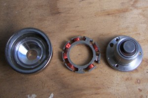

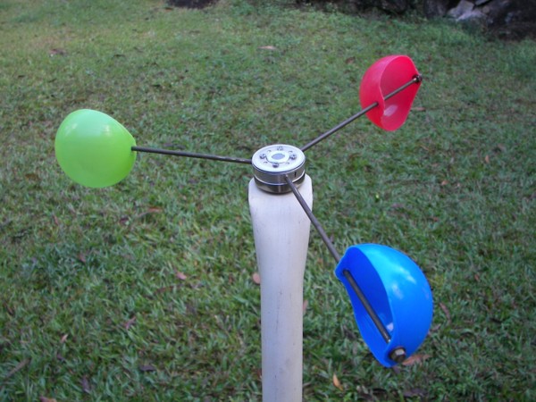

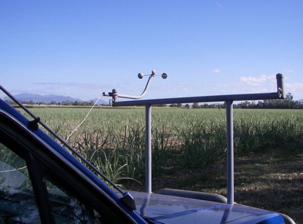

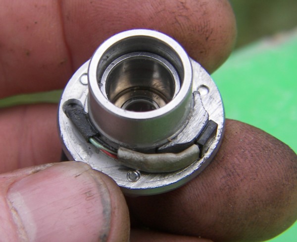

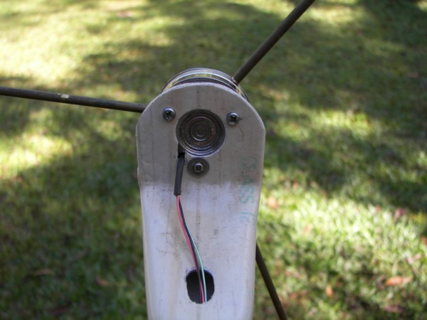

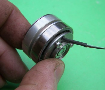

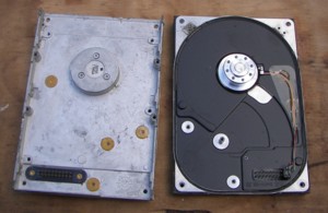

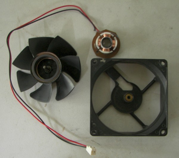

 Cup Type The anemometer head was made from the drive motor of a  computer hard disc drive, three plastic toy juggling balls, 3 short lengths of  welders braising rod, and a nut, plus of course the all important UGN3503U hall  sensor.

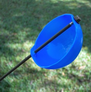

                            | Procedure:   Prise open the motor and dispose of the stator replacing it  with a steel block cut from a nut and the hall sensor. Then reassemble ensuring  the sensor is clear of the magnetic ring.  Cut thread to both ends of each of the100mm to 110mm long braising  rods. Tap 3 holes to suit in a thick HDD platter spacer.  To this fit the rods and balls that have been  cut in half to make the cups.  Balance  using heavy copper wire wound around the lightest rod spiders.   Mount to a suitable pole or spar for  calibration.  Fit the pole or spar to  your vehicle and on a still day, with a laptop connected, drive down a smooth  private road noting the vehicle speed and anemometer reading. I found Glenn’s PicLog excellent for calibration as the  conversion factor is able to be changed without reprogramming the PicAXE.
 The cogging reported by others using a hall sensor is almost  unnoticeable in the units I have built.   It is normal to see it turning in a draught when there appeared to be no  air movement at all.On one installation the head was connected by well over  60meters of cable to the anemometer control unit.  Reduction of the control units trim pot setting from the normal  1m Ohm was needed to offset the line loss.   The reduction was by about 5 turns of the available 25 so reasonably  long cable runs are possible. |

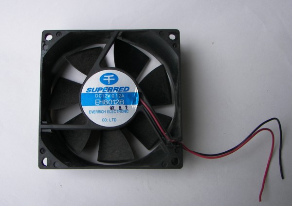

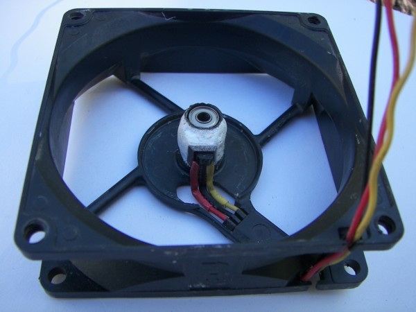

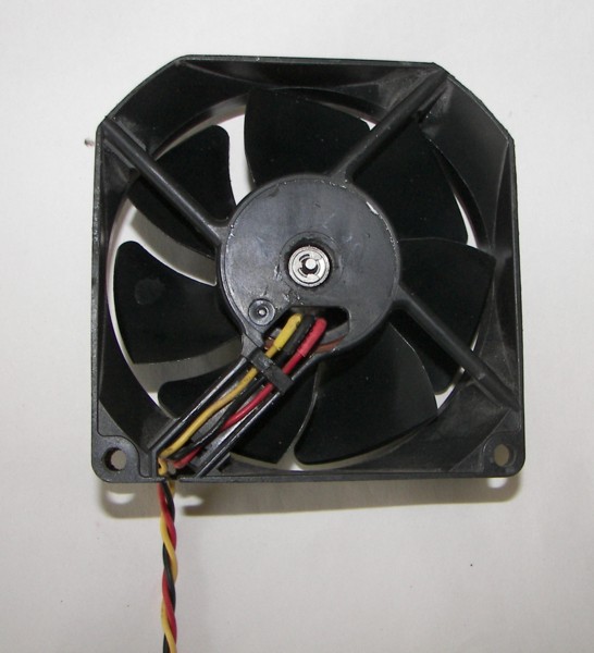

                            | Fan Type. A fan type head has also been used and may suit some  installations. As the signal method chosen was the same as the cup type a  similar motor modification is used.   Unfortunately, whilst easier to modify the fan than make a cup type, the  fan type needs a yaw bearing and tail to track the wind and slip rings for  power and signal wires.  Its smaller  swept area is more susceptible to cogging though its revs are 10 times greater  giving better resolution.  I use the fan  type for bench testing as it can be blown by another computer fan over many  days and is quite compact. Gill. |
