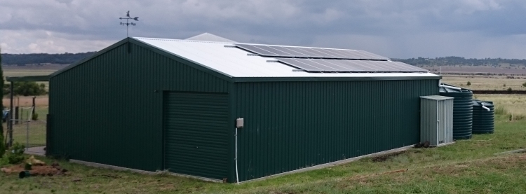

                          | My hardware. So I stated with the following system, installed in 2012, and has been in operation since then. Its basically been trouble  free, and I've never run out of power, but I've had to make a few small sacrifices, and I've upgraded the system in a few places. Will go into these later.   Solar Panels to generate the power.  12 190watt 24v 72cell panels. If your going off grid, 24v 72 cell panels are the best option, they  produce more power in low light. You can get 64 cell panels, but these are more suited to grid connect systems. For 48 volts, I connect two 24v panels in series. |  |  Because I live in the southern hemisphere, my panels are mounted on a north facing roof of my workshop shed. When I built the shed I intentionally faced the roof north to capture the most sun. Facing the solar panels north helps, but its not critical, you can be slightly east or west, really depends on the number of panels you can buy and the available roof space. The photo below shows 20 panels, I upgraded a few years after the initial install.

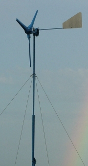

 As I'm on a rural property, I added a windmill to the mix. Its a home made machine, and good for around 500 watts in strong winds, though usually supplies 50 to 150 watts in typical winds. The windmill extends my battery banks life. How? A battery banks life is dictated by the number and depth of the discharge cycles. The less you discharge the battery each night, the longer it will last. The sun goes down, I cant do anything about that, so at night my batteries go through a discharge cycle. But if there is enough wind at night, the windmill generates a few watts, and this helps to offset the power I'm using over night. On some windy nights, the windmill is making as much power as I'm using, and this means my batteries didn't discharge at all, effectively giving the battery bank an extra days life. But windmills are not suitable for most installations. Fortunately I have a rural block on a open field, so have ample wind energy to use and don't need to worry about the neighbours. Wind power is also very erratic, and with moving parts windmills need a little maintenance, plus they need to be shut down during strong winds or stormy weather. I've had a couple of windmills come down during storms, something you need to consider.   Backup Generator. Once last component ,  a backup generator and charger. My generator is a Honda clone, 6kW. I've used this maybe 3 times a year to give the batteries a boost if its been overcast and raining for a few days. So it's rarely used, but handy to have. I built a 48v battery charger from a small welder by rewinding the transformer secondary and adding a bridge rectifier. The charger can supply 20 amps into the batteries, which is enough to top them up if needed, takes an hour or so running the generator. You can buy commercial chargers for 48 volts at 25 amps for around $1500. Next Page.  |
