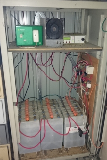

                          |  | I also added a secondary power system built from spare bits and pieces I've picked up over the years. Its a 12v system, using a bunch of old big industrial Nicad batteries, a couple of 70 watts 12v solar panels, charge controller and 300 watt BP Sine wave inverter. The inverter has enough grunt to run a small water pressure pump, which is used to water the garden, wash the car, etc.  The 12v system also supplies 12v to a few LED lights in the workshop, the solar water heater controller, workshop radio, etc. |  Next Page.  |
