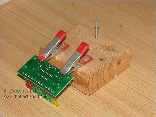

                        Here are some pics of quick and easy board holders.  They are certainly not in the same class as Pete's  engineered masterpiece but still beat chasing a small board around the workbench.  The first is just a block of wood with one or more cheap mini spring clamps from the two dollar shop screwed to it.
