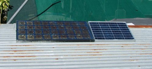

  A couple of 2nd hand solar panels supply several amps when the sun is shining.
