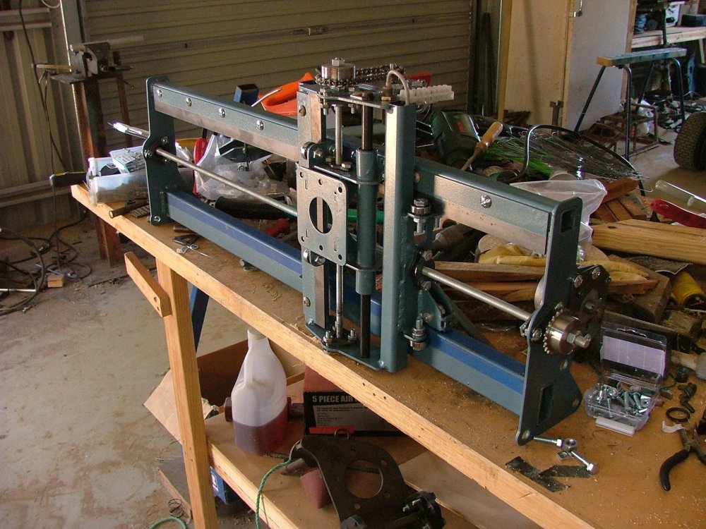

First up I designed and built the Z
axis. I figured it was the easiest part to make and
I could learn from it before I designed the rest of
the router. Luckily I have access to a industrial laser
cutter, so I designed the parts in CAD and cut them
from 3mm plate.

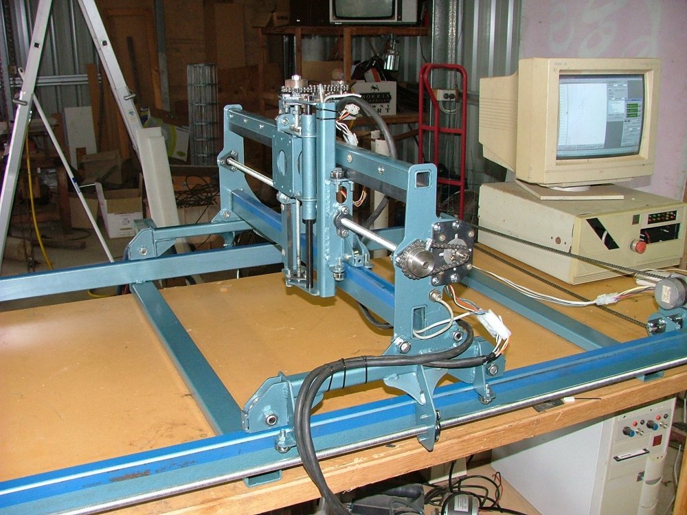

I designed, laser cut and assembled
the Y axis. I'm using roller bearings on box section
as the linear bearings, and allthread as the lead screw.
Yeah pretty crude, but cheap.
Next up was the X axis.
Overall bed size is 1200 by 600. And a coat of paint,
hammer finish always looks good.

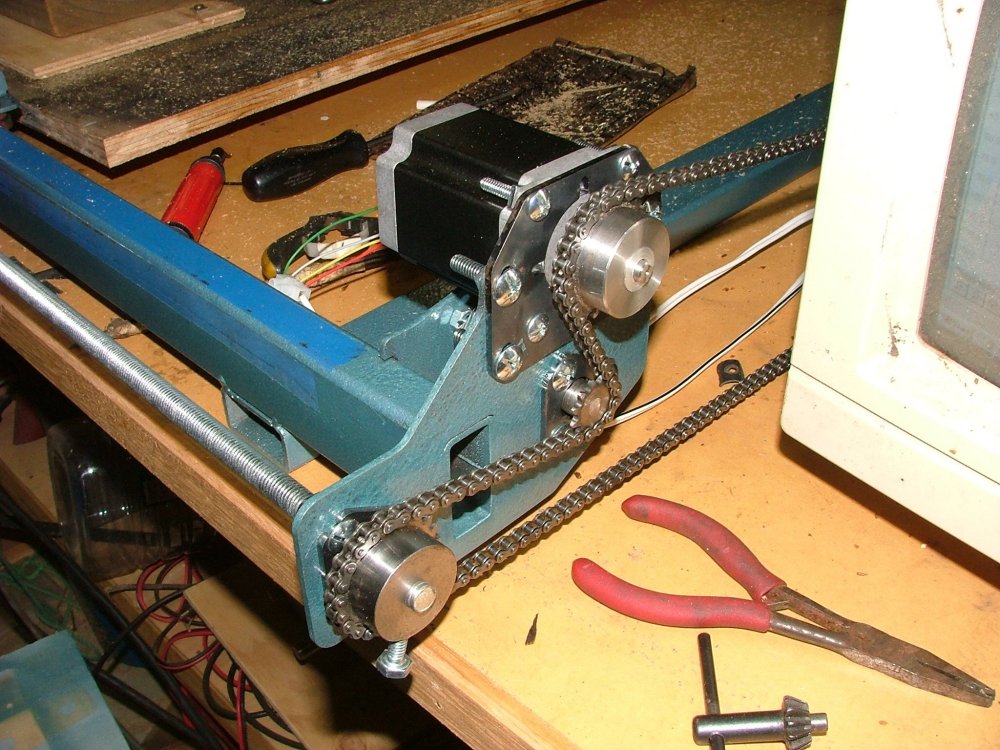

The X axis has two leadscrews,
one at each end of the gantry. These are driven by one
stepper motor. I've used chain and sprockets on my machine
because its easy to change gear rations. Chain is easy
to cut and join to any length, and very cheap, but noisy.
Once I have the router fully sorted, I will replace
the chains and sprockets with toothed belts and pulleys,
but chain will do for now.

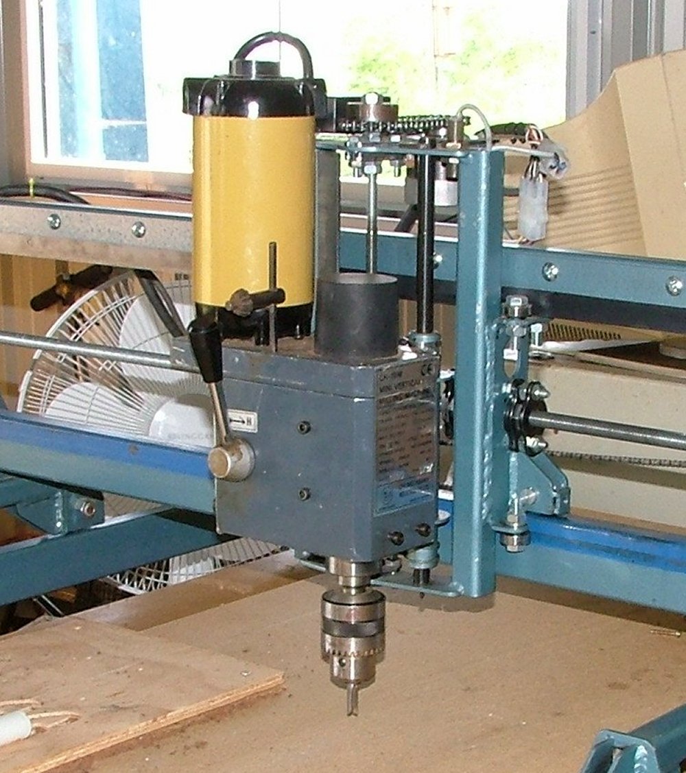

Now I needed a router head.
My hobby lathe had a milling attachment that I think
I've used once in the last 3 years. The mill has a variable
speed control, and 2 speed gearbox. So I mounted it
on the Z axis, fitted a 4mm router bit and tried some
test routs.
