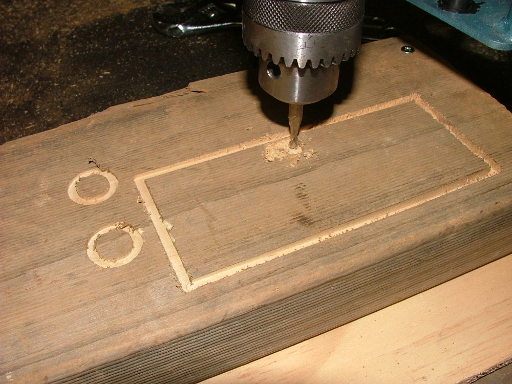

But I was still having problems. The
rout was very rough, any change in timber density (
grain ) made the router tip wobble. I worked out there
was too much movement or slop in the gantry, but this
was not easy to fix. I was considering abandoning the
current design and starting again with some industrial
linear bearings and good worm drives. But the cost was
scary.

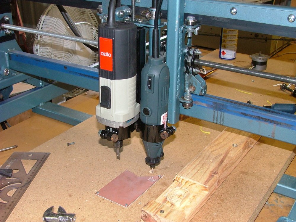

So I went out and bought a cheap plunge
router. The router has variable speed, 600 watt motor,
2 year warranty and cost a staggering $50. What the
hell, it if didnt fix the problem I could use it elseware
in the workshop. While I was at it, I bought a small
engraving tool.
I made an adapter for the Z axis to
take both machines, with the engraver mounted below
the router. So when I want to rout I take the engraver
off, and visa versa.

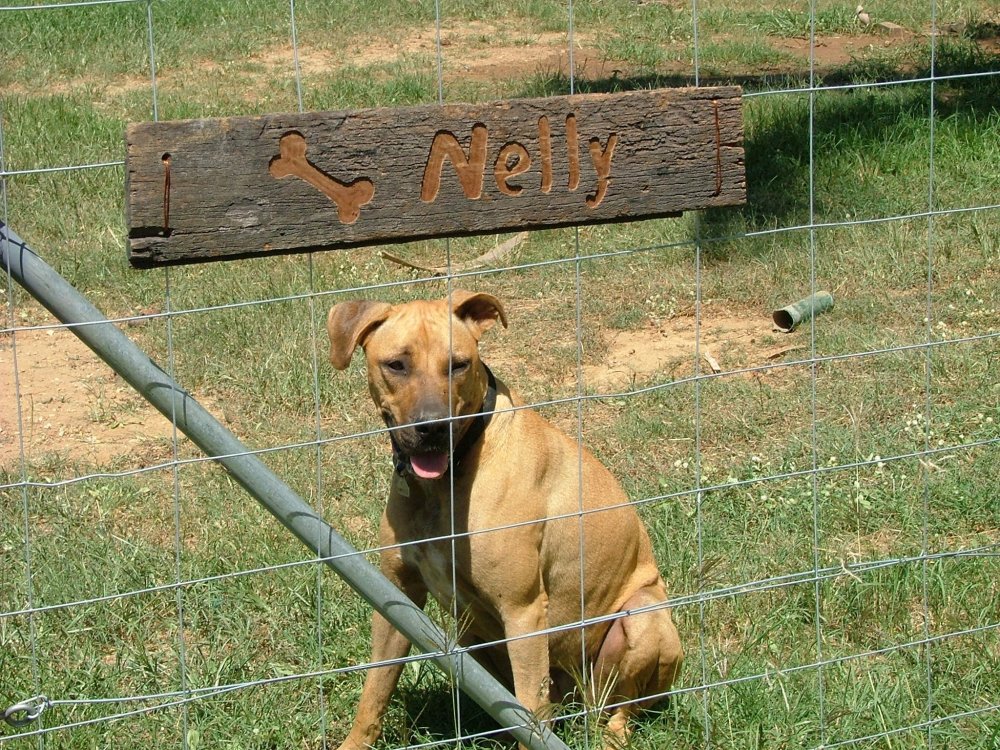

Well this made all the
difference. The cnc router now has no problems with
wobble, and give a nice clean cut. The machine was now
usable. So I made a sign for the dog from a bit of old
hardwood.
