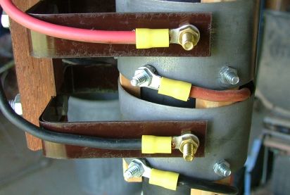

When I put this article together, I had two rules, the slip rings would be built from parts available from a hardware store, and you could have any number or rings depending on your alternator set up. With that in mind, I came up 2 designs. Both use the same slipring, but different brush assemblies. And because the rings are mounted one above the other, there is no limit on the number of rings used, within reason.

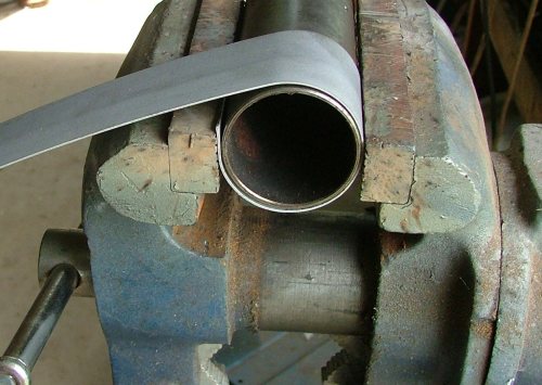

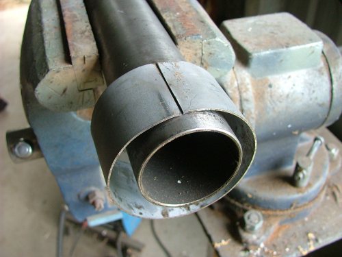

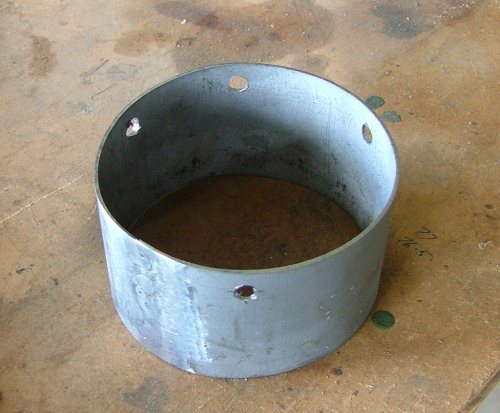

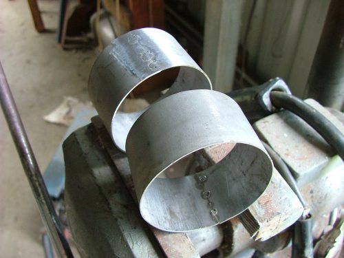

First up, the slip ring itself. I chose to make my slip rings from zinc coated steel plate. Its a easy material to find and work with. Copper is the preferred material for slip rings, if you can find some copper sheet or copper tube that would suit, go ahead and use it.

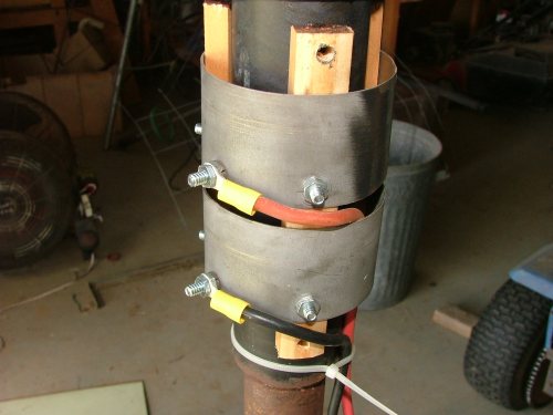

My rectifiers are at the alternator, so I only need 2 slip rings to transfer my power down the mast, but you could use this same design for 3 or more slip rings.

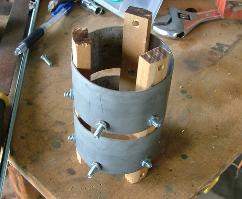

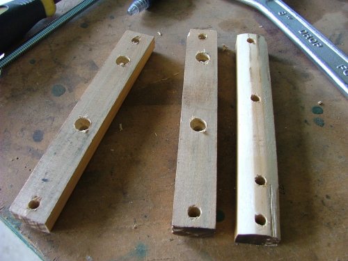

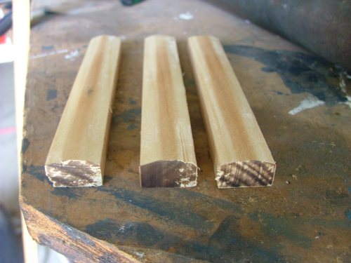

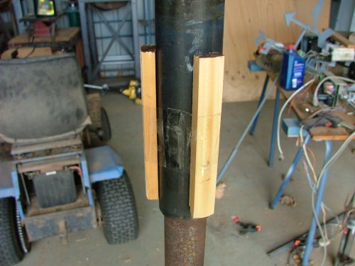

The slip rings are fixed to the windmill mast, and spaced apart with timber insulators. Timber is easy to work with and wont melt. Timber can burn, but the rings will never get hot enough, our slip rings are well ventilated and will act like heat sinks.
![](SlipRings/Slipring_end_view.jpg)
To the right is the top view of our slip rings, minus all the nuts and bolts. 3 timber spacers are used, but you could use more if you like, especially if using a softer slipring material like copper. Its important to make sure there is a air gap behind the slip rings to improve cooling.

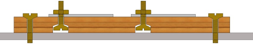

Below is sectioned side view of the timber insulator. As you can see, its a pretty simple affair. The sliprings are held to the timber insulators with screws and nuts, and you can see how the screw heads are in a countersunk hole to insulate them from the windmill mast, this is important.
![](SlipRings/Timber_Insulator_CrossSection1.jpg)
![](SlipRings/Timber_Insulator_CrossSection2.jpg)
