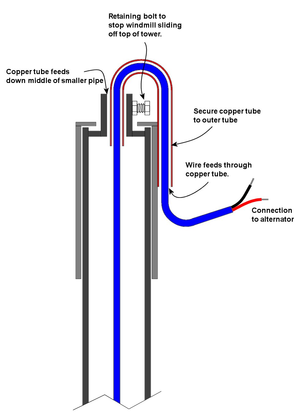

A better design uses an small extension
on the tower with a bolt to stop the windmill sliding
off the top of the tower. As my windmill tower is a
tilt tower, when I tilt the tower over the windmill
can slide off and damage the blades. So this is the
way I went.
The problem is you must guide the power
wire down the middle of the extension, or it will get
caught on the retaining bolt or bind against the extension
inner wall as the windmill yaws.
So you could use a short length of copper
tube bent in a U shape, and feed the power wide through
this tube. Make sure you secure the copper tube to the
windmill's outer tube with hose clamps or U bolts. See
the diagram. |

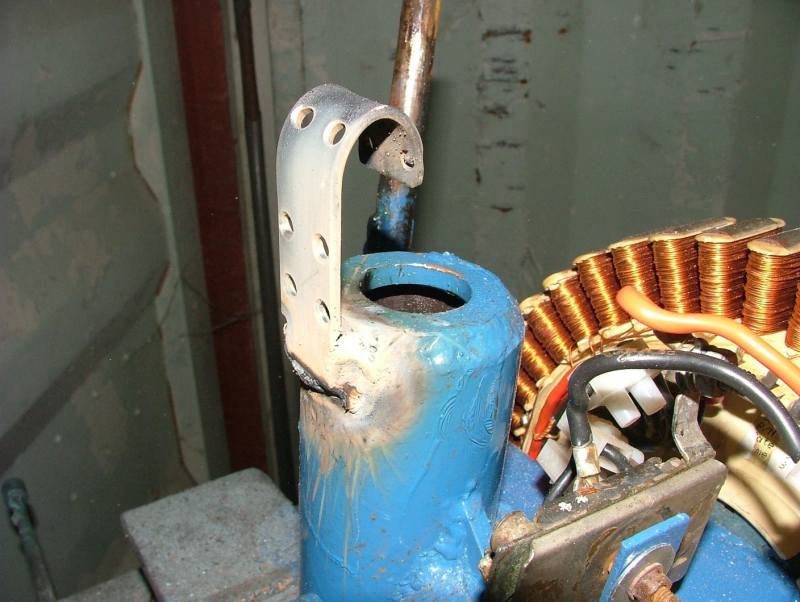

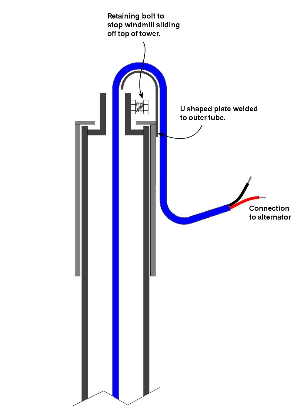

Or you could do as I've done
and welded a U shaped length of 25mm wide flat bar. |
![](images/newdesign/dropwire3s.jpg) |
I drilled some holes in the
flat bar to take cable ties, you see how I attached the
cable in the next couple of pages. |

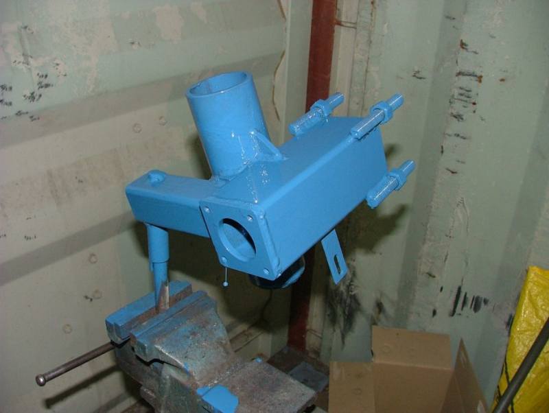

Next clean up your welds
and paint the windmill with a durable exterior paint.
I used blue Rust Guard. |
