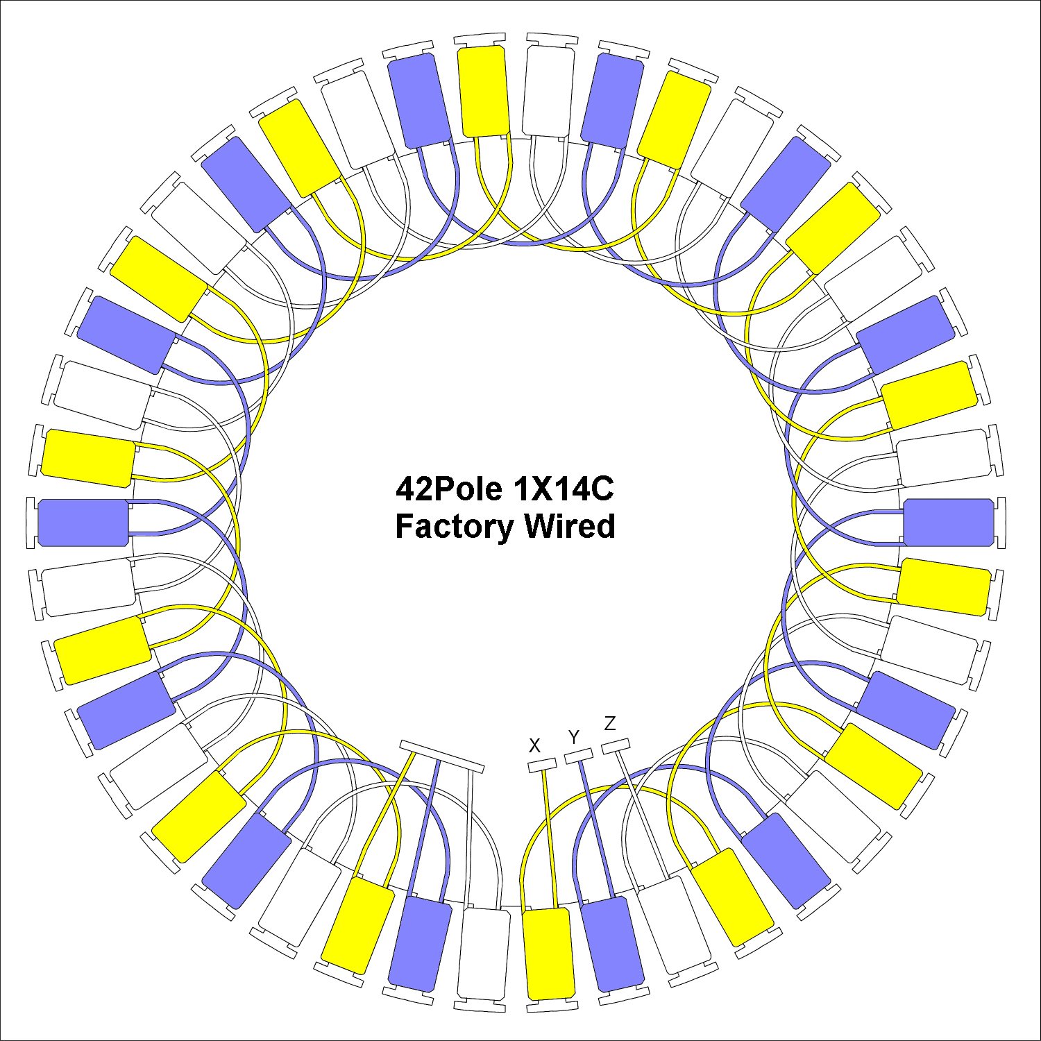

The factory 42 pole stator has 14 poles ( coils ) wired in series. So that would make it a
1X14C
( 1 times 14 coils in series )

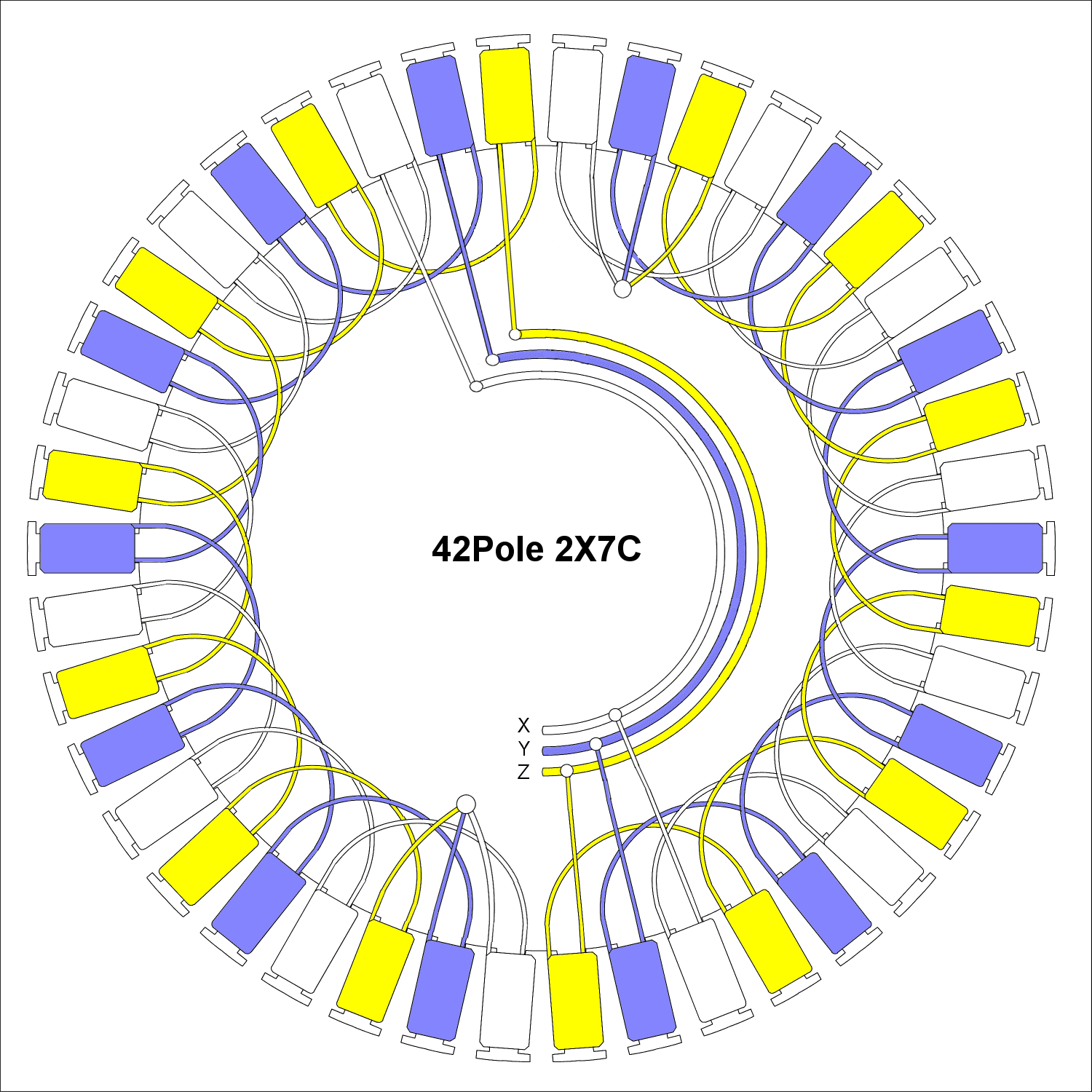

If we split the 14 coils into two lots of 7 coils, we would half the output voltage and double the output current. This would be a
2X7C
( thats 2 times 7 coils in series )

At right is a diagram of the stator factory winding. I've labeled the phases X Y & Z. Remember you can click on these diagrams to see full size. This a 1 times 14 coils, making it a 1X14C using our naming scheme.
This is a stator "split into two", so we end up with 2 times 7 coils in series. Best suited to 48 volts or 24 volts in low winds.
Using our naming scheme, this would be a 2X7C

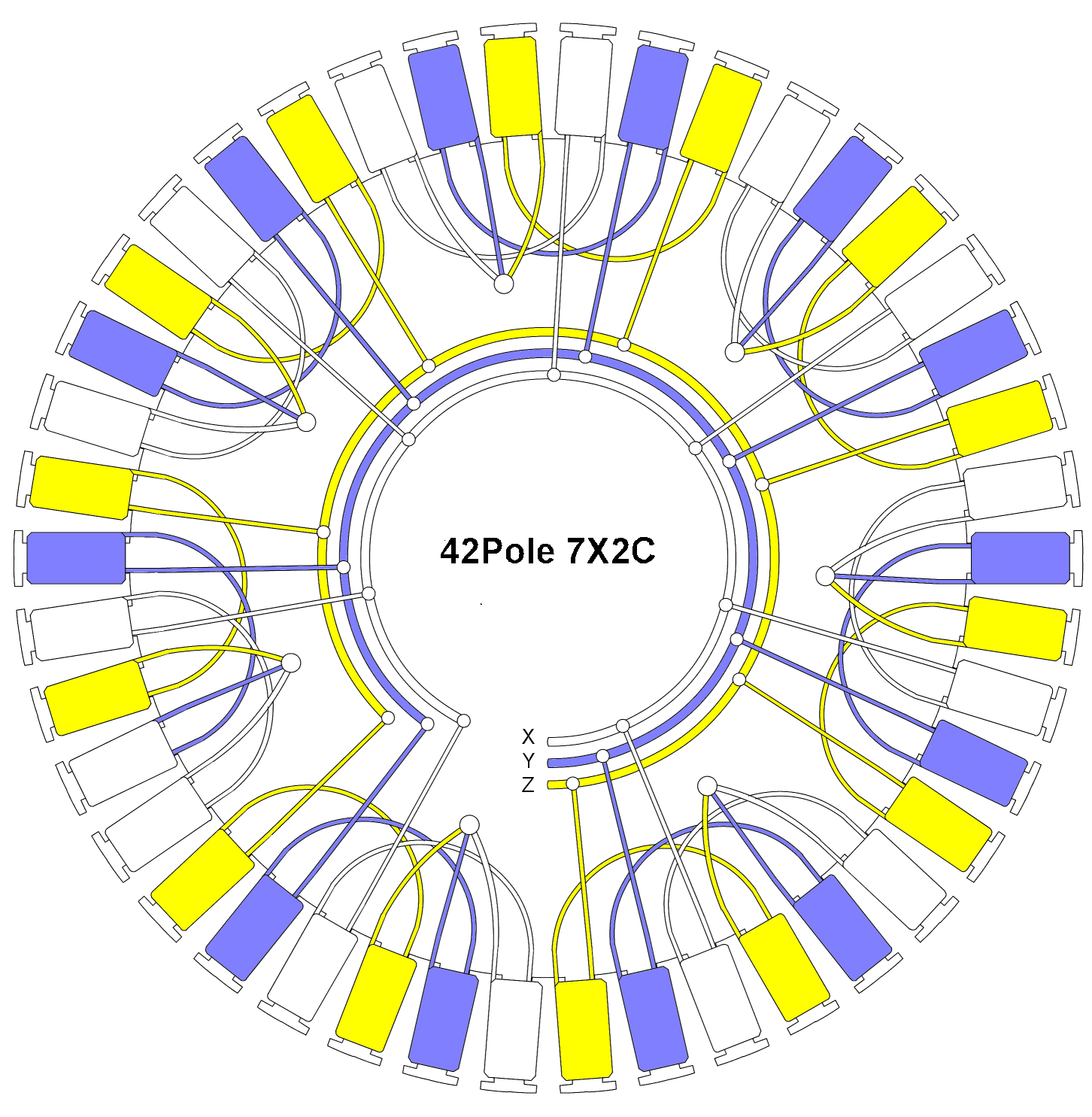

This is how we rewire the stator as 7 groups of 2 poles star configuration, suitable for most 12 and 24 volt applications, depending on how fast your turbine runs and what wire size the stator is. See What F&P is it? to identify which stator you have.
This would be a 7X2C

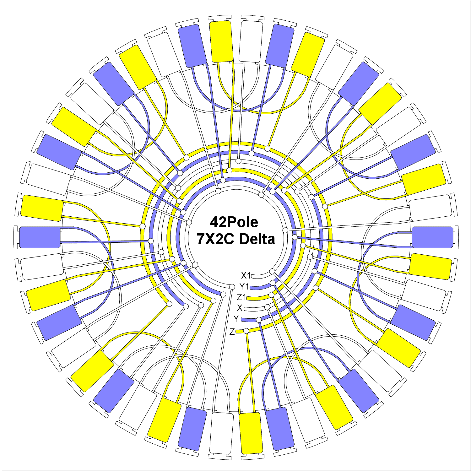

And this is how we can wire the stator to use for either star or delta configurations. Anyone who read the Silicon Chip articles I wrote will be familiar with this layout. The star/delta option gives you the ability to connect the stator as a star or delta. Delta will produce more power at high revs, but star will start making power at lower rev's and is the preferred option.
This is a 7X2C Delta

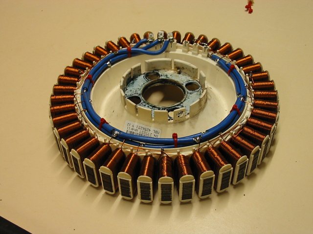

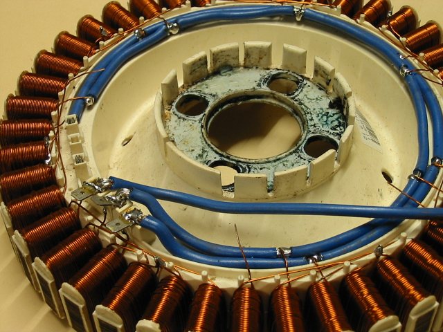

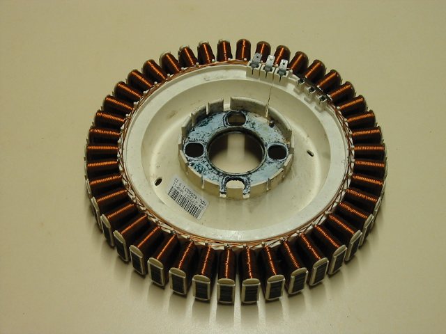

The standard stator. First remove traces of corrosion and file off any rust on the laminations

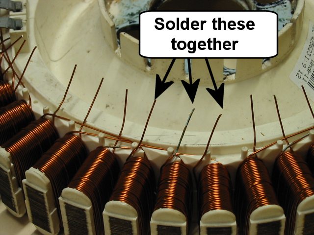

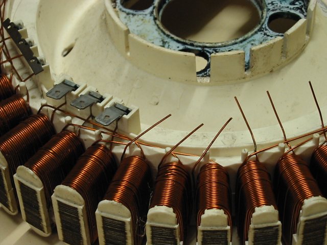

Cut the winding at every 6 poles. This will give you a total of 7 groups of windings, each with 6 poles, 2 poles per phase. Remember you can click on these photos for a closer look.
With sandpaper, clean the enamel off all leads for aprox 15mm from ends.

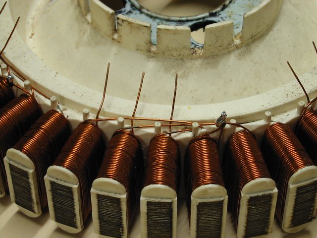

If you are making a 3 wire star stator, twist and solder the star mid point connections.
Strip lengths of wire as shown. Use wire capable of at least 15amps.

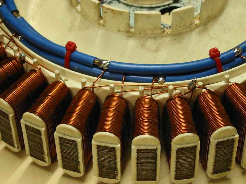

Solder three ( or six if you are going for the 6 wire star/delta option ) lengths of heavy electrical cable ( 4-5mm dia copper ) to the original connection terminal terminals, then strip back 5mm at each connection point. Cut the cables at the last connection point. This will form our power "bus". Wrap each star end wire around the bus wires as shown, and solder. You will need a good soldering iron for this.
Once all star windings have been soldered, cable tie the bus wires to secure the assembly.
The finished stator. Give the stator a good coating of varnish ( or similar ) to protect from the weather.

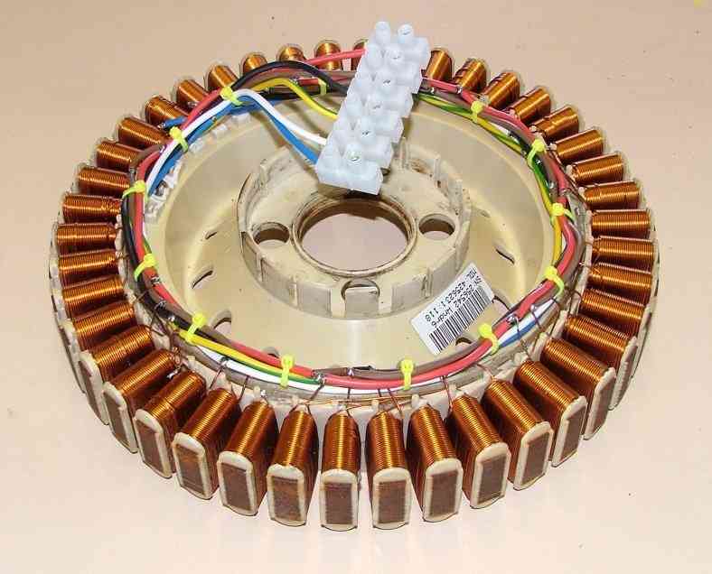

If you decide to wire as a 6 wire delta/star configuration, you stator should look something like this.
If you use a 6 wire star/delta configuration, the diagram at right will show you how to connect the output leads together.

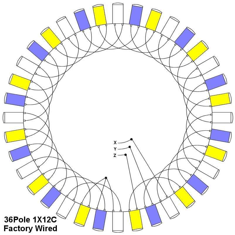

This is the standard factory wiring. This would work best for a slow running windmill, like a savonius type.
36Pole 1X12C

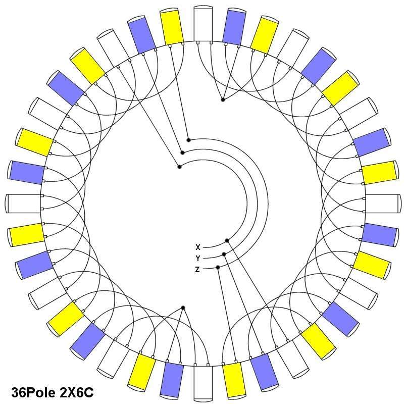

Rewired as 6 coils in series. Again suitable for low speed turbine or high battery voltage ( 48 volts or above ).
36Pole 2X6C

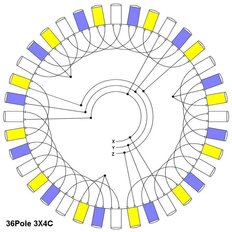

Rewired as 4 coils in series. Suitable for low speed turbine on 12 volt system or high speed turbine on 48 volt system. General all rounder.
36Pole 3X4C

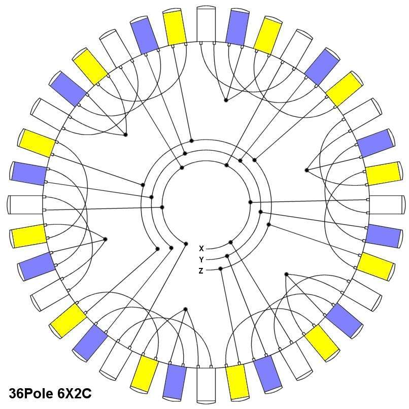

2 coils in series. 12 volts, high speed turbine.
36Pole 6X2C
