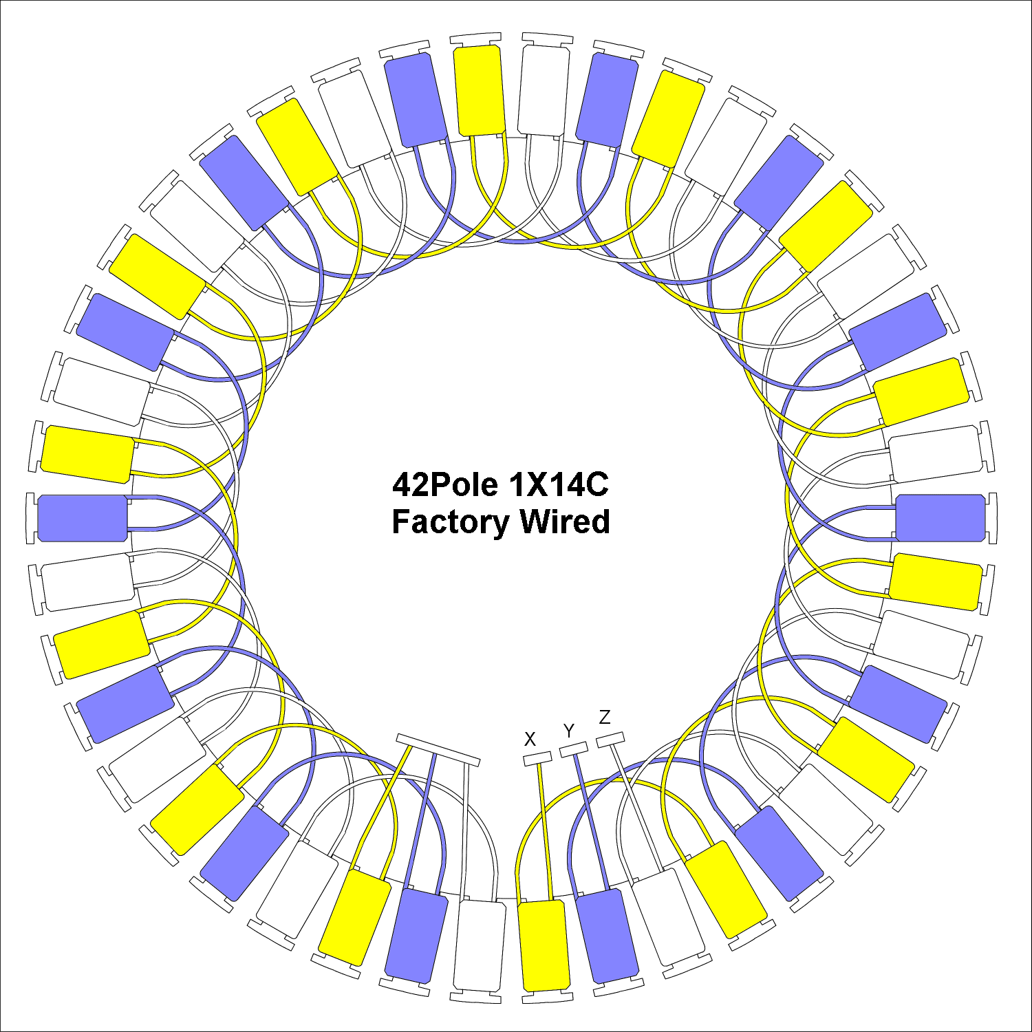

At right is
a diagram of the stator factory winding. I've labeled
the phases X Y & Z. Remember you can click on these
diagrams to see full size. This a 1 group of 14 poles,
so each phase consists of 14 poles. |

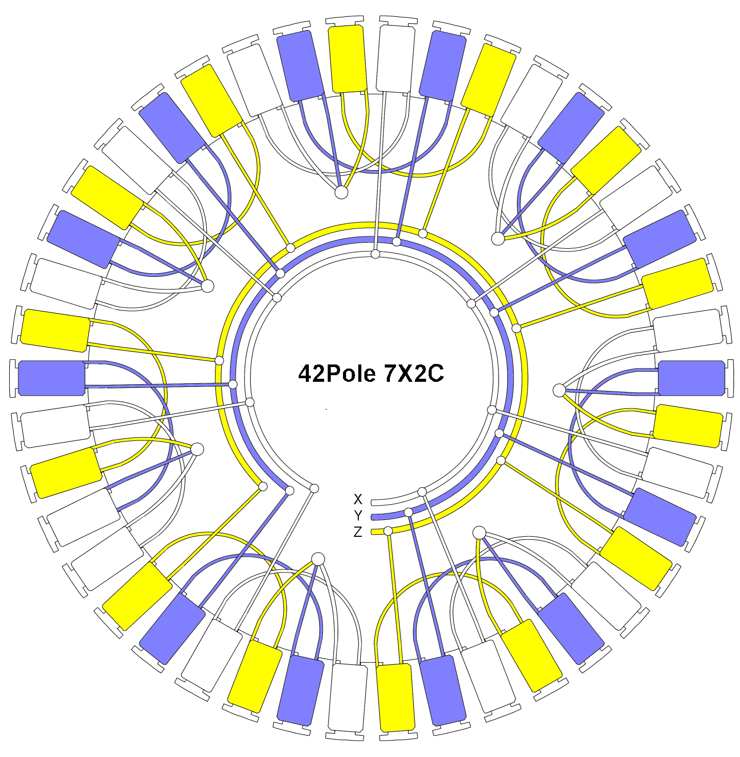

This is how
we rewire the stator as 7 groups of 2 poles star configuration,
and is the easiest and most common way to modify the stator. |
![](images/stator-stars.gif) |

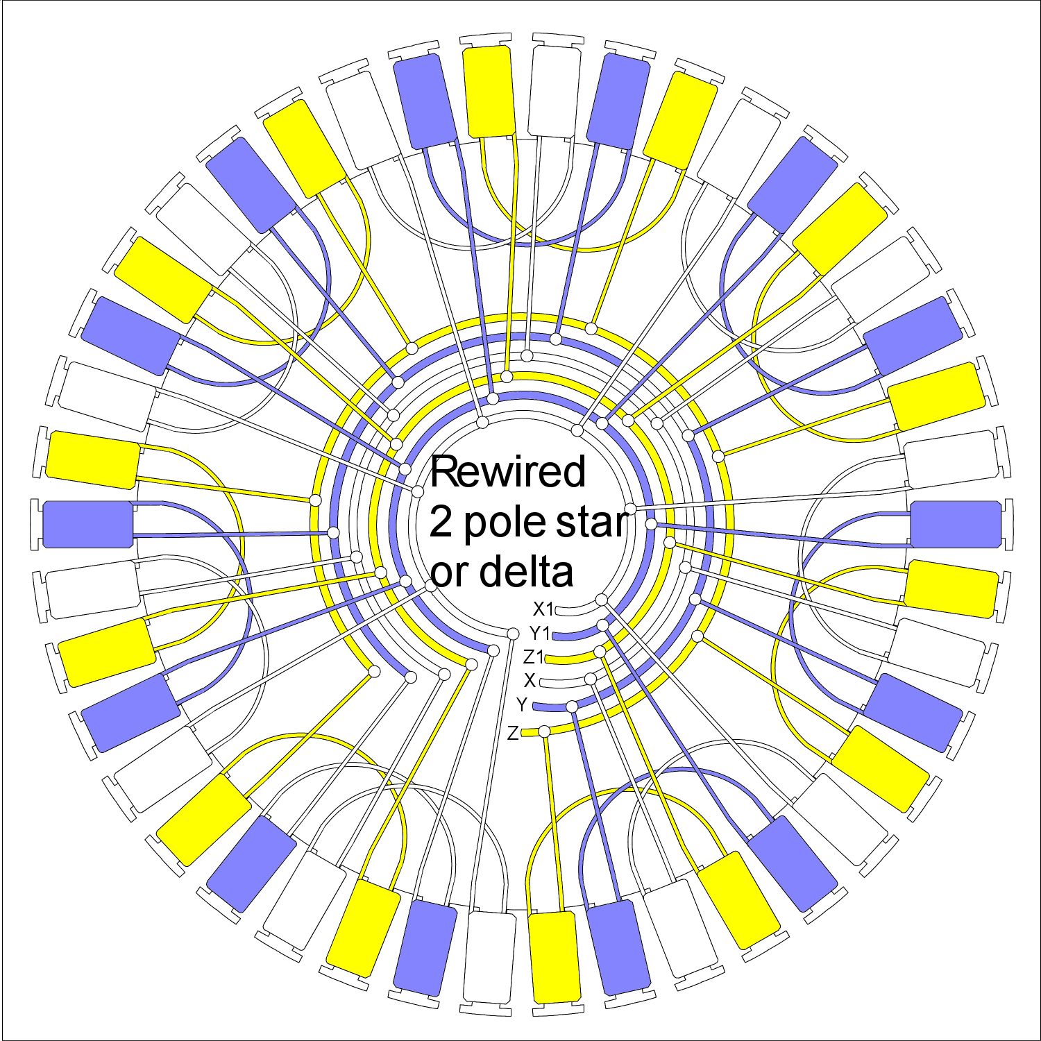

And this is
how we can wire the stator to use for either star or delta
configurations. Anyone who read the Silicon Chip articles
I wrote will be familar with this layout. The star/delta
option gives you the ability to connect the stator as
a star or delta. Delta will produce more power at high
revs, but star will start making power at lower rev's
and is the prefered option. |
![](images/stator-deltastars.gif) |
