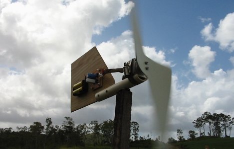

The Mini Mill is a fun little weekend project,
and can be used to light a LED, small light bulb, or even
charge a couple of NiCad batteries.

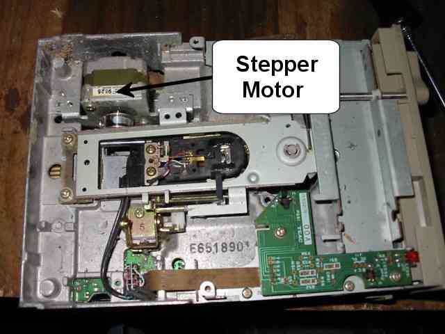

| First up remove
the stepper motor from the old FDD or printer. The square
type, as shown here, are preferred for this project as
they are easier to mount. |

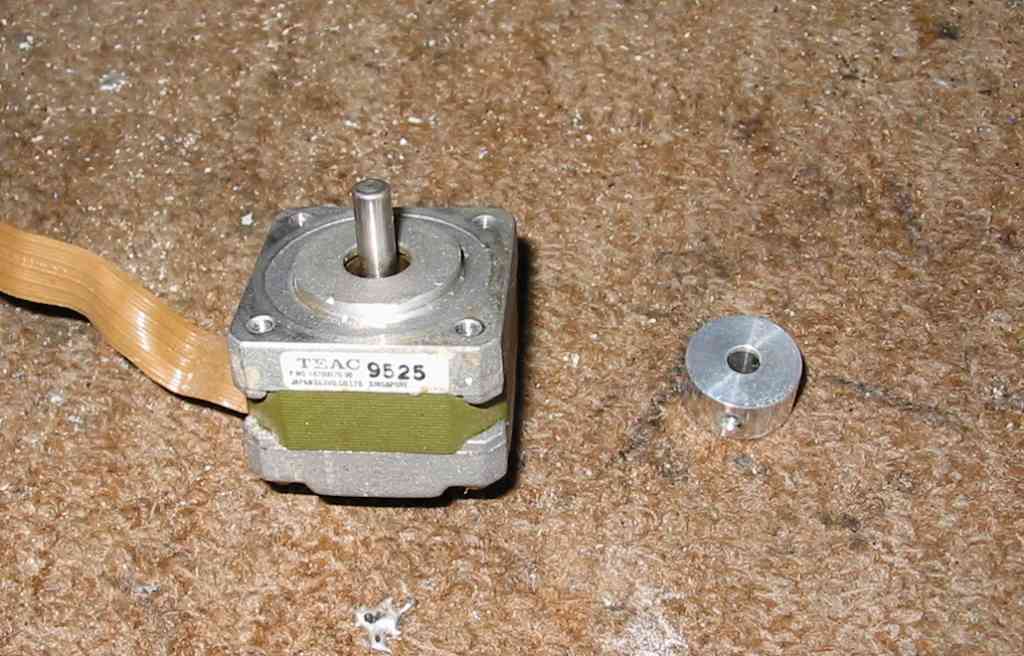

| Next you will
need to remove the aluminium wheel from the stepper motor
shaft. Easiest way I've found is to mount the stepper
motor in a vice with the wheel up, then quickly heat the
wheel with a small gas flame ( blow torch ) while prising
upward with a couple of screw drivers or long nose pliers. |

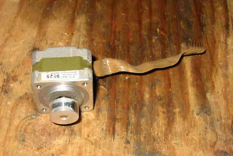

| As soon as the
wheel is free spray the stepper motor with water to cool
it off. Excessive heat in the stepper motor will damage
the magnets. |
