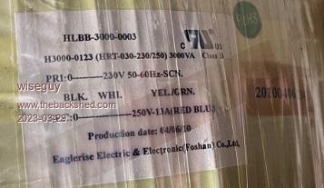

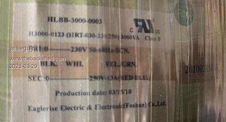

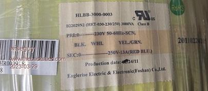

| wiseguy Guru Joined: 21/06/2018 Location: AustraliaPosts: 1336 |
Some good news, I dodged a bullet, the third Aerosharp is the same transformer as the first. the second Aerosharp is not identical just nearly, it measures 210mm across. Aerosharps 1 & 3 measured 220mm across. Heights of all 3 were the same ~ 90mm. Some pictures below No 1) Production Date 6/4/10 ![]() No 2) Production Date 24/2/11 ![]() No 3) Production Date 15/3/10 ![]() I was just lucky that 1 and 3 were close together in manuf. dates All inverters have the exact same model number on their stickers. The only downside is the idling current of unit 3 is ~ 13.5W, unit 1 is ~ 12W. The odd one out with the slightly smaller diameter was the lowest at ~ 9.5W So I now have ~ 39 electrolytics, 16 Hall effect current sensors, 9 x large C-cores 3 large boxes with BIG heatsinks and crap all over the place - so many circuit boards screws and cables - anyone want some stuff ? Roger the picture of your Eaglerise Transformer dated 28/3/10 was made 13 days after my number 3 and 9 days before my number 1. I will post this before I lose it....... If at first you dont succeed, I suggest you avoid sky diving.... Cheers Mike |
| rogerdw Guru Joined: 22/10/2019 Location: AustraliaPosts: 957 |
Oh well, it still gives you options ... and there's more metal in the core of these toroids than the other type. It is amazing just how much hardware is in each of these units and it's difficult to decide what to keep and what to turf out. Certainly the caps have value ... the C-cores ... the heatsinks etc etc ... and all those shiny stainless screws. Now I'm kicking myself for not including the footprint of these particular current sensors on my mppt boards coz I've got a heap too. Surprising the dates on our transformers being so close, probably from a big batch sent to Adelaide. I couldn't find the details of the other one of those I used. Cheers, Roger |
