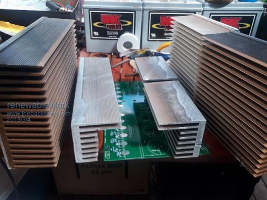

Posted: 01:04am 04 Mar 2018
Woops, just realized I should have used 1 heatsink per side.
I cut one lengthways in half and chopped it up from there.
Still have enough to do them again full height, shall I do that?

I found you need to cut the height down to fit in the case with the control board on top.
Mark do you have access to a table saw? With an Aluminium blade you get a much nicer result.

Posted: 01:18am 04 Mar 2018
I have a table saw, reckon I'll just get a blade and do it properly.

  Madness said   I found you need to cut the height down to fit in the case with the control board on top.
How many fins high did you find worked well?
Just got back from buggerings with an aluminium blade for the saw, that will fit in the mitre saw too, so might come in handy for other stuff.

Posted: 03:52am 04 Mar 2018
I think it 4 but don't take my word for it. I used 18MM long M4 Brass nuts in the bottom to mount the PCB, I also put a 4mm thick piece of perpex on top of the heatsinks to hold them and mount the control board. You will have to work out your own measurements, don't forget to allow for the heatsinks on the control PCB.
You won't regret getting the Aluminium blade, the end result is well worth it.Edited by Madness 2018-03-05

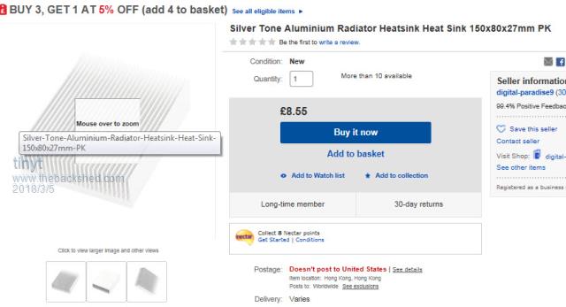

Hi Mark,
The original design of the OzInverter Power board was to keep things simple and easy to put together.
I spent some time researching the best heatsinks for the power board that kept the power board as compact as possible yet it has sufficient cooling capabilities.
As in my supplement parts lists I give details of the 150mm x 80mm x 27mm heatsinks that are ready to direct fit, with slight length adjustment, and 2 of them will require joining together.
The below link is a common industry size, and yes they will Free deliver to Australia.
http://www.ebay.co.uk/itm/Silver-Tone-Aluminium-Radiator-Heatsink-Heat-Sink-150x80x27mm-PK/332371891036?epid=2069045428& hash=item4d62e8935c:g:O5wAAOSw4i5ZsOJV
Please don't get bogged down with so called improvements with the heatsinks, what I suggest works well.
You will need clearance in the middle above the Big caps, for the 6off battery - flexible cables that go to the negative connection stud and meter shunt in your enclosure from the 48v battery. Edited by Clockmanfr 2018-03-06

I think it's funny how they won't post to China.
Thanks for the link Clockman, reckon I'll be right now I have an Aluminium blade for the table saw.
Those actually are pretty reasonable price, four of them delivered would be around $60 Aus.
It would have been cheaper for me to do that than buy a new blade for my table saw, but when the second one gets built the blade will have paid for itself, and I have an extra tool.
