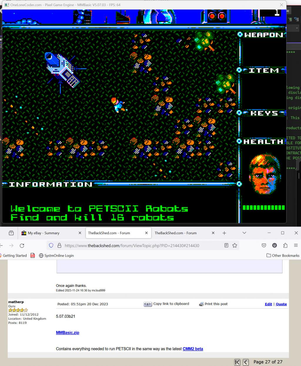

Posted: 05:51pm 20 Dec 2023
5.07.03b21
MMBasic.zip
Contains everything needed to run PETSCII in the same way as the latest CMM2 beta
Edited 2023-12-21 03:53 by matherp
