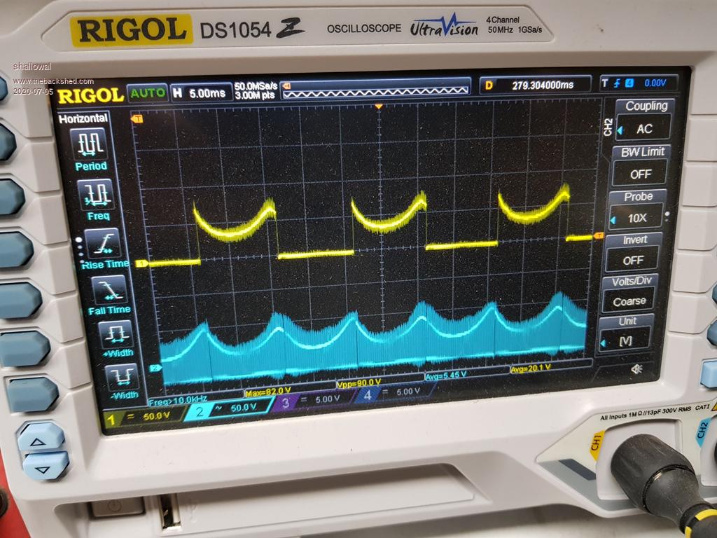

So, after much stuffing around with trying to "tune" the transformer I arrived at a solution of using a 4uf starter cap across the secondary which seems to give a peak amplitude of somewhere in the 65-85Hz range, but it's definitely very flat in that range and drops off significantly outside it.
Just to confirm my procedure.
Use a sinewave generator (Mines a DSO Quad portable oscilloscope) to create a variable frequency sinewave
Use a scope to monitor the amplitude/frequency) of the signal and adjust for maximum amplitude
Add/remove capacitors across the terminals to maximise the signal at 75Hz.
Connect this lot to the secondary (240Vac) winding with nothing else connected.

I had forgotten and only just now noticed that I had wound my choke on a pair of the Aerosharp choke cores, but as I previously mentioned, I only had 16mm wire so doubled it up to achieve a pair of 9 turns. I've got the cores arranged side by side rather than back to back as Mark had shown here: https://www.thebackshed.com/forum/ViewTopic.php?TID=11564&P=2#139534
I just tried measuring it with my el-cheapo ebay component tester and it showed 0.05mH and 0.4 ohms.
Allan
Posted: 06:51am 21 May 2020
O/k 16mm sq is good for at least 80 amps and x2 that 160 amps running warm.
Nine turns is not a lot so try a slightly smaller air gap say using 1.0mm spacers. That should produce a bit more than 50uH which might be a better overall tradeoff between inductance and final saturation. 50uH is about the acceptable minimum, but a little bit more is a little bit better.
The resonant peak will not be at all sharp, and its quite difficult to decide where the peak actually is. But you are probably very close, and it should work well.

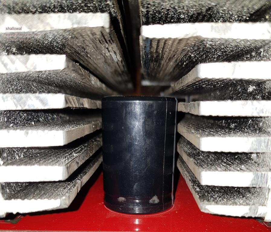

I think I discovered why I had that last blow-up.
Allan

Looks like it needs a bit more clearance between the heat sink and capacitors...would help a little with airflow
I'm working on a control board at the moment, checking solder joints, been bitten by bad joints before.
Some places (trim pots or any tracks) on the top side of the board where the solder may not have flown through from the bottom, I have just fixed them up just to be sure that there will be no problems there.
Might be worth removing the big Capacitors (Carefully) and running the inverter with a current limiting resister, just to be sure everything is working again and to avoid more damage.
Don't need to load it with more than 100watts or so to see if its ok.
Hope it works for you, looking forward to seeing it going.

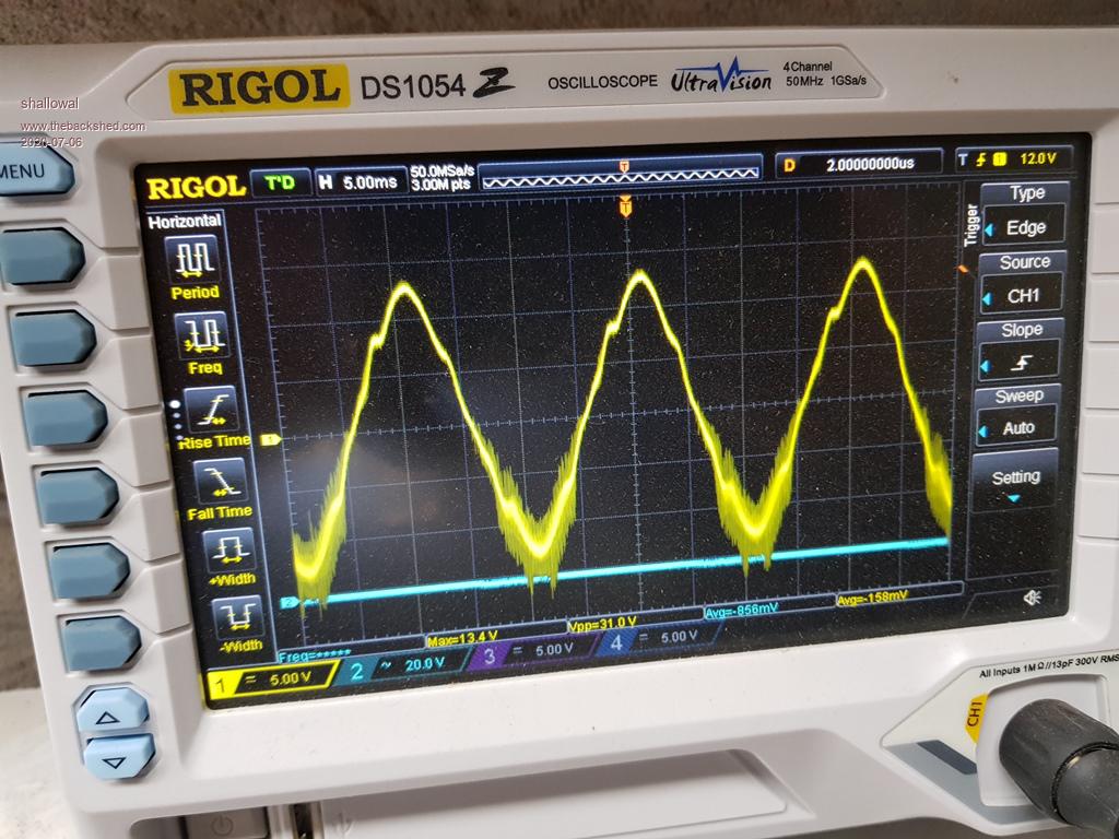

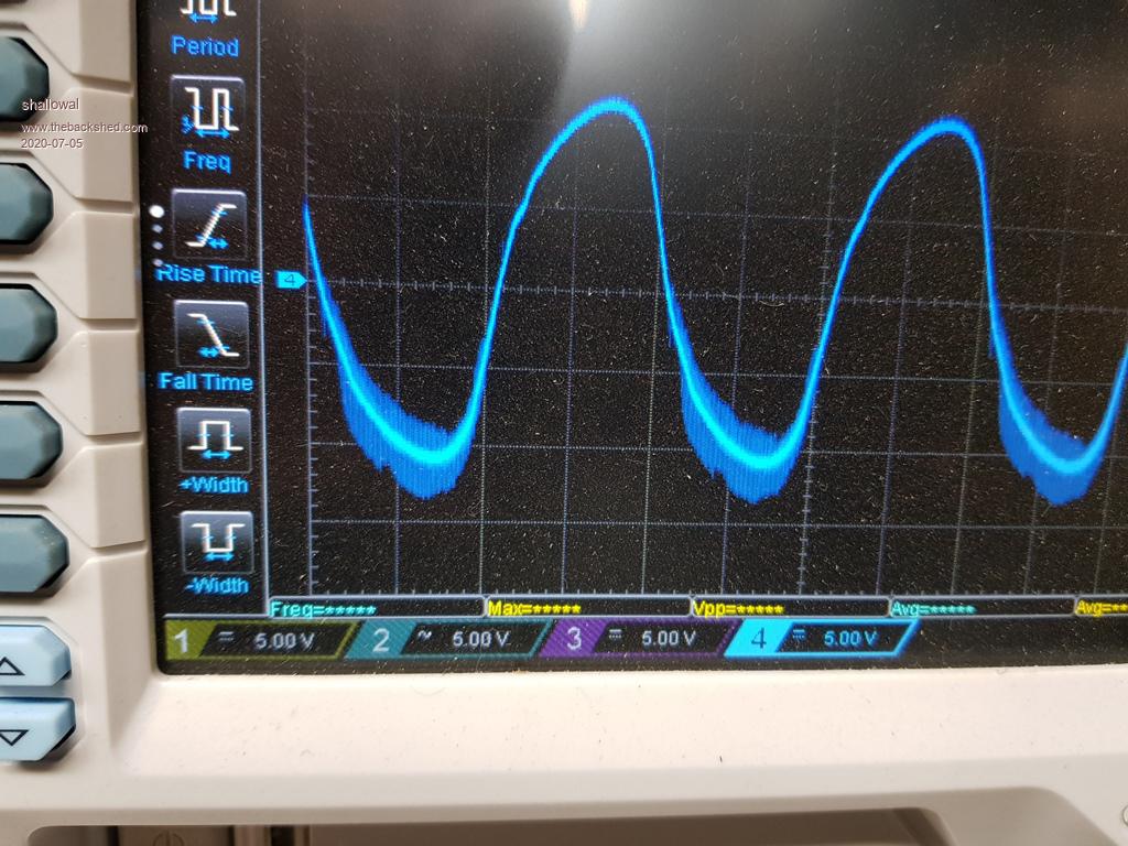

So by using the current limited power supply I discovered that I had a damaged through hole on the Drain of one of the Mosfets, so essentially no connection, and the replacement IR2110 had a faulty output on pin7 thereby preventing the chargepump voltage buildup. Looked good without the powerboard, but was all but zero output when loaded.
So now I have got to the point of installing 8 FETs, but no caps and connecting the toroid and examining the waveforms.
Is that fuzz on the bottom caused by an underrated choke?.
Or is there something else happening somewhere?.

Fault finding after a mishap is often the most difficult part of the project, trying not to burn up all the new components and work done in the process.
Can't say I have seen a fuzzy trace like that yet, but I also don't have Good DSO that would have a fast enough sampling rate to see it.
I'm not sure if the choke (if underrated) would be doing that, what I did last time at this stage, was to put 1 small capacitor back in (think it was a 120uf all that was handy on the bench) hopefully not big enough to damage the fets if something went wrong, it was just a small effort to help stabilise the DC supply on the power board bridge.
Anyone have a different view on this?

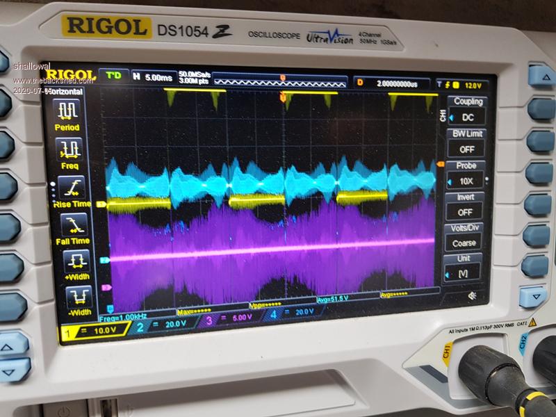

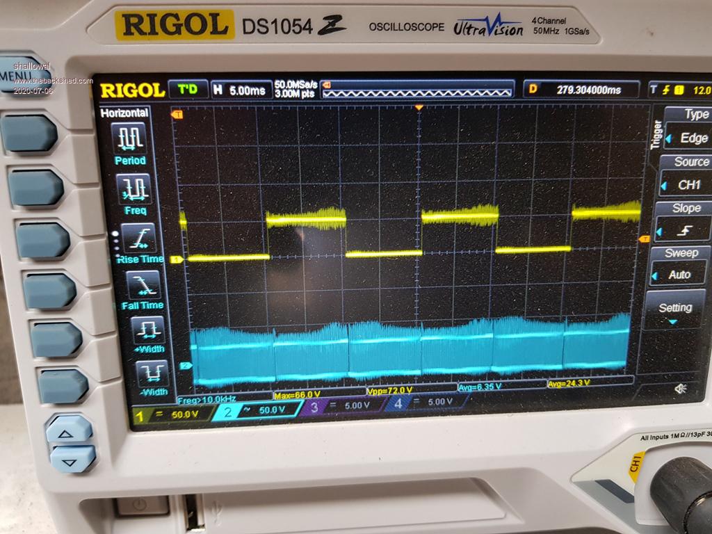

8 FETS installed, unrestrained battery, No Caps, no load.
Unrestrained battery, No Caps, approx 1200 Watts load.
I'm measuring at the output of the voltage feedback transformer.

Trying to interpret what I can see on the SCOPE pictures, the little wobble just below the peak of the wave could be an effect from the load applied and I expect it could be fixed or improved with some adjustment of the choke, air gap or something, not sure what you have there already. I do like the laminated steel cores myself.
If you still only have the 475 polyester film capacitor in place, I wouldn't push any more load on it than that 1200w.
Now the fuzzy beard bit I'm not sure about, Could it be your scope is picking up noise from something?
Also it appears more fuzzy on 1 half cycle than the other, makes me think one leg on the bridge is not working properly, I hope this is not the case.
I assume the 2 high speed diodes uf4007 (CR25 27CR) are ok. Don't know why I'm thinking about them.
I'm no expert this either.
Are the capacitors around the totem pole drivers Ok?

I'm pretty sure the problem is with that 5 volt rail on the EG8010 (purple trace), but now I've blown the EG8010 chip so will have to wait until LCSC ship me the spares I ordered a couple of weeks ago.
