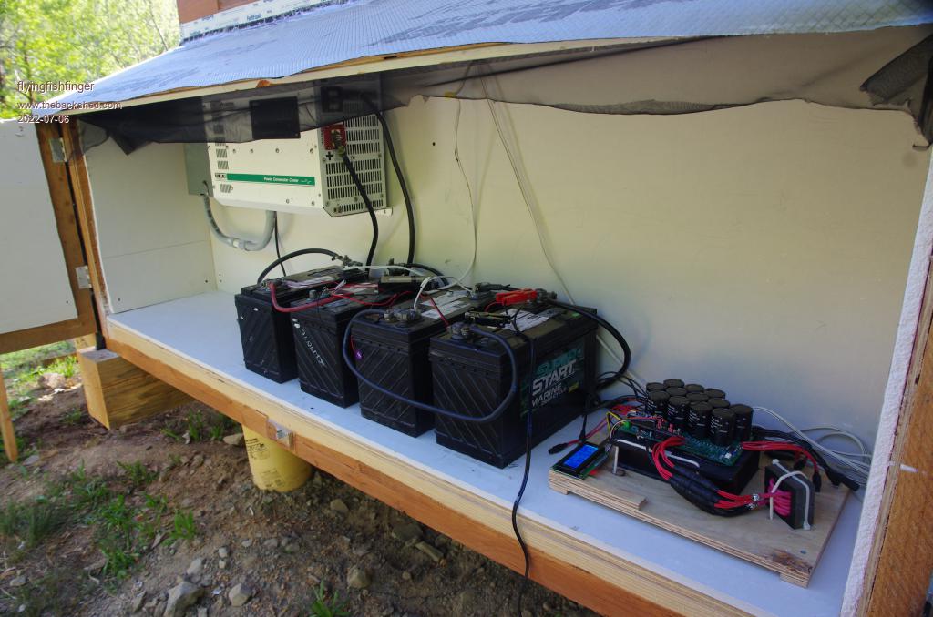

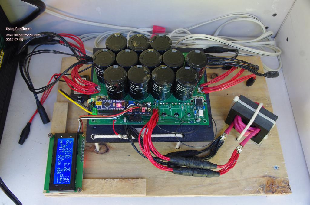

Update to share. I finally installed the MPPT at my site, but didn't have time to wire up all the panels. The net result is that I've only tested it to 800ish W, which works great.
Specific observations:
- At least up to 800W, the I2C communication is very stable, no errors or reboots due to inductor current. I did make a point of routing the negative inductor wire UNDER the PCB by the heatsink so it wouldn't run right past the I2C traces on the PCB
- Referring to my previous post, I changed the code so that the "absorb" mode doesn't use a timer but terminates when the charge current drops to 15W. As far as I understand lead acid charging, ideally one would wait until the absorb current goes more or less to zero, then switch to float but some chargers use a timer, like poida's original code.
- The "zero" current behaves weirdly. The current sensors have a DC offset that is included, so sometimes the current is actually correctly zero. But if the controller is reprogrammed (with the same offset and scaling) or restarted, the current is no longer zero. I am not sure why this happens yet.
I also found that sometimes the current is negative (about -0.1A when disconnected) so overnight my accumulated total kWh actually REDUCES. Added some code to prohibit negative currents, not sure if it works.
- The inductor buzzes once a minute when the PWM is swept. I doubt this is a problem, but it sounds kind of cool.
- My Nanocontroller PCB to mount the Arduino directly on the board seems to work fine. I did bypass the overcurrent detection since right now there aren't any external current sensors. It's also missing a fan control output (oops) which needs to be added to the design unfortunately. I got 5 of them assembled, so maybe I'll just try hacking it in instead.
- My Arduino Nanos appear to be Chinese knockoffs from Amazon. They don't have the full memory range available! The MPPT code takes up 93%+ of code space, but these Nanos crash if that is uploaded. I had to abbreviate basically all the printable strings down to a few characters to hit 92% code space used, then it worked.

You may or may not get to 15W charge. What I have used for many years now is to stay in Absorb until current does not reduce and set that as float trigger.
I would separate your batteries from your electronics, they discharge a little acid mist which will take it's toll. Perhaps put a divider in the middle and batteries to the right and ad a vent fan. I have mine come on when the voltage is above 51.

It did reach 15W eventually, so it works if I wait long enough. Will look into your idea though, it also sounds reasonable.
I do want to add a load dump output to this. My initial thought was to wait until the thing enters float, then switch to the load but absorb takes too long. Time slicing the output would probably work, but it might thrash the transistors pretty heavily. Although, if done once a minute it might be OK. Incidentally, SolarMike recently posted a little board to do just this (DC SSR), saves me a design cycle!
Agreed, the layout isn't ideal yet. I stuffed everything together in a bit of a hurry to make sure everything works, it all needs some tweaking. Perhaps I'll build a "shelf" above the batteries with a fan & duct underneath. The MPPT was meant to hang on the back wall, but my standoffs aren't bolted to the heatsink and the epoxy came loose, so the PCB would be hanging off the MOSFETS - bad idea. Didn't have time to fix it on this trip, so I just laid it down for now.

Well done to get it working with the fake Nanos.
The buzz every minute is normal, that is when it does a
sweep of PWM duty widths looking for max output power.
sadly the current sensing is not perfect so the
small zero offsets remain an irritation.
Good to see you altering the code to suit your needs too.

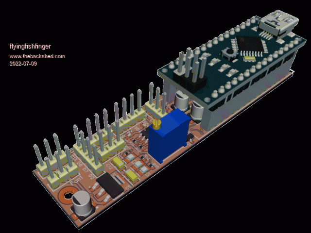

After building the full setup with my Nanocontroller V1 board, I decided to make some updates.
In particular as stated earlier, I forgot connections to drive fans for the heatsink (& inductor). Since most PC fans are 12V, I added two NMOSFETS plus two standard PC fan headers - 3 pin connectors.
It's also always good to have extra GPIO pins, so there's a new header that breaks out 4 of the remaining Nano pins - I specifically want to use one or two of these to control the dump load / water heater SSR later.
Finally there's a "Power" header that provides extra 5V, 12V and GND pins which could be used to power any external boards.
It still looks the same, outline-wise, but it got a bit more stuffed:
This can be almost fully SMTd by JLCPCB, besides the headers which they don't stock.
Happy to share, if anyone wants to try it out!
R
Haha, now I see this. I have just spent the last 3 weeks learning pcb design etc and adding the nano's and all the additional bits to the original board. Only last night I finally reached a stage where I'm ready to say enough is enough and just order some and see if it works.
I would love a copy of your work please, just to compare with what I've done and in case I've missed anything serious. I'll pm you.
Thank you.
Cheers,  Roger

Peter, I have the trim pot on the nano brain board to test with, should it be removed before running the latest mpptv5_BV_tempco, or is it ok to leave it there?
Cheers Aaron

  Revlac said  Peter, I have the trim pot on the nano brain board to test with, should it be removed before running the latest mpptv5_BV_tempco, or is it ok to leave it there?
the trimpot was added to provide a voltage to compare with that output from a current sensor that was put in series with the choke. It was a poorly performing attempt
at a short circuit protection thing.
I think the firmware has a setting that enables or disables this
useless thing.
In the setup menu, please choose "U - fast OC enable " to be OFF
Once you set this to be OFF, it does not matter about the trimpot.
The over current input to work needs to have the pin 2 of a 3 pin header
labelled "out" to be higher in voltage than the trimpot output
and the OC flag = ON to maybe limit output current and not blow up
the 2 FETS should you short the output.
It sort of worked. But testing also had a session when it did not protect things
and I blew both FETs.
I think it best we just don't use this and set it to "OFF"
