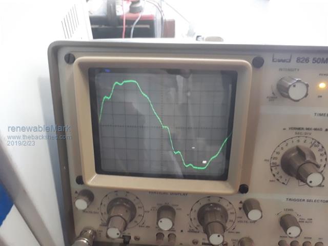

Ran the Ac today and it seemed to be surging, so put the scope on to see what was happening.
PHUK ME!!
This thing is not happy, it previously ran it totally fine. So had to switch the grid back on and pull the unit apart to remove this torroid with the screen.
Cheers Caveman Mark

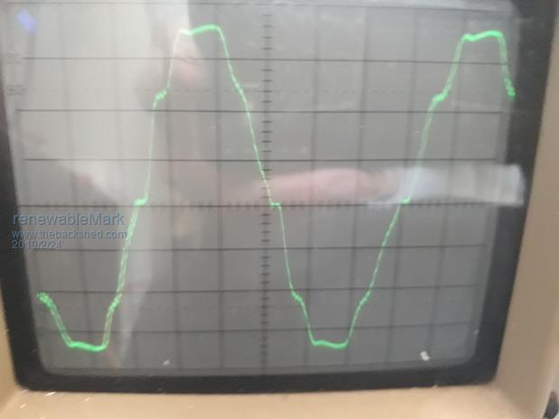

Looking at your CRO trace, there appears to be ~ 500Hz harmonic thing going on in the background. In my opinion it is unlikely to have anything to do with voltage or current feedback.
It looks more like a tuning issue which has more to do with chokes toroids and secondary winding capacitors. Will be interesting to see if it goes away with an un-shielded Toroid I hope it does, but I suspect it may not. Look forward to your next exciting update.....Edited by wiseguy 2019-02-25

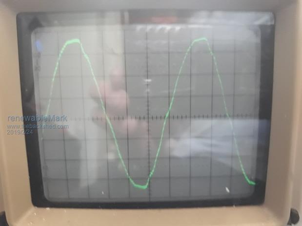

OK unshielded toroid seems to have fixed it.
Voltage is more stable now, lights flick a tad after big fluctuations but not much, it's only the old style filament bulbs that do it.
AC running on full has a nice sine now.
Below pic was the inverter running at 1900watts or so.
But when the Ac isn't of full boar it seems to mess with the sine, below pic was with the inverter running at 1100w
Bit worried it might stuff the AC unit, is it horrible enough to cause damage???
Any other loads like heater, oven etc have nice sine.
It's just the inverter AC unit that messes with it.
