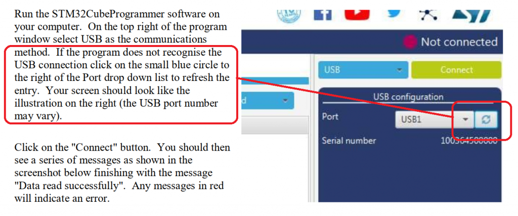

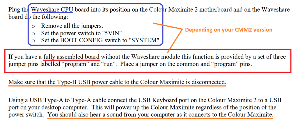

This is covered on page 118 "appendix G" of the manual, and also in the "Construction Guide" but I can tell you are still having difficulties.
  TweakerRay said  Hi ! I bought a usb a a cable so i can connect it to my pc and I tried to run this programmer... but it does not open. I am on Windows 10
Watch the first two minutes of this video only (The rest of it will confuse you).
That shows you (briefly) how to install the STM32CubeProgrammer under Windows10, and how to check which connection method you are using to talk to the CMM2 or Waveshare.
You have not mentioned which version of Windows 10, so I am assuming you are running Win10x64 Home (or Professional).
You obtain the software from here.  You will have to register for a STM account to download and install it.
When installing you may get blue windows UAC warnings because the installer has to install some drivers and java rutime (if not already installed).  This is shown in that video along with how to bypass the warnings and install the required components.
You should install this software before connecting the CMM2 to your windows pc.
  BigMik said  Does the pc make any sound when you plug your USB A-A cable in?
It should..
When you downloaded the STM software did it seem to install correctly?
Ok, so now you have your CMM2 connected to the pc with a known good USB-A to A cable which is plugged into the keyboard socket of the CMM2.  That should be the only connection, no VGA cable, no audo cable, and the jumper and/or switch are set as shown above.
Windows should have made its "usb bing-bong" noise when you plugged in.  If it didn't I would suspect a duff cable, or you have not set the jumpers or switch right
Now open the STM32CubeProgrammer software
We are now on page 119 of the "CMM2 User Guide" ...
IF the STM32CubeProgrammer does not open properly it is not installed correctly.  STOP, unplug the CMM2, reboot your pc, and go and install the software again.  It would be worth checking if you have any other usb devies (joysticks, streamdeck consoles, arduino, mobile phones or other devices) connected to your pc, if so unplug them for now, and try again.  They may contain a similar microcontroller and be confusing windows.

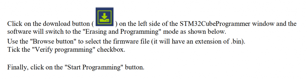

I assume that you have already downloaded a copy of the firmware zip file, and unzipped it to a folder on your pc hard drive.  If not do that NOW.
You will need to tell the STM32CubeProgrammer where to find the firmware .bin file.

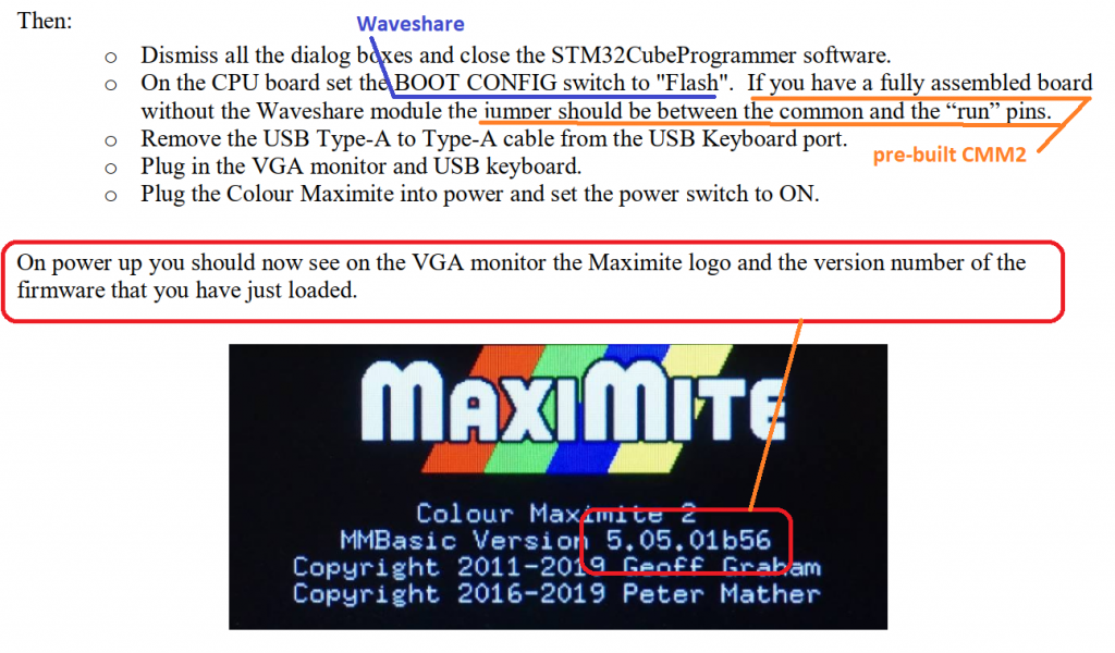

At this point you are pushing the firmware onto the CMM2, it takes short time, you should get two dialog boxes to say the "File download completed" and  "Download verified successfully".  The whole operation will take under a minute and any messages in red in the log area will indicate an error.  If you get an error message in red then check your cabling and try again.
We are now on page 120 of the "CMM2 User Guide" ...
Thats it, you have successfully updated your firmware

I shortly opened the maximte but I am scared to break that ... i saw no jumper and I thought I just need to:
a) plugin a cable
b) run that programmer32 programm and
c) choose the new firmware...
I find this really unconvinient for a beginner... first of all that it does not accept all keyboards? I already setup a raspberry pie with retropie (which seemed easier) and used that same keyboard and it worked just fine...even with a extended cord. why should I now buy another keyboard. I highly doubt that its the led because the signs do work on the US Layout... so why should it not work with DE but with US ?
That doesn't sound logic to me that it's my keyboard now... But okay... Maybe I just simply buy another cheap keyboard O_o but why can't I get a connection to that programmer now ? really frustrating... Thanks anyway. I know its not your fault.
EDIT: I opened that machine up and found that jumper... I made that to Programm and now I got connected... Really this is not beginnerfriendly that I have to open stuff like that and use jumpers for a simple upgrade... it should be much easier...
but what should i complain... I got it working now...   - I try now to upgrade it without breaking it...
Edit 2: Thank you it seemed that now I have upgraded to the new firmware... I will try if it still works now... setting the jumper back where it was and hope now everything is still intact. BTW : The machine has not done any beep... not my pc and not the colormaximite when I have connected it with the usb a cable..
Here is a short Video where I used the colormaximte's voicesynth and writerprogramm for a short Teaser that I have done for a new remix I am working on:
https://youtu.be/Mu8L7aljLKQ
Edit 3: It still works ;-) SO the upgrade to new firmware worked ! Thanks to all your patience and support.
