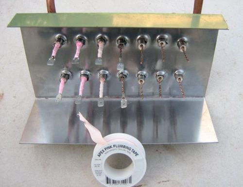

Here the electrical wiring is part way done. A male spade crimp terminal with the plastic bit removed, is crimped to the ends of each wire. It is important to ensure the nichrome wire is also crimped together with the copper securely. I would prefer a ceramic terminal block but they are expensive and hard to find. After fitting terminals Teflon tape is wrapped around the wire between terminal and resistor. The tape is also packed into the end or the resistor 4-6 mm where some of the mineral core material was removed. Teflon tape acts as a insulator for heat and electrical, and support for the wire. This is only built as a demo to show what can be done. The actual wiring method and configuration, is more so left to the end user to choose and construct.

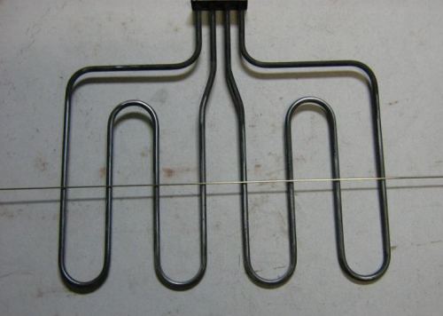

The element above has 2 x 1200 watt (240v) elements in it, and would yield 6 x pre made hoops if cut on the line made by the rod resting on top. At a guess this would give 6 workable resistors of around 5 amp at 29 volts or about 150 watts each.

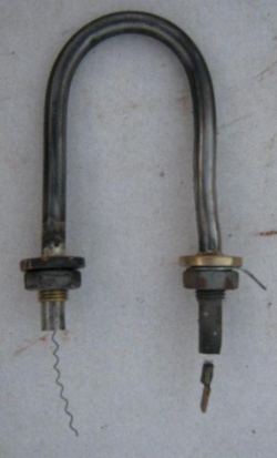

This resistor to the left was made from a submerged element water heater. The mounting end was removed from the original element and reattached with silver solder to a cut down section of element to show it is able to be done.
