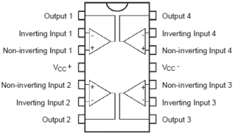

The circuit is based on the TL084 quad op amp. Other OpAmps could be used but this would mean a different veroboard layout and resistor values.

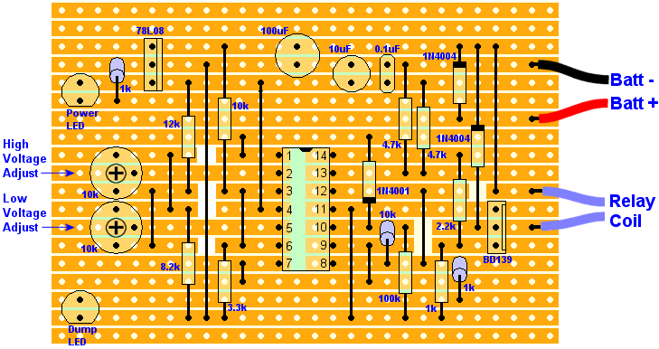

I designed the circuit with the help of CircuitMaker 2000, a circuit simulator. The veroboard was made with Paintshop Pro, and old favourite of mine.
Veroboard Layout.

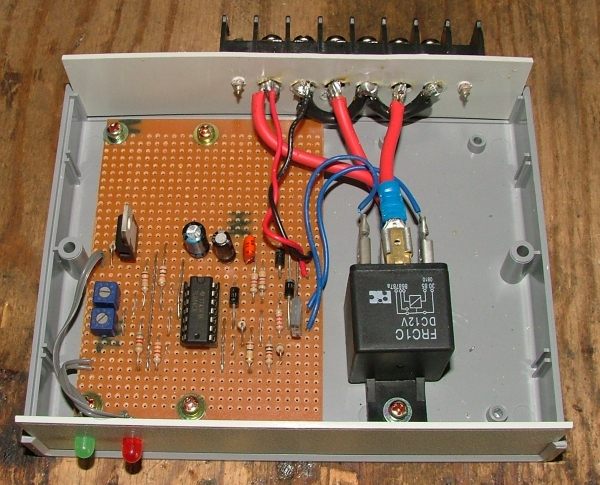

My finished controller.

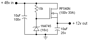

Adding a pre-regulator.
What about higher voltages, like 32 or 48 volts? The 7805 voltage regulator wont handle voltages much over 30 volts, so we need to add a pre-regulator if we want to use voltages over 30 volts on our controller. The circuit shown to the right will regulate higher voltages down to a voltage that's safe to feed into the charge controller. Any N channel power MOSFET will work, so long as its rated voltage is higher than the supply voltage. Choose a zener voltage between 16 and 28 volts, depending on your relays coil voltage, the MOSFET has a gate threshold voltage around 3 to 4 volts, so we subtract this from our zener voltage to get the output voltage. eg, a 16 volt zener will give us a 12v to 13v output, a 28 volt zener will give us about 24 volts. For R1 a 10k to 20k resistor should work, we want to pass a few milliamps throught the zener to keep it regulating. C1 and C2 are to filter the supply voltage and stop any unexepected oscillating on the output. 10uF should be enough. |
An example of a 48v to 12v regulator.
The MOSFET will need a heatsink. The MOSFET in this example is dropping 36 volts. If we are passing 1 amp, then thats 36 watts ( volts x amps ) the MOSFET needs to dissipate. 36 watts is a lot of power for the small metal tab on the MOSFET to radiate, and without a heatsink attached it would burn out within a few seconds. |
![](TL084_Controller/Pre-Reg2.gif) |
On the controller circuit, R1 will need to be connected to the input of this pre-regulator. Also R1 would need to be about 27k for 32 volts and 39k for 48 volts.
Note: I havn't tested these changes, some experimentation may be needed.
Thanks to Warpspeed for the circuit - http://www.thebackshed.com/forum/forum_posts.asp?TID=4732&PN=1
