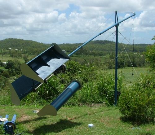

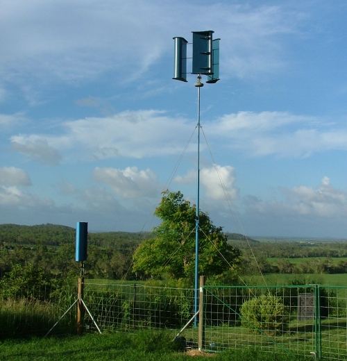

                            | Next I wanted to mount the Lenz2 up on my main windmill mast, the higher the better, more wind and less turbulence. I made an adapter to fit the Lenz2 and a Smartdrive to the top of my tower.  The Lenz2 was a lot heavier than the HAWT windmill, you can see the bow in the tower at its lowered position, even with the straining wire. Once it was winched up in place the tower handled the extra load OK. On average the windmill was making 15 to 20 watts most days, with a few peaks around 40 watts. Remember this is a small windmill, the wind area is only 1.56m2. My HAWT windmill was about 3.8m2 and it was making about 50 to 100 watts average.  What this does show is a HAWT is lighter and uses less materials than a VAWT for the same wind area. If you have clean wind, HAWT's are the better option. |  |
