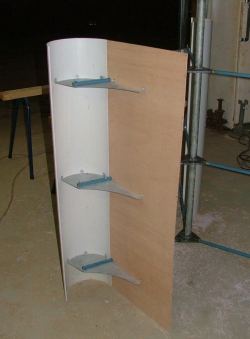

                              Below is my first attempt at a Lenz2. The wings were made from some 90mm PVC pipe slit in half, 3mm ply wood, and some 9mm ply formers. The turbine was mounted onto a 4:1 gearbox from a 4inch angle grinder, and this drove a small AC servo motor. It did work, but needed a lot of wind to get started due to the losses and friction in the gearbox.

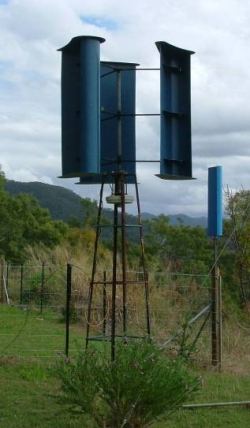

                            I decided to go bigger. I had some 250mm PVC pipe, so basing the design around that size, I constructed three  wings to suit a 1.3m diameter by 1.2m high turbine. The formers were lasercut from 2mm zinc plate, and had elongated spar mounting holes, so I could play around with the wings angle.
                              Below is the finished wings, with winglets to improve efficiency,  |
                            I built a simple 4 legged stand to test the turbine. The alternator of choice for me is a Fisher and Paykel Smartdrive, here you can see the stator mounted.
                                To the left is the finished Lenz2.
                              It performed OK, startup on a standard Smartdrive, which are well know for their resistance to easy startup, was no problem. The only problem I did have was a loud droning noise. See the Smartdrive vibrates as it rotates, and the large wings of the Lenz2 turbine act as loudspeakers, radiating the vibration as noise. It sounded like a motorbike out in the back yard! I swapped the stator for a decogged stator and the noise virtually went away, fixed.
