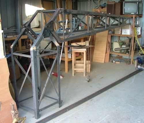

I lasercut the wing formers from 3mm mild steel. |
![](Lenz2/Dscf1094.jpg) |
This is the first wind former fully assembled. The straight lengths are 12.5mm ( half inch ) box section. The dog is there for scale.
The aluminium sheet would be wrapped around this former and pop riveted in place. |

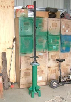

The main bearing assembly. Shaft diameter was 50mm. The bottom of the shaft would connect to a univeral joint and car tail shaft to take the power down the middle of the tower.
![](Lenz2/Dscf1057.jpg)
