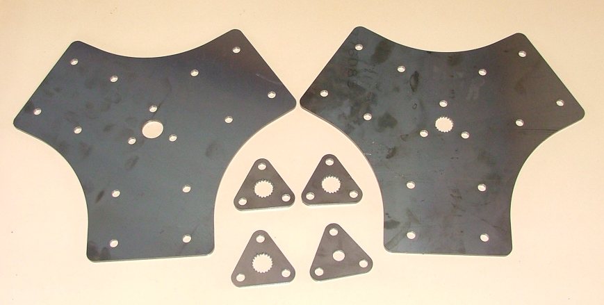

Base Plate Assembly.
- Lasercut 8mm steel ( Grade 250 )
parts.
- Not shown - Hinge tube and shaft.

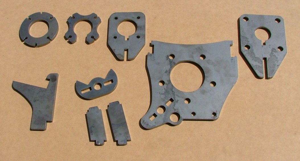

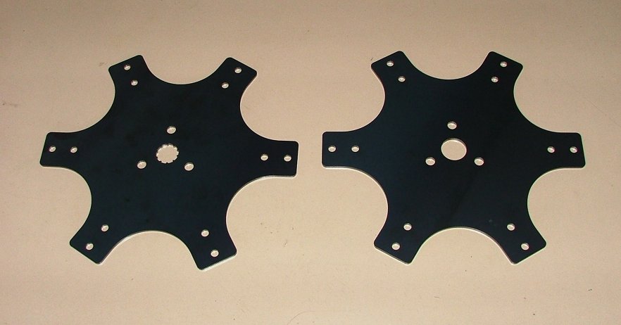

Propeller Hub Assembly to suit a set
of 3 timber blades or 6 plastic blades
- Lasercut 3mm steel ( Grade 250 )
parts.
The kit once included all nuts and bolts,
plus the bearings. But the cost of supplying the kit
was more than I was selling them for, so the current
kit does not include these parts. However these are
easily obtained from you local hardware outlet and bearing
supplier. The assembly manual includes details of all
the nuts, bolts and bearings. I can supply the bearings
is needed for $35. |

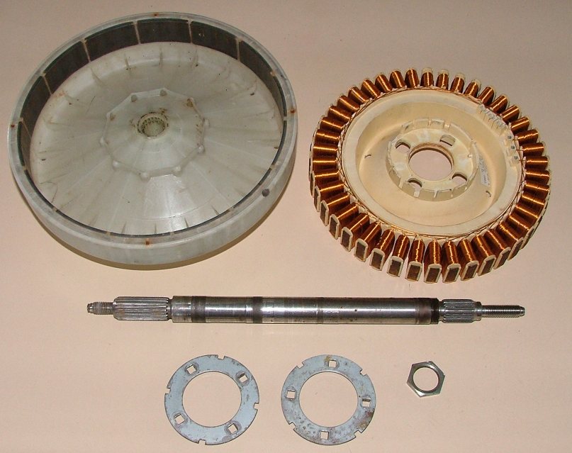

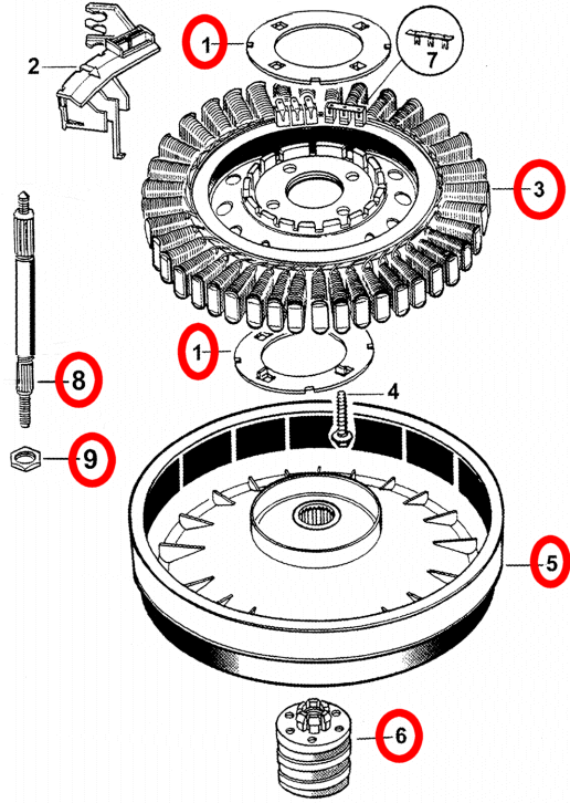

Parts Required
Fisher & Paykel stator, hub, shaft
and retaining plates. These are available from some
electrical repair centers, recycling centers or new
from Fisher & Paykel.
Or you can contact Michael Lawley at
EcoInnovation. He can supply the smartdrive units in
quantity, be sure to check out the EcoInnovation web
site at http://www.ecoinn.co.nz

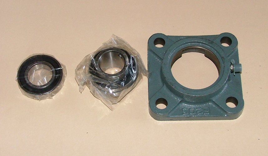

Nuts, bolts and bearings. These are
not included in the kit.
Bearings.
- 6005 sealed bearing ( same
as used in the washing machine)
- 56205 sealed bearing
- F205 bearing carier, to suit
the 56205
