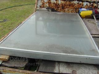

 I pondered this for a while, and in the meantime, a  plumber friend turned up with a few solar hot water panels..... also  25 or more years old..... they were stuffed..... but they did use  tempered glass, and it was iron free glass.... and it was free glass  ( this was the clincher).
  So I sat and looked at a few 2 sq  meter panels (1x2m).......... yep, had to have a go too.... but it  cant be cut!

                            | An oven  that would handle the 2 meter by one meter panes of glass that came  from out of the solar water panels. (it turns out that for some quirk  of history, there are plenty of these old solarhart type panels  laying around over here). |  |

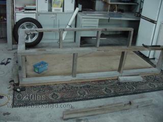

                            | We know that the  temperatures involved are not terribly high in order to achieve the  bonding and cross linking that is required to get the cells to be  protected, and pressed against the glass without any bubbles..... so  I started with a wooden construction..... yes for an oven.
 I  had recently pulled down a wool shed for a fellow, and I was given  the wood.... lots of old 4x2 hardwood.... so this was to be the frame
 It looks like this >>

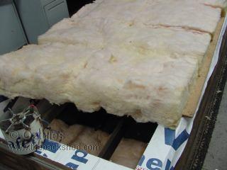

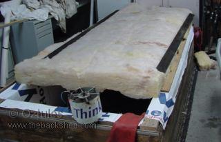

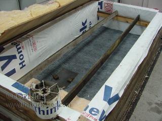

                            | I was also given some  packing material in 8x4 foot sheets of low grade 3/4"  pineboard.(someones kitchen apparently turned up in them). These  would serve for the bottom and lid of the oven. For the sides I just  used some of the old floor boards from the shearing stand.....
 The  whole thing is lined with ceiling roof bats insulation and then all  held in the walls with a sheet of TYVEC building wrap material....  could be anything really.... even paper.
                            | Ok, that gets us the oven  walls and floor, and the lid was just a sheet of the 8x4 pineboard  with insulation laying on the top.... Now we have an insulated  container that will take our panel. |

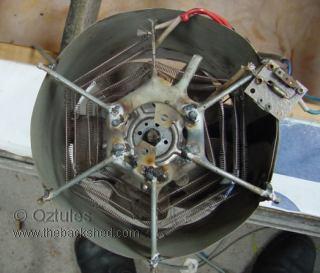

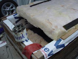

 This was simply solved by destroying a  fan heater/radiator. These things draw about 2000 watts and  incorporate a fan and a nichrome heating coil. They spill out a fair  stream of not too hot air, so are unlikely to melt our plastic bags  (comes later) when we bring the oven up to temperature.

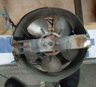

 I  built the heater body out of a "think safety" sign (ironic  really), which housed the heating element at one end, and the fan  motor at the other. The fan blades were plastic, and would melt in  this environment (proximity to the glowing element), so I stole the  aluminium blades from my big MIG welder, and put the plastic ones  back in that.
 This gives us a 2000w heater that blows warm  air..... but not too hot,and will allow us to gently heat the oven up  to about 100-120 degrees, without any cunning trickery required to  temp control it. Because the oven is so well insulated...... we just  keep adding watts from the heater until we get to where we  want.
 Finished it looks like this:
                            | Perhaps finished was too  strong a word to use...... but it does work. |  |
