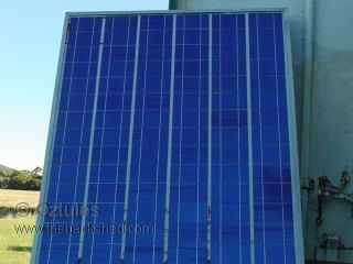

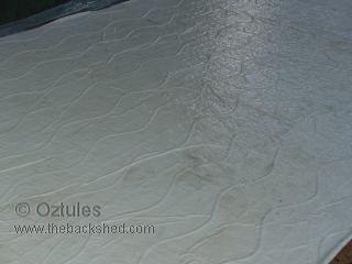

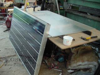

 Later I turned the sheet  over ...... with mixed results. The logo writing wrecks the visual  impact because of the blue and red .... oh well too smart too  late.

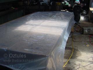

 Now the next part is critical to success..... yes the  plastic bag and wicking material

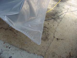

 2.5m x 1.5m plastic bags  don't grow on trees over here, so we need to build our own easily and  quickly.... and it MUST be airtight.
 I did have a roll of  plastic sheet donated from a farmer. It was 2m wide and a million  meters long.... (hot house plastic I think it was designed for) so I  cut off 2x 2.5M bits of it and laid them  on the table one on top of  the other.... Now we just need to seam them. We can use a straight  edge.... for no other reason than to limit the heat damage we are  about to do.
                        | Place the straight edge about 1" in from the  edge of the 2 pieces of plastic laying on the table. Grab a heat gun,  and heat the plastic edge, running up and down the straight edge  quite quickly. The plastic will start to melt in that 1" zone.  Move the straight edge onto the 1" melted zone, and it will cool  it rapidly, and seal that zone..... like this: |  |
                        | We then end up with a huge  plastic bag, with very little effort. We can seal the open end after  we place the cell inside of it.

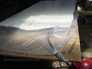

 Here is my plastic bag:

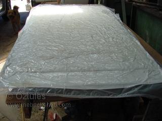

                        | Last time I used shade cloth  for the air wick material, this time I found an old dooner, which  will allow for reasonably free air movement. This is key to no  bubbles... as well as no leaks in the bag. Shade cloth shrinks with  the heat and distorts the cell layout, the dooner did not... avoid  shade cloth is the moral here.
 Bagged up, and the vacuum  starting to take up the slack, we get to this:

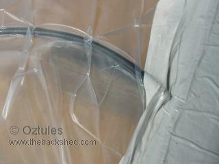

                        | We can see how I have sealed  the end of the bag now, and placed the vacuum hose into the dooner  cloth. NOT on the cells themselves....... yep, it's all starting to  happen about now. |  |
                        | and nearing vacuum  condition, the dooner is now flat as a pancake:

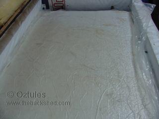

 NOTE WELL: the weather  was hot, and the cells small, so this did not crack the cells. If it  is cool, or the cells big, or your tabbing is less than flat..... do  this stuff in the oven after heating it up to about 50C..... not just  the air to 50C, but the glass..... slow is good. I put the temp probe  against the glass (underside between the glass and the rails holding  the glass up in the oven) |  |
                        | Here is a close up of the  hose going into the cloth:
                        | Now we have to manoeuvre it  into the oven   The whole lot was under  vacuum for about 15 mins before I started the heater. It slowly  climbed up to 105 degrees or so, and so I ran it for 70 mins...  better more than less, or glass adhesion may not be complete.... and  thats it.

 Before it  gets too cool, it is wise to get it out onto the table and undress  it.... the EVA runs where ever it can, and some may stick to things  you don't want it to stick to (the dooner for one)... so rip off the  plastic bag and free the dooner as soon as practical. The eva will  still be a bit soft at this stage... be careful, as you can upset the  glass adhesion if your not careful at this point... and you can  remove some from the edge or whatever. When it cools and the curing  is finished....  It is tough stuff, and if cured will have stuck to  anything within reach

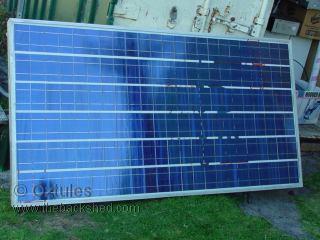

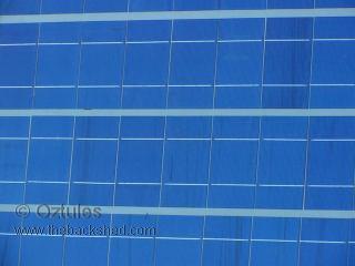

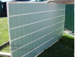

 So now we have our panel and it  looks like this
                        | and this |  |
                        | Up close like this: |  |

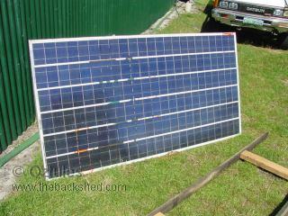

                        | When placed back into it's  frame/jacket it's like this.... fairly respectable really |  |
                        | and the rear like this. |  |
                        | It really is a big panel,  and I don't think there is much point going bigger. This one does  about 250 watts. It's max power V is at 34.5v, and max power I is at  7.5A
 Short circuit current is at 8.3A and open circuit voltage is  40.5.
 It will be used as a water pumping panel with V set at  32v and current whatever it can do according to the sun... hopefully  lots of 7.5A would be good. This will derate it to about  240W
                        | Yes I know the tyvek writing  makes it look bad, but apart from that it is a very successful  panel.
 I hope this inspires some folks to have a go now that  there is a way to mimic the big boys without the  fuss.
