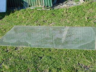

 In this case we will be  using the iron free solar glass from a disused solar hot water panel.  It is toughened, and the iron free...... this means when you should  get 1.8w per cell you will. If you use window glass, then it will be  less, but work anyway.
 So we get the glass and wash it in  water and dry thoroughly. Then wash the cell side with methylated  spirits and dry. My glass has prisms on one side and flat on the  other.... like frosted shower glass almost.... I have tried bot the  rough side and the smooth side to put the cells on..... I think I  prefer the smooth side and get a rough outside..... slightly better  when the light is diffuse....... however, in latitudes where the  panels are flatter, then cleaning becomes a problem where the dust  settles in the rough valleys.... so in those latitudes, perhaps put  the cells on the rough side with the smooth side to the sun.... your  choice really.
                            | My  glass looked like this: I won't attempt to detail  the cell joining process as it is just soldering cells together, and  this too, is covered well elsewhere. Suffice to say, keep as much  room between cells as your design and glass size can afford... I like  1/4 inch, but rarely get that luxury. In this case I need 23 cells in  a single string to fit in the glass with an inch left at each end.  This dictates very close spacing between cells, and can lead to  shorts if not careful. |  |

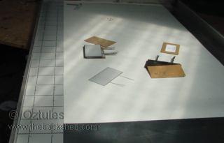

                            | I also use the solar hot water case as  a straight edge to build the string in. I use transformer paper on  top of the aluminium (to stop the Al draining the heat from the cell  too fast when soldering), and use the side of the case as the  straight edge. This way guarantees that the cells don't wander about  the place. It looks like this:

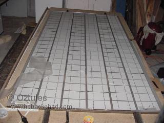

                            | We then carefully (very)  pick it up and transfer it to the glass sheet which has the EVA cut  to size on it I use some untabbed cells to get the spacial  arrangement to make it look symmetrical …...not very well really,  but I did try a little bit.
                            | We keep labouring away until  we fill the glass up with cell strings. We then need to place the bus  lines in to join the strings. There was not a lot of room to do this  here, so I actually placed the output tabs on top of the last cells  in the string in some places. I use transformer paper to effect the  isolation needed, and EVA strips between any surfaces, so that the  whole lot will melt together later. It may be seen  here: |  |
                            | From a "looks"  point of view, it is more important to get the strings straight, and  the gap between strings even. The inter cell gaps in a single string  seem to have little impact visually compared to these other two  requirements. I see a lot of youtube folks with tile spacers to try  to get it right, and they still fail miserably.... so just keep the  lines straight, and even between strings and it will look ok. .... I  think anyway.

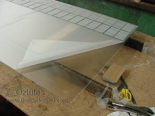

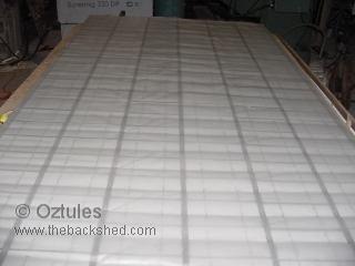

 Then it's time to place your second sheet of EVA  on the pile. Hopefully you remember to cut it before we get to this  point.... unlike me.

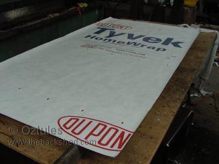

                            | Then it's time for the  backing material (building wrap this time for me, later I will use  plastic sheet (ran out of the white stuff), and whatever else for  you).
