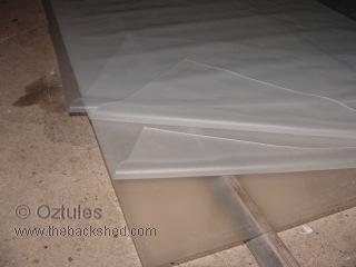

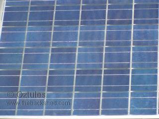

 Lets not loose sight of  what we are trying to achieve..... we want power and we want it  cheap. If we have to buy too much exotic stuff, we may as well by  commercial panels as the cost spirals away very quickly.
 The  output difference will have more to do with the quality of your cells  (when you sort them out) than the quality of the glass substrate. My  tests showed that a 10-15% loss would result in using  normal window  glass... Now if one is free (say window for instance) and available,  then it beats the bonox out of buying glass that may give you less  improvement than buying and sorting the cells properly.
 If you  bang the cells in without sorting you may degrade performance of a  panel by more than 30%....... and waste the better iron free  glass.
 So, even without the iron free glass, we can make  panels within 10-15% of a commercial variant, and there will probably  be a no-cost component for the window glass. With the money not spent  on exotic glass we can probably build another panel, and have 170%  more power for the same money.... even using very ordinary  glass......
 Glass thickness is also a  factor with transmission loss, and the thicker the glass the worse  things get..... but again this needs to be balanced out with  advantages of strength and availability. The latter is the killer  over here. It is just our Government in their wisdom are virtually  paying folks to ditch their solar hot water for the new  complex heat  pump things . So there are lots of 25 year old panels (and younger  too) just there for the taking....with the aluminum back as well.
 It  is of course up to you as to your final cost per watt... but this can  be can be very low if you don't try to use all perfect stuff....

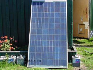

 Waffle and some more  pictures of panels:

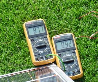

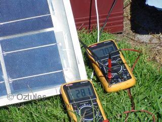

                            | As I had the meter out, I decided to check  the latest panel again for short circuit current ....  Just to make sure the  meter was pretty close to right  I used 2 amp meters in series as a  rough cross check.
 There was a difference, but not enough to  excite me unnecessarily...... here they are:
                            | They are a bit better than  the other day, which was a bit hazy ( big winds seem to get a hazy  look to an other wise clear day in the ocean environment)
 In  this setup. You can see by the shadows, that this was not the noon  sun by any means. I did see a few moments of over 9Amps, but this was  caused by small clouds near the sun I think.

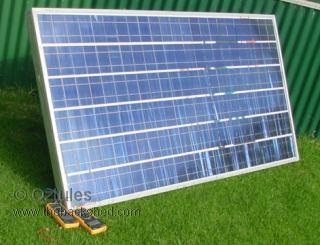

 |  |  CELLS: The strangest  things happen with new cells. I built a quick and rough cell tester  from a 150w flood light etc etc. I sorted the cells, and was  disappointed that there were so many less than good ones.... ie  2.0-2.8A cells.... a good amp less than the "normal" 3.8 +  ones. Now putting 2A ones in series with 4A ones gives you a 2A  panel... bummer... so thats why we test them. We want to see mostly  full power panels, and all the duds in a feeble panel.... not  mixed.
 The odd thing is, when taken outside into the real sun,  strange things happen. Most all of the 2A+ cells came up to 3.4-3.9A  The really good ones didn't change at all, the reasonable ones  improved a bit.......... but the baddies mostly came up to spec or  close. There are still some that didn't, and will be made into window  glass electric fence panels.....
 So now I always test the  cells in true sunlight.... twice..... lab conditions does not seem to  tell the real story..... I don't understand this at all.
 BIGGER CELLS: For the panels built  with the 6x6 cells, and they are fantastic to work with, and perform  very very well.I have seen well over 9A short circuit.
