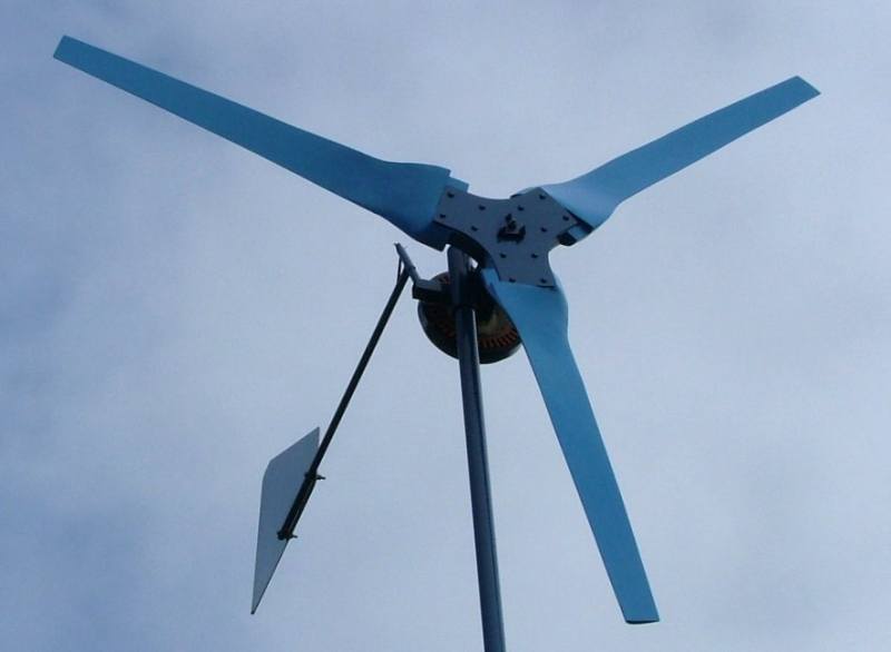

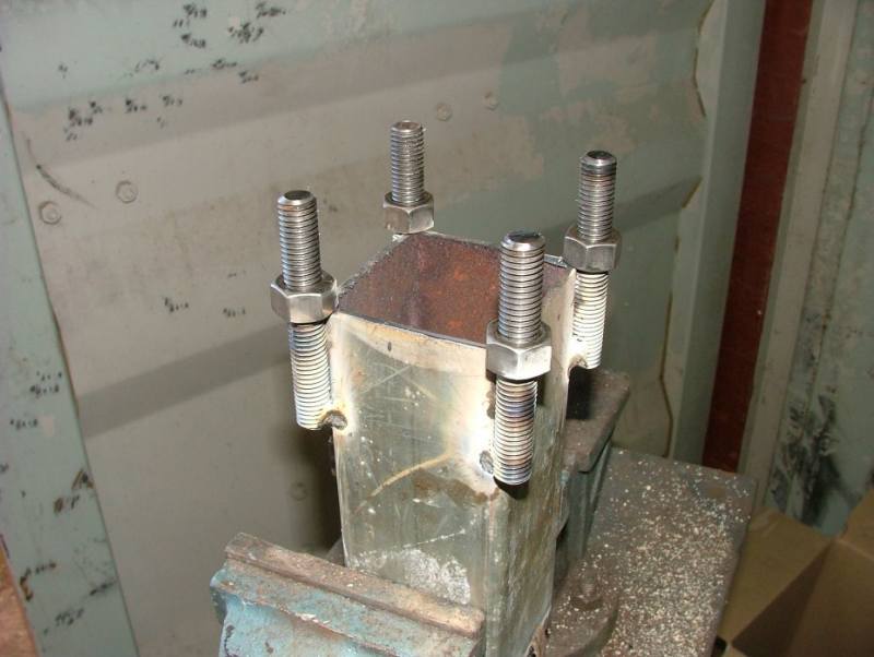

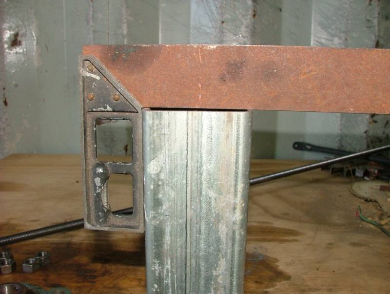

This new windmill for the
F&P motor was designed to be easy to build, and unlike my previous design, needs
no special laser cut parts. You should be able to put it together
with some basic metal working tools and a welder. The following pages dont include details on buiding the turbine, rewiring the Smartdrive or connecting it to your system.

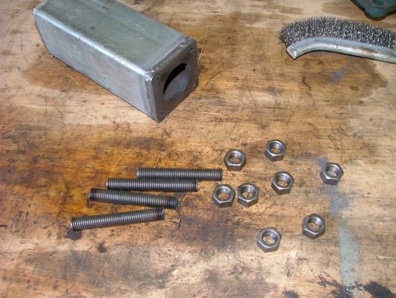

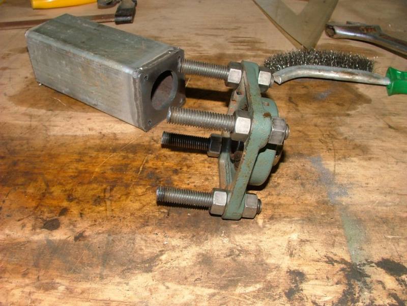

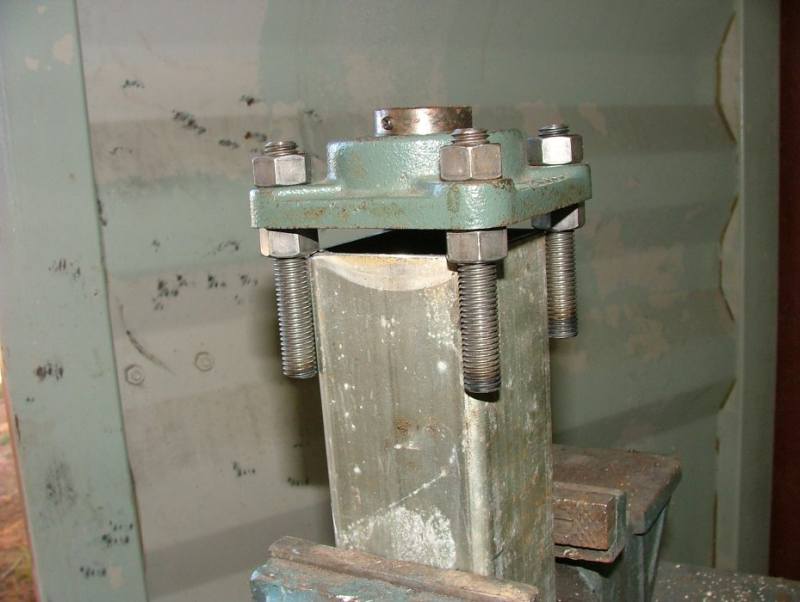

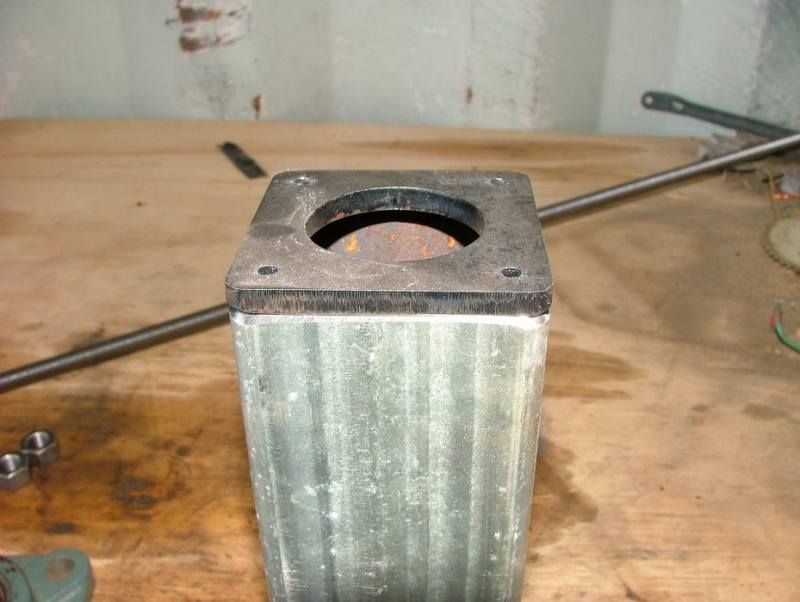

You will need....

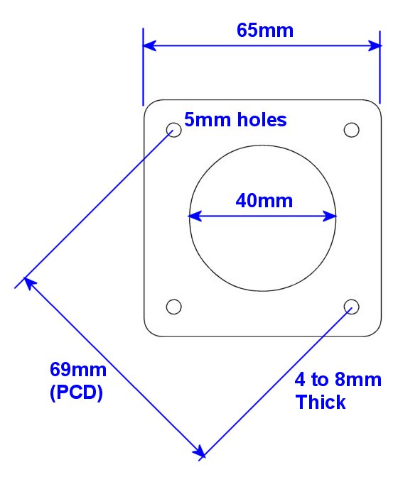

- 65mm Box Section, 165mm long.
- 40mm Box Section, 140mm long.
- 4 to 8mm plate, 65mm square.
- 8mm plate, 86mm round
- 50mm id tube, 200mm long
- 48mm od tube, Mast length.
- 16mm rod, 220mm long
- 22mm od 16mmid tube, 1500mm
- 56205 bearing and F205 carrier
- 6005 bearing
- 300mm of 12mm allthread.
- 8 12mm nuts to suit
- Four 6mm bolts, 25mm long.
- Tap to suit.
