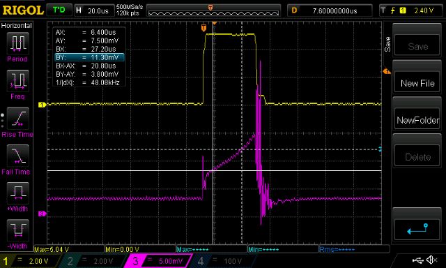

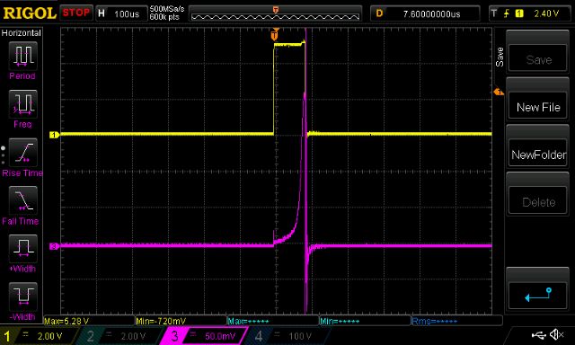

I built an inductor tester, similar to what is shown here:
http://ludens.cl/Electron/lmeter/lmeter.html
but instead using an Arduino to create the short duty cycle pulses.
My current shunt is a 2 cm length of copper wire.
It's simple to derive the inductance, just use the simple formula
L (inductance) = (Time x supply volts)/(rise in Amps)
Yellow trace is gate drive for the mosfet.
From the above we see time = 20.8us, supply is 10V from the bench PS and amps is the millivolts of the purple trace / 1.82
Using this tester of mine, I calculate the inductance as
(20.8e6seconds * 10V)/(3.8/1.82) = 99uH
Not bad for a rough test.
Increasing the pulse width increases the current flowing through the inductor.
I see that the E core inductor saturates very easily at about 5 to 6 Amps.
Higher purple curve slopes mean lower inductance and the sudden increase in slope is where saturation has begun. This test has subjected the inductor to about 110 Amps at the peak of the purple curve (200mv/1.82 = about 110 Amps)
We all know the current flowing in the primary windings of our inverters is usually much greater than 5A so that means this E core inductor is operating mainly under saturation. Instead of the inductor having a value of 94uH is has something far less, I estimate it is close to 3uH when the current is 40A.
3uH may as well be a 2 foot piece of wire...

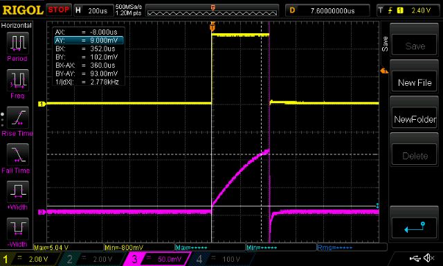

The ex-aerosharp choke behaves much better. It maintains it's 50uH up to 50Amps.
360us, 10V, (93mV/1.82)Amps means about 70uH

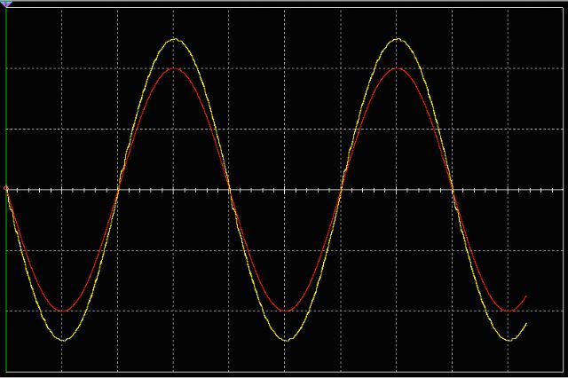

I have my inverter test code runnning on a Due and wanted to get it to sync to an external input. For testing, the input will be a square wave, to gently introduce me to the ugly concepts of phase and frequency feedback loops. The Due is about 4-10x faster in most things and it has a huge data + program memory.
After a few hours I have a PLL working quite nicely, and you can see it in the below video
https://youtu.be/F_hK1rfKssE
What to look for is the frequency of the input, shown at top right.
The yellow trace is input, the blue is low pass filtered 20KHz PWM output of the inverter program.
Note how it can track and lock onto the small changes I make to the input signal.
This was scary easy to hack up a quick feasibility test.

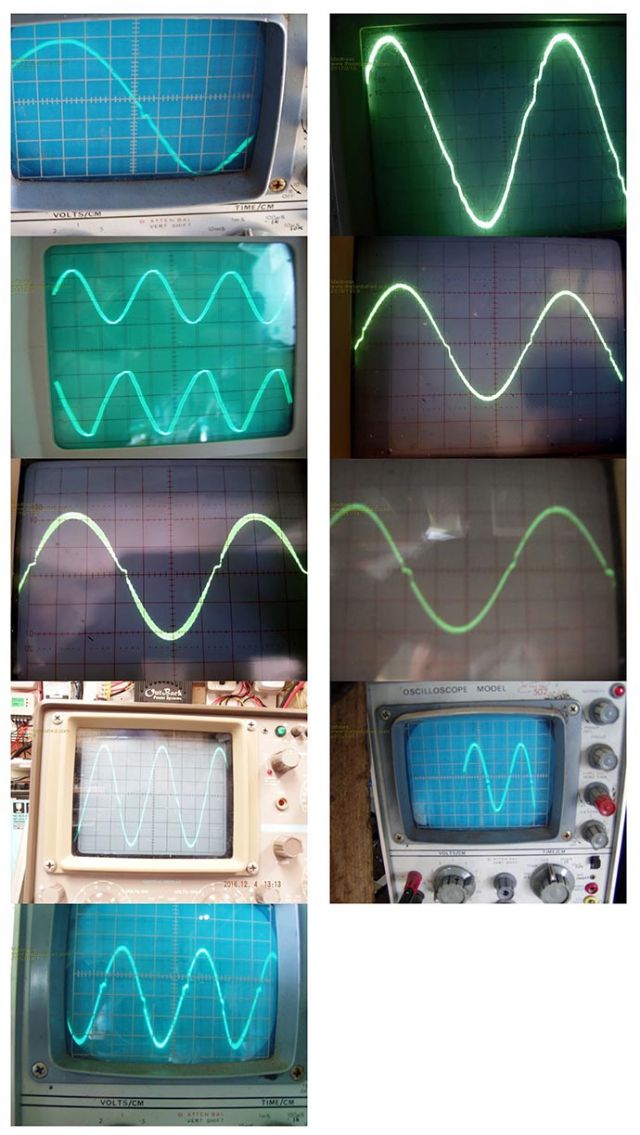

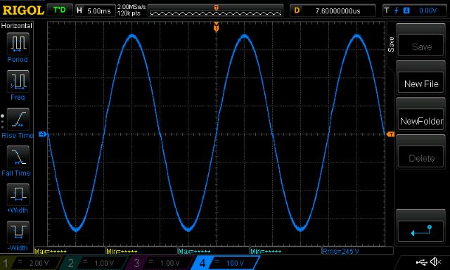

Part 3: Output waveform wiggles
We all must have seen the AC output wiggles and wondered where it comes from.
These wiggles take different forms depending on the builder and his choice of transformer primary windings, AC output capacitors and inductors. Other factors can effect this too.
It's important for this discussion to accept that the circuit we have in our inverters is
an LC tank that resonates when given any reason to do so. It has some dampening which permits out inverters to function fine (or not). It's actually a LCR series thing but it behaves like an LC tank.
The circuit is driven by the mosfet bridge, then one wire has an inductor in series, then the primary winding (with additional inductance) then back to the other bridge output. There is a capacitor connected in parallel with one or more inductances.
There is some series resistance from the primary winding wire, primary inductor wire etc.
This helps dampen the oscillations.
I think I have found the cause of these wobbles in the AC output waveform.

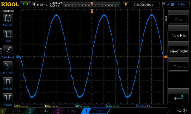

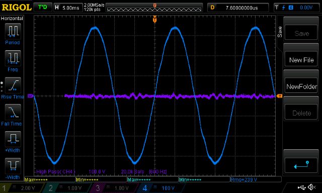

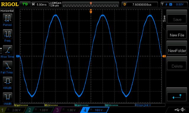

First some examples of mine:
13 turns on the Aerosharp output choke (not very large but they ARE there.)
8 turns of thicker wire on same choke (still there..)
3 1/2 turns on a TDK E core "E 65/32/27" as used by Oztules and others.
I wonder why it is asymmetrical?
In all cases you can see wiggles in the sine wave immediately as it passes zero.
These wiggles reduce to nothing about at the top or bottom of the waveform.
My oscilloscope can perform math on a waveform, so I show a high pass filtered trace (purple) of the output AC alongside the original AC waveform. High pass filter removes the 50Hz part of the waveform.
We need to shift the filtered trace leftwards about 1 division to line up with the source. Notice there is some oscillation that is damped and dies out after a few cycles.
We all have had this to some degree. Sometimes the oscillations are damped out really quickly and so we see just a step up/down as the AC output passes zero.
(let's play spot my CRO trace...)
Anyway, all that is just my view.

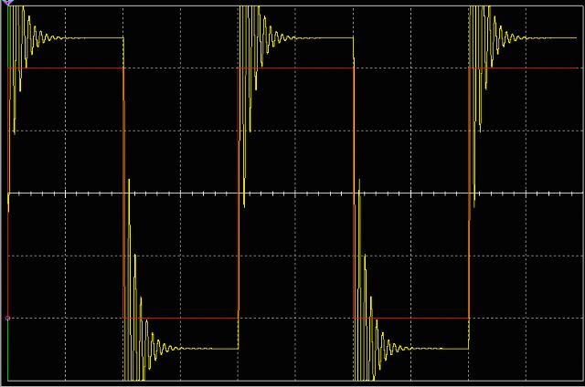

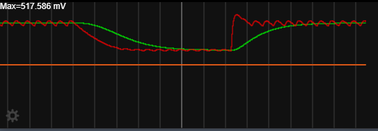

I modeled a PWM sinewave driving the same LC tank circuit and you would not believe what I saw.
If you have access to Multisim v.11 you can download the circuit below.
Here is the PWM output alongside the sinewave that is modulating the PWM.
Red is sinewave modulation for PWM, yellow is LC filtered PWM output which is supposed to represent the AC output waveform from an inverter.
You can clearly see the wiggles appear after each zero crossing. They die out after a few wobbles.
The simulation lets me modulate the PWM with any waveform.
I tried a square wave.
When I saw this, I finally understood the consequences of connecting an LC tank circuit to the output of the mosfet bridge.
It will oscillate, the only question is how much damping there will be, how strongly the oscillations will be excited and the amplitude and frequency.
The simulation employs a 20KHz PWM, output into a 130uH and 50uF LC tank.
These values are close to the sort of values we use in our inverters.
The simple "step" immediately after each zero crossing can be seen in some people's devices. This is an oscillation, but it is a highly damped one. It dies out after 1 half cycle or so.
It's cause is the same, only it's effected by different L,C and R parameters.
So, that's that. The mystery to my mind is solved.
It's something we live with if we want to run the inverter at the bleeding edge of efficiency with massive primary windings, little primary inductance and a decent AC output capacitor. It will oscillate and that's that.
Some people think these steps and oscillations are due to imperfect PWM modulation by the EG8010 around the zero crossing. At the time a little before, during and a little after the zero crossing, the PWM must be off completely to deliver zero volts to the primary. Then the first pulse of PWM that is trying to generate a small increase in voltage (from zero) is seen by the tank circuit as a highly energetic single and short squarewave. This makes the circuit ring like a bell.
I do not think these wigggles are the direct result of insufficently correct PWM.
It's what you get from hitting a LC tank with a hammer.
I look forward to any discussion on this topic.
2017-03-10_110432_bipolar_SPWM_shows_oscillation.ms11.zip Edited by poida 2017-03-11

In my case I don't get these wiggles with a few FET's when I have 4 and upwards the wiggles turn into spikes.
I hope you are able to get the bottom of it, I am running out of ideas and enthusiasm.Edited by Madness 2017-03-11
Posted: 11:40am 10 Mar 2017
Well done Poida.
It seems the transformer, and the components immediately around the transformer can have multiple resonances with various amounts of coupling and damping, also influenced by the nature of any inverter output load.
Its all a bit of a dog's breakfast and very difficult to analyse.
Adding our primary snubber inductor will also influence all of that as we already know.
Looking at the awful waveforms coming straight off the grid, I would not lose any sleep over a few low amplitude wiggles.

Poida's insights are truly amazing revelations.....good work.
There are a few twists and turns to be unravelled too.
Sometimes the 8010 will change load requirements instantly, but the transformer noise changes very slowly. It may go silent and be pulling 6kw, then after a few seconds of "catching up with requirements, and running steady at the new power level", the wobbles can come back in, and the transformer changes sound, from silent to quiet running.
It would be nice to have the silent running part all the time.
Different transformers have different sounds, and that may be explained now by the resonances.
Is it possible the 4 fets no wobbles, and 6 fet wobbles is because the impedance presented by more fets is lower, and the resonant frequency changes from out of range to in range perhaps.
Mad, have you run the new drivers yet to see if they stop the wobbles? If they make no difference, then Poida is probably spot on the money.

Oz: I agree - when changing the no. of fets the series resistance changes (when ON) and so the tank will behave differently with more or less damping.
I have my prototype inverter (i.e. arduino driven one) running with the 3.5 turns in the E core. IT starts up up fine and runs fine. The strange thing is it takes about 1 second after full voltage to be reached and PID in control for a strange, asymetrical wiggle appear in output AC. Extra transformer noise appears too. It seems to me that something is not quite resonant but waiting for the needed excitation to arrive, then it resonates. I can make the transformer make louder noises when I increase AC output setpoint, and when I reduce setpoint, no noise in transition, but after a few seconds, it returns. This also is present in the EG8010 controlled aliexpress inverter boardbut a little less. The E core does strange things when wound with thick wire to my test systems.
Thanks for all your comments.
